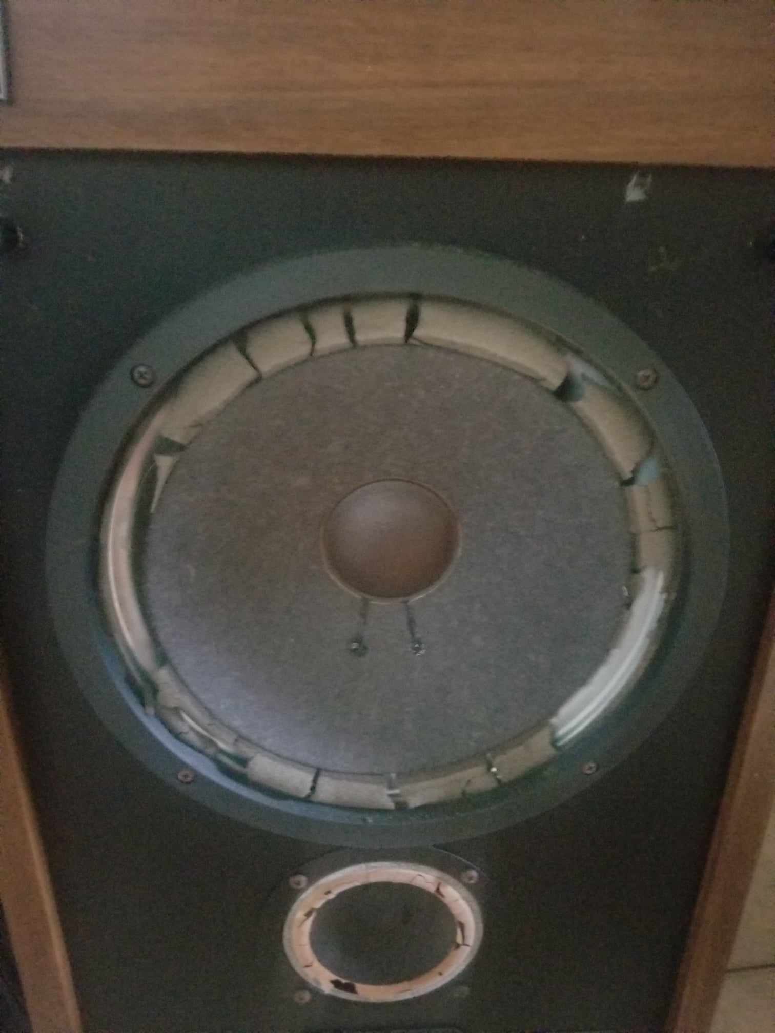

Hello someone got us a yamaha A-S801 amp for a wedding gift !!!!
I am a musician but dont know much about HIFI...
also someone just gave me a pair of old AR48s in really rough condition... for sure the foam needs to be change and the paper cone looks weird too.
what options should I go with considering i have a really good amp but we want good/?vintage? looking speakers. The Acoustic in the living is bad... echo... should I might try to make it better with those stuffs you put on the walls? that doesnt just look like foam?
1# replace foam and(or not) the paper cone
2# replace the whole woofers to put better quality ones? and if that please give me recommandations.
3# get a new set of vintage speakers? should I get a subwoofer too?
thank you very much !

you certainly have to change the filter caps (cause aging) too but if it was done in between. Maybe the tweeter has some Ferrofluid in the gap or not. If yes with 40 years, it must be cleaned and swapped.
A not bad speaker having such a look is the Whaferdale Linton Heritage. Excellent Q/P in Europe but I do not know after a boat trip.
I would not buy vintage speakers without a guarantee that all the drivers were working.
The ARs look to be a bad investment for someone who has not previously renovated loudspeakers.
I would avoid them.
If you are into the vintage look, there are some manufacturers who try to emulate it in modern, reliable designs - and you could look in that direction.

If I had AR48, I would rebuild them. The finish should be wood veneer, appropriate for a home. The replacement woofers from simply speakers look like a good option for an inexperienced hobbyiest. A few screws removed & replaced, flag terminals pulled off or maybe two solder joints. Wear safety glasses when using solder, it splashes. Maybe some electrolytic caps in the crossover replaced, they are sealed with rubber which deteriorates & leaks eventually.
