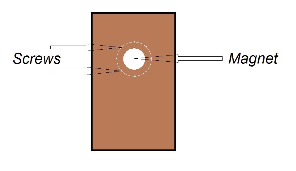

The pic is a center baffle/brace. Access through a port or terminal plate would be needed for this idea. The magnet cutout should be a bit too big. Allowing the driver to compress it's front gasket system to no specific size. The magnet will find where it wants to be in the cutout. Then comes the quite permanent sealant applied through the terminal plate. Shims if you like. This sort of solid gluing solution, once all is in place should mean nothing is being pulled on, pushed on, or left to move about. The twist to this story, is the driver can still be removed. It's basically been glued into a ring, and the ring can be unscrewed, and come out with the driver.
Really low precision needed. The ring can be done with a jigsaw. The kerf being missing, doesn't really matter. The screws need it.
If it was removed and replaced, the screws would need going back the same, to avoid unwanted leverage. Or bust the glue off, and maybe even make a new ring. Making the use of hole saws a consideration, to repeat manufacture easily.

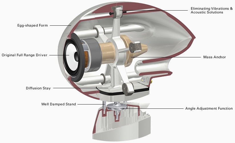

The only time i can see decoupling the baffle is in things like the Fujitsu-10 Eclipses — were the driver is either acnchored to a heavy base, or looks like an elaborate absorber system — the OBs where the drivers are mounted on a verticle rear structure.
