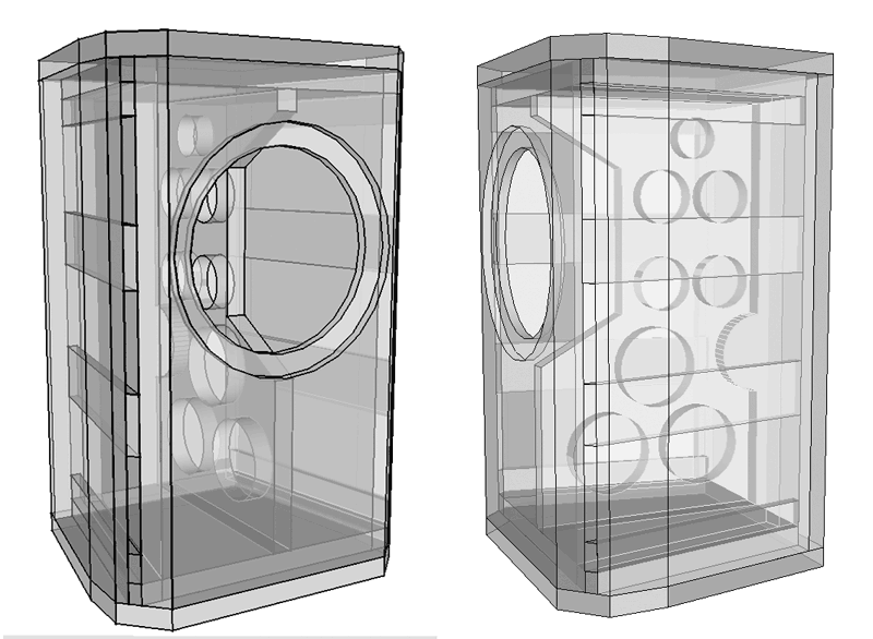

Should the back of the bass driver(s) rest firmly on the internal bracing of the cabinet?
Are there any pros and cons of that in general and in my case?
In may case (slim 3-way) there are two stiff 5.5in high-excursion drives, on the same baffle (not opposing push-push). I have the option of placing some of the internal bracing on the back of the bass drivers. The drivers are 4kg each. The front baffle is 31mm, side walls 21mm, back wall 31mm. Heavy cabinet.

The primary use of internal cabinet bracing is to stiffen panels, reducing their vibrations which may "color" the sound when in or out of phase with driver output.
A driver resting firmly on internal bracing would tend to transmit it's mechanical motion to the exterior panels, generally not a desirable outcome.

As a launching pad, the woofer motor (eg magnet) should connect with the centre of mass of the cabinet. In that respect you should ensure the cabinet is brought together at that brace as though it were an Earth (ground) point.
On the other hand, should doesn't always mean must. An awareness of things that would be audible problems is what tends to drive cabinet construction. Sound is transmitted through mechanical contact, so research soft mounting methods and ways to damp panels.

I am a firm believer in bracing to the enclosure.
Shares the reactive force of the basket with the back (and top & bottom) instead of the baffle dealing with it all. Makes the driver a part of an i-beam structure instead of sitting in the “middle” of a “floppy" baffle. The reactive force force now loads directly into more material, reducing the likelihood of exciting potential box resonances. A side benefit is often increased DDR — especially in wide range drivers.

That statement in general isn’t true. Mechanical motion/forces of the driver must end up somewhere and the baffle is more not than often the best place for that…A driver resting firmly on internal bracing would tend to transmit it's mechanical motion to the exterior panels, generally not a desirable outcome.
So, looks like, in general, the driver needs to be fixed onto a structure (a given) and the heavier that structure the better - how heavy and damped is that structure is the primary consideration (assuming the connection is made well). The heavier the better and the better damped the better.
Then, the secondary consideration is how exactly that 'resting' is achieved - via the baffle, via the back of the driver or a combination of both (again, assuming the connection is made well).
This means that in my case:
The mid driver will only rest on the front baffle - as it is heavy enough and damped enough.
The two bass drivers would benefit from being connected to both the baffle and the cabinet. As the cabinet is relatively heavy compared to the driver (and the baffle not enough) and that connection is not far from the cabinet center of mass. The connection to bracing needs to be structurally strong to realise the benefit while also minimise transmission of vibration.
Action: install strong bracing behind the two bass drivers so the driver rests firmly on the bracing. (the bracing there is already planned anyway). Maybe add damping material between driver and brace or between brace and cabinet walls.

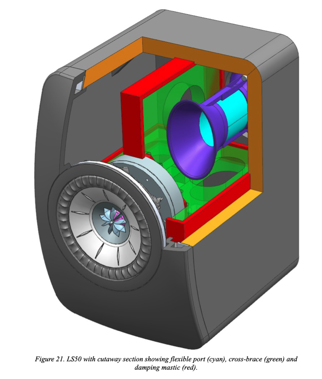

KEF has a habit of bracing drivers from at least the eighties on. You can see the braced and damped (the red stuff) magnet in the LS50 and the rather lightweight baffle. It actually is quite basic engineering. Very effective though. I think every other serious manufacturer has at least experimented with such approaches. Getting it right in a production chain is another challenge...
Source is -of course- the white paper.
