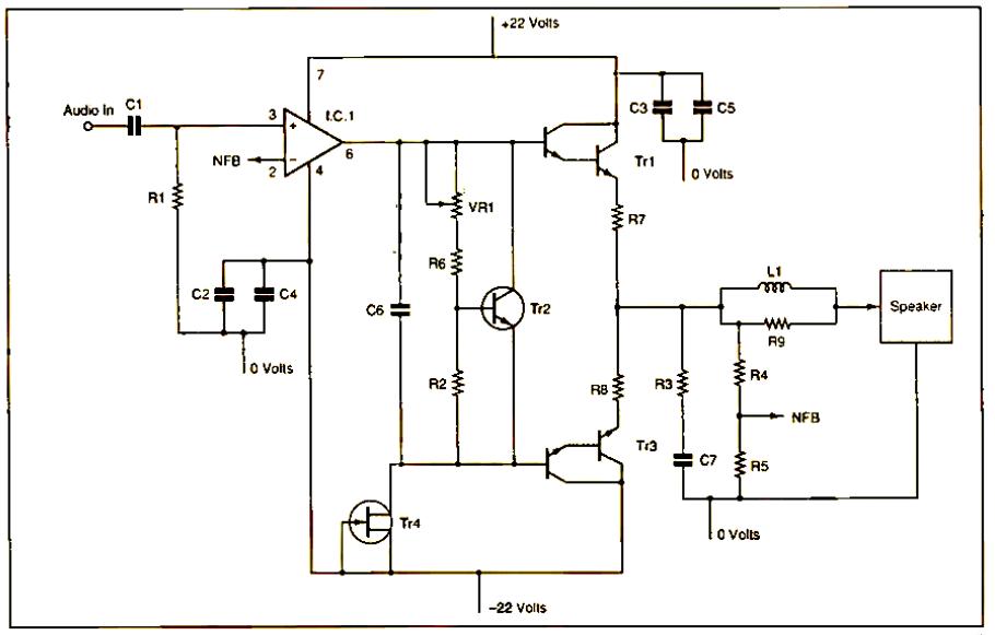

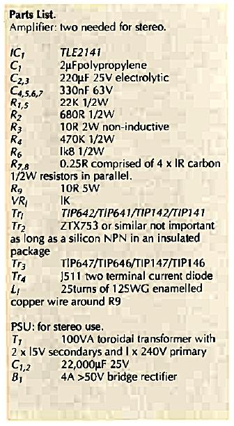

This one is 50w into 4ohm but 0.02% distortion at 1khz. Full power bandwidth 350khz. Performance is down to the op amp that needs it's caps nearby.
Couldn't clean up the parts list
Design by a TI application engineer. 😉 Bugs me a bit so posted untested. Sign of the cross etc. Adjust to 50mv across VR1 which puts it into some class A but he doesn't say how much, just that it reduces distortion significantly. TR2 is epoxied to the heatsink. From memory as lots used the one he mentions is a thin TO92 type.
Star earth it all.
Star earth it all.
