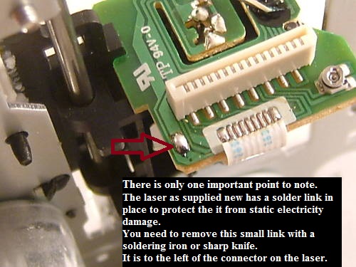

I found the same. The mech I received from MKII group buy did not work with my shigaclone. I'm wondering if they are not compatible or if I've overlooked something.
I take it you removed the static solder blob ?
That's something you easily forget the solder blob 😉

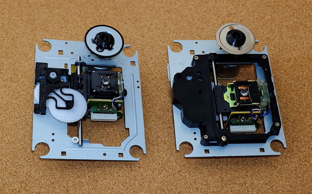

I don't have anymore JVC Shigaclone to test different mechanics, but I can confirm that Shiga MKII will work with all SFP101N-16P mechanics.
Some mechanics are noisy than others and some read better than others.
The best I got are from Dalbani and they sell these as original Sanyo.

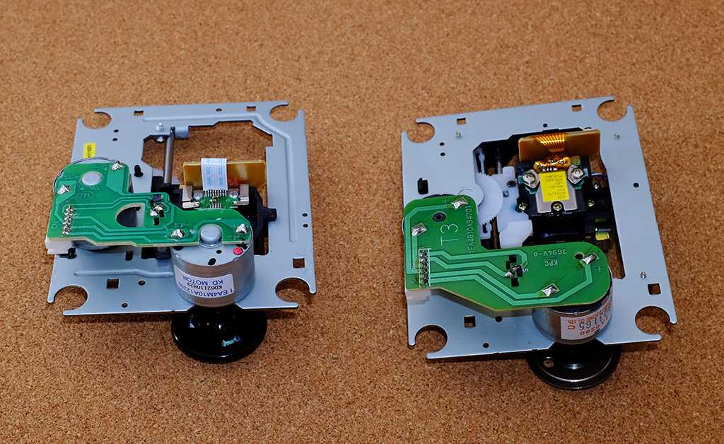

Thanks I was at work and browsing fast on a break and just saw it empty[XR5] at the top like the one I have. This brings up a question I have. Some mechanics have gold in transparent ribbon cable, is this a better quality connector?
Steve​
Steve​
This is part of the higher quality sanyo mecha

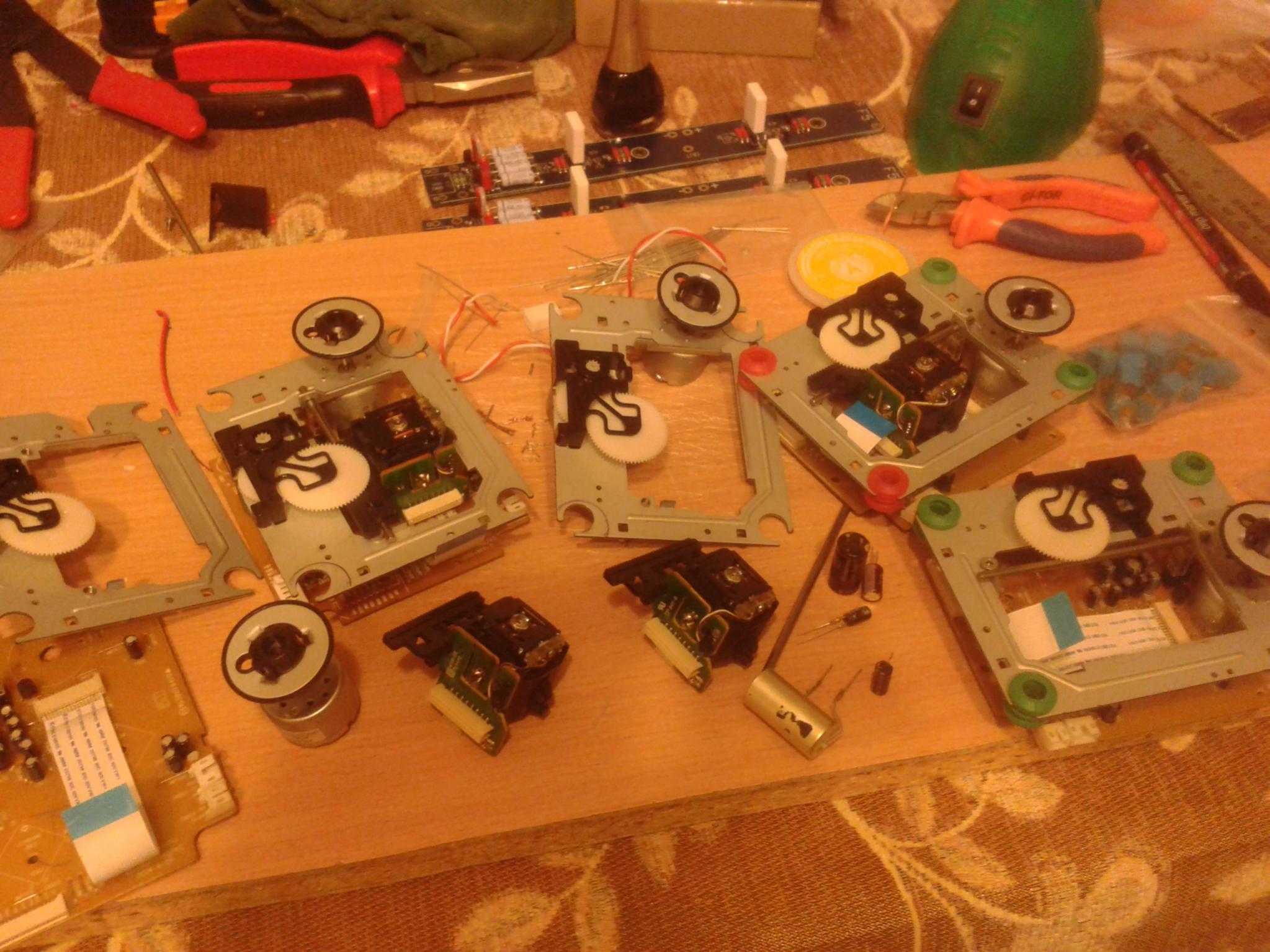

Worked hard today all afternoon to solve the issue with skippin and TOC reading with Vishay modified laser and the case is solved-closed.My shiga read every CD I put on.
So may steps was like this:
1.Find best laser unit modified with Vishay1837 that read best possible and most of CD's. At this point I figured out unredable CD' and insisted only on this . Now ,once figured out the best laser unit ,I got 90% reading CD's...
2.Switch some mechanism platforms and find best one,at this point I find that some will perform very poor,I mean not reding at all...So figured out the best performing mechanism I got reading without skippings all CD ,but anyway there was one that will not give up and that one is ABBA's The Album(Polydor 0040150)...Not reading even TOC...but I foundet that if read TOC of another CD and put to play this one CD will be played...
So, I got shiga playing without skipping ALL CD's ,but only ABBA give me headache.Some time reading TOC ,it take a litlle bit longer but it reads and palys nice. and now I came to compound No3 that make the solution to 100% read TOC and without skipping ALL my CD's.
3.That is legendary C906. I was using there an russian FT-1 0.012uF.So I changed with Vishay 0,1uF and... voyla it reads ALL but ALL CD's in my collection.That means to me that 0,01uf is not enough for some reason to read properly all foulty CD's.
Finnaly, it took half a day to me but I'm happy now ,listening ABBA's The Album .
Hope my findings will help to someone...
