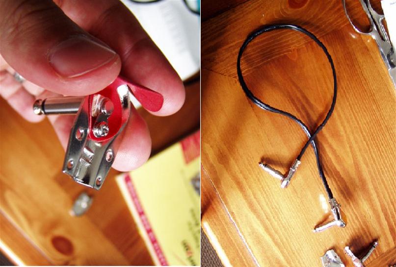

I bought a 1/4 plug and found a lampcord. The only problem is that the plug only had a post for what I believe is the positive. It wasw surrounded by red cardboard. I think the other wire is just supposed to be soldered to the case. I took a picture for you guys to look at. Let me know.
