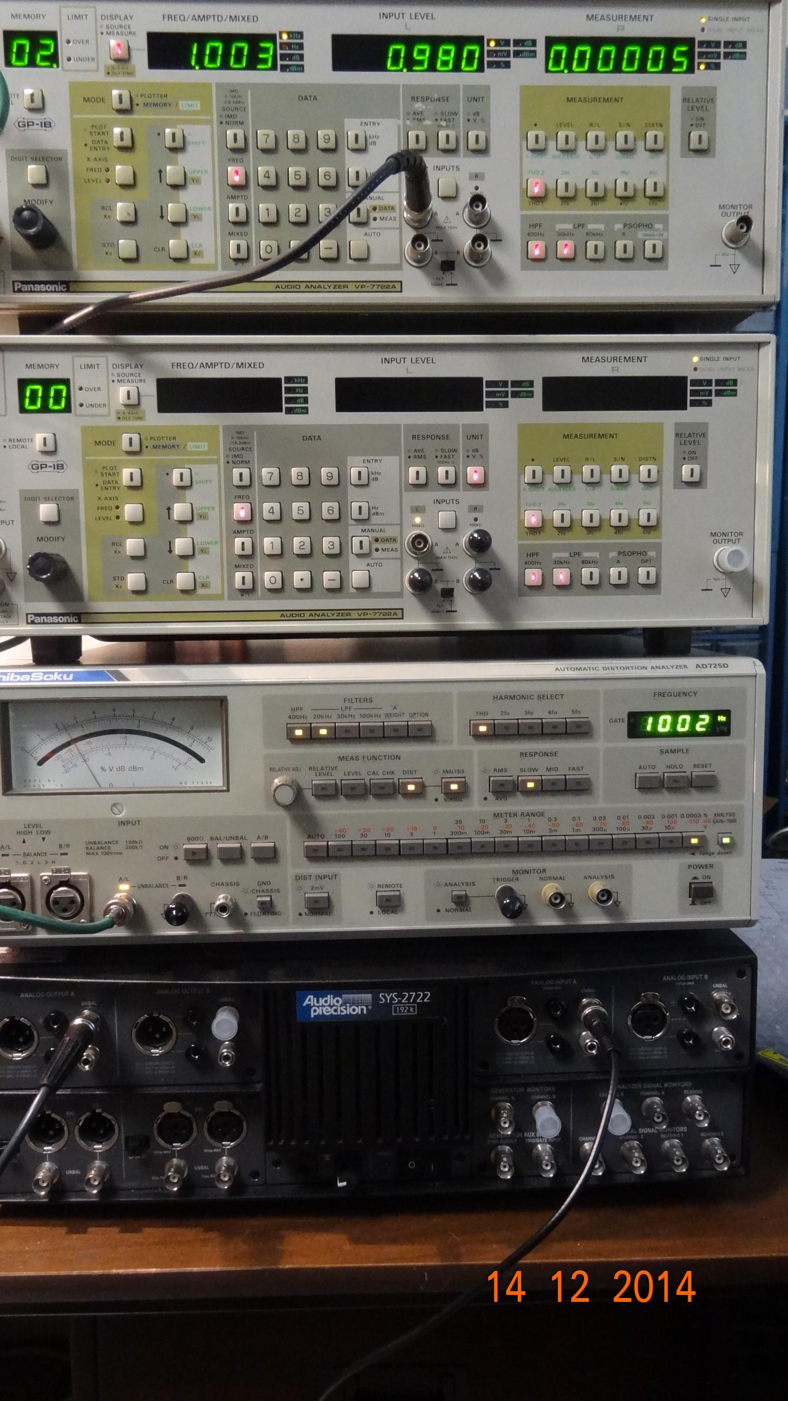

One thing missing from the AD725 is an oscillator. They sell a seperate chassis model. It is spec'ed to be better than .0001% THD. However, there is a close cousin which Includes a very low THD oscillator all in one chassis. It is sold as a Panasonic VP-7722A.
I say cousins because they are both manufactured by the same company...... Matsushita Communications Industry - Japan. You see these more often on ebay et al than the ShibaSoku. Both built to high industrial standards.
Seperate units -- osc/analyzer from ShibaSoku or one chassis from Panasonic Industrial. Both excellent units.
[the other VP-7722A shows .00003% THD]
THx-RNMarsh
