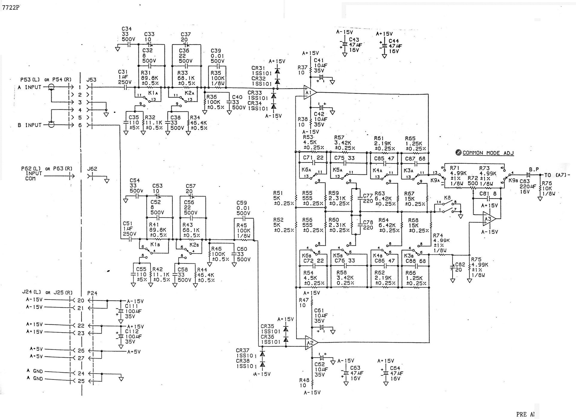

Attached it a page of VP7722 SM that I have.
It seem that Op-amp is used on the input amplifier part and it's diff. from VP-7721.

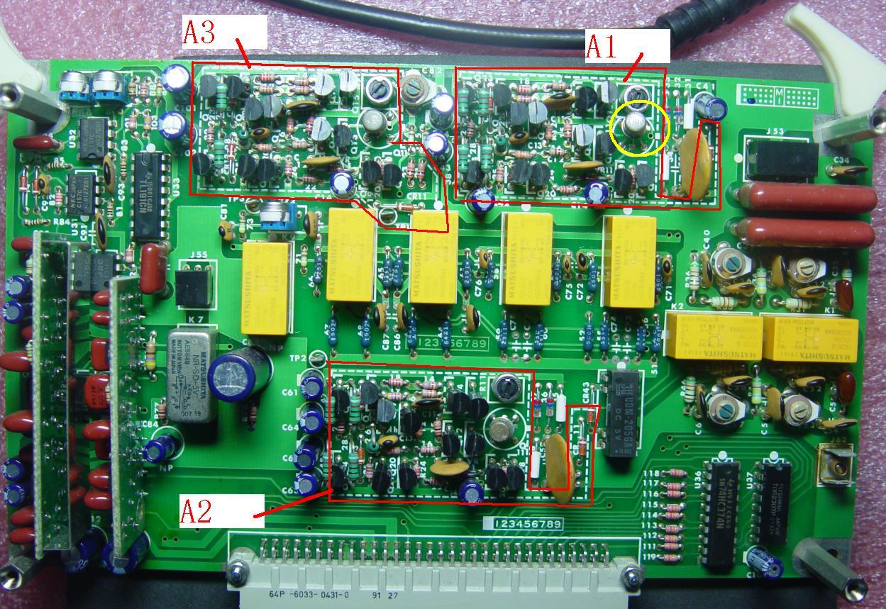

The operation is similar on ShibaSoku and mfr is same for both. Can you read the opamp part number on a pcb? I did a quick look inside a few weeks ago and it looks like mostly discrete circuitry..... ShibaSoku uses discrete opamp topology at front end.... IC Opamps other places.
THx-RNMarsh

Richard,
You are right. I check it in detial, I found it's discrete circuitry, not a OP-amp, the symbol A1~A3 in VP-7722 SM, just a symbol, and stand for discrete circuitry. Pls. refer to my attached.
the key component is the TO-99 marked in yellow circle. I will check the part number later on, given that my Vp-7722 is placed in my other place.
