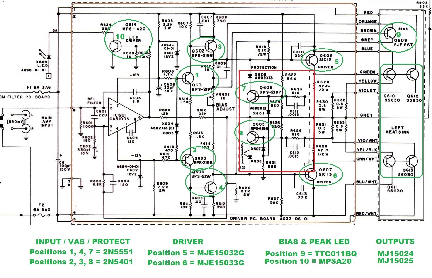

So the way that pot is in the circuit, it can be dialed to 0 ohms. With the 1K resistor downstream, 1K was the lowest setting possible. This overshot the bias voltage. With the 562 ohm resistor, and the pot at 65 ohms, its additive resistance measures 560 ohms in circuit. This was not possible to obtain with the 1K resistor. I guess a 470 ohm resistor would make better use of the trimpot.Something here does not add up. You SHOULD be able to set the pot to 232 ohms (or somewhere close) with the original 1k and get the very same result. It is about the right number of Vbe’s so the pot setting makes sense. Does that 1k resistor actually measure 1k or did it get damaged and go high?
It looks to me like the brown wire is on the wrong side of the trim pot. If you have the 562 + 65 ohm pot in the collector-base, and the 150 ohm in the emitter base, it would behave like this. According to the schematic, the 562 (or 1k originally) should be in the collector-base by itself, and the pot+150 in the emitter-base. Then you would have a more comfortable range of adjustment. AND if the pot ever fails wiper-open (what happens when they get old and crusty) the bias will automatically drop, rather than rise to crazy levels.

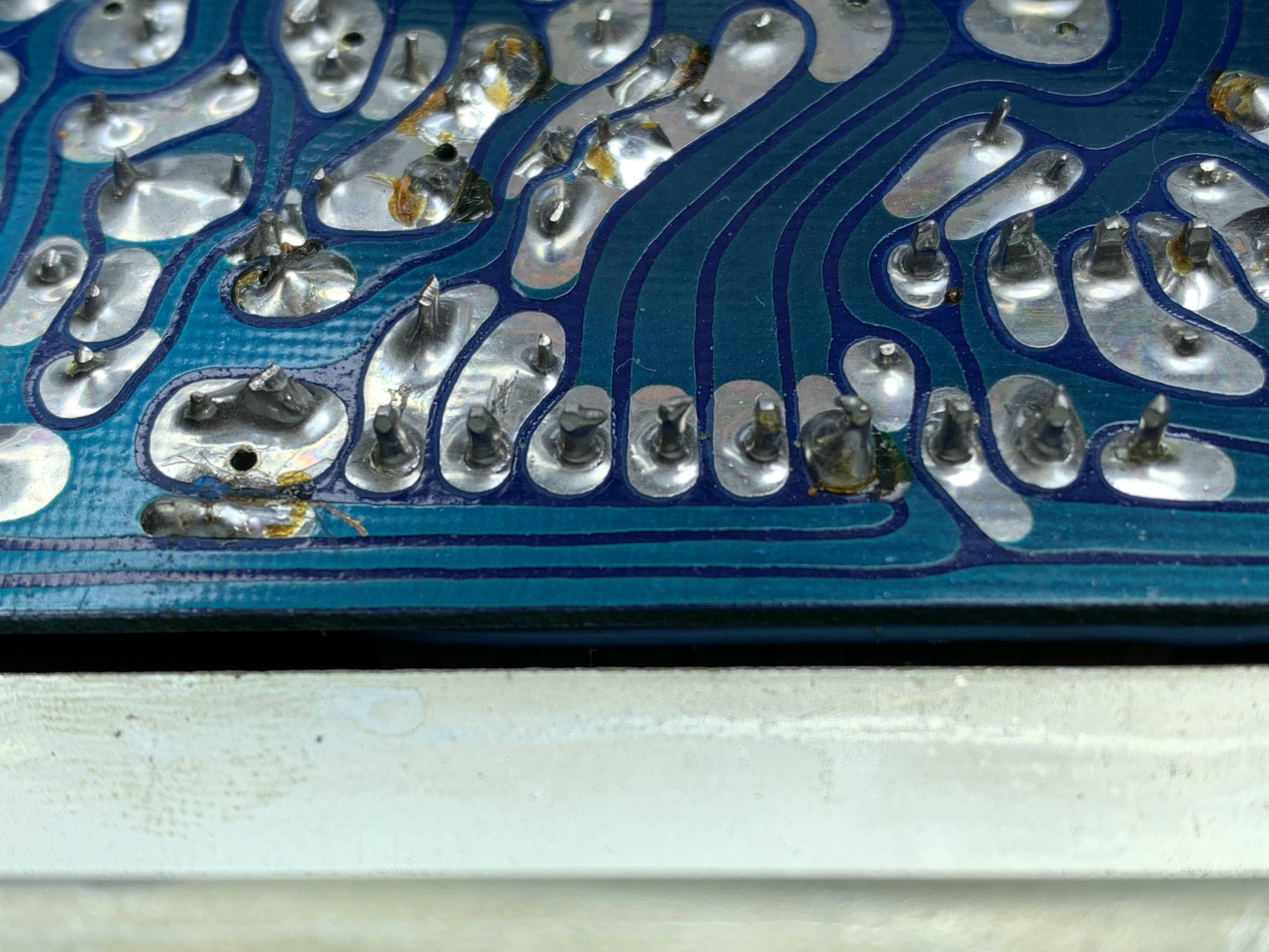

Here is a better picture of how the pot and the two resistors are wired. 562 ohm resistor on the left, pot, then 150 ohm resistor (tan) on the right. Notice 1 trimpot leg with the 562 ohm resistor and the other 2 legs with the 150 ohm resistor.It looks to me like the brown wire is on the wrong side of the trim pot. If you have the 562 + 65 ohm pot in the collector-base, and the 150 ohm in the emitter base, it would behave like this. According to the schematic, the 562 (or 1k originally) should be in the collector-base by itself, and the pot+150 in the emitter-base. Then you would have a more comfortable range of adjustment. AND if the pot ever fails wiper-open (what happens when they get old and crusty) the bias will automatically drop, rather than rise to crazy levels.

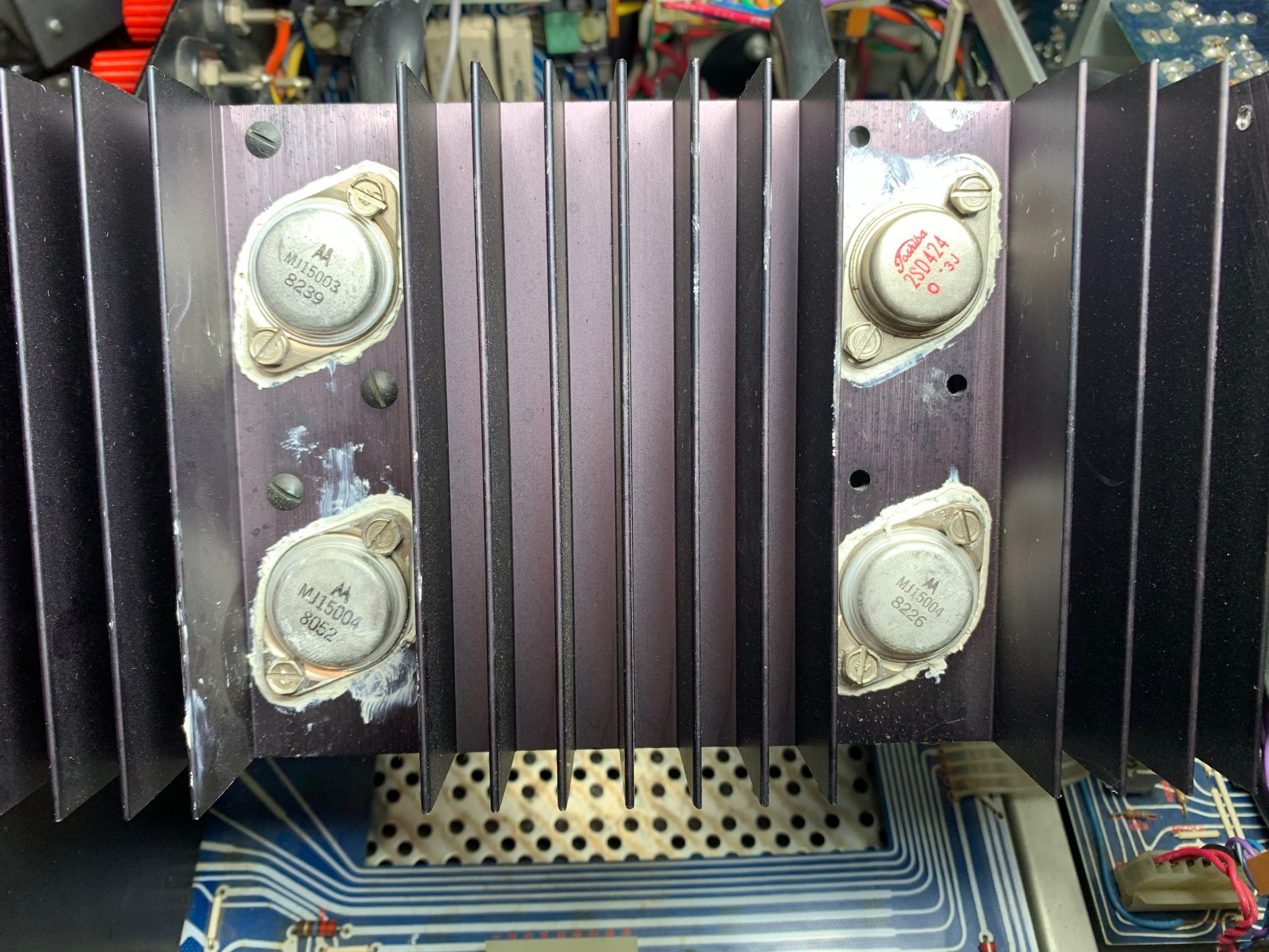

Tonight's progress, other board completed and tested. Less drifting on this board, and this is the one that burnt. Tested with the same power pack, too tired to pack the other heat sink, and they are hefty. 1.8 mV easily obtained. Great sound.
The reflections on that back side picture make it hard to trace - you’ll have better luck with the PCB in your hand. The results you describe are as if C (brown wire) was connected at point B. The schematic shows it connected at point A. Point A is technically correct - as it easily allows the bias to be adjusted WAY down, and if the pot goes to maximum resistance this is what happens. With it connected at point B the adjustment is tricky - and if the wiper opened up on the original pot, it may have even been what caused the original failure. This wouldn’t be the first time a design error was overlooked, as it could be made to work.
If you just leave it, it will probably be “ok”, as that Bourns pot is about as good and reliable of one as you will get. I would be inclined to do one of two things. Either move the connection to where it is supposed to be, or change the pot out with a 100 ohm to limit how high the R can go in the event of pot failure/wear out. The bias probably wont go stupid high if the pot goes to 100 ohms instead of the “proper” setting of 65 with that choice of Vbe multiplier transistor. With it up at the full 1k, the bias is way excessive.
Your sketch finally helped me understand what you meant! I will confirm that the brown wire (base of bias transistor) does connect at point A. It should. Also your suspicion of what caused the catastrophic failure is probably correct. I could not get a stable or symmetrical reading off the original pots, and I think one was open, I bet they caused the chaos. Notice the bias resistors smoked off, possibly while the pot was belly up resting. Every chance I've had, those Bourns pots go in.The reflections on that back side picture make it hard to trace - you’ll have better luck with the PCB in your hand. The results you describe are as if C (brown wire) was connected at point B. The schematic shows it connected at point A. Point A is technically correct - as it easily allows the bias to be adjusted WAY down, and if the pot goes to maximum resistance this is what happens. With it connected at point B the adjustment is tricky - and if the wiper opened up on the original pot, it may have even been what caused the original failure. This wouldn’t be the first time a design error was overlooked, as it could be made to work.

With driver board in hand, I confirmed that the brown wire (base of bias transistor) does connect at point A.
Finished the unit today, dialed bias in quite easy and assembled everything back up. Works without a glitch and produces great sound. I will take some final photos and wrap this experience up. Thank you wg_ski, and others, for your great and valuable help! Could not have achieved this great result without you. I hope this thread will help the next HP-2000 owner, it is probably the only one with this level of technical information.
To summarize, the only mod made to the entire circuit was to replace R617 with a 562 ohm resistor. The stock resistor there is 1K. This enabled the bias to be dialed down to spec (1.8 mV DC).
