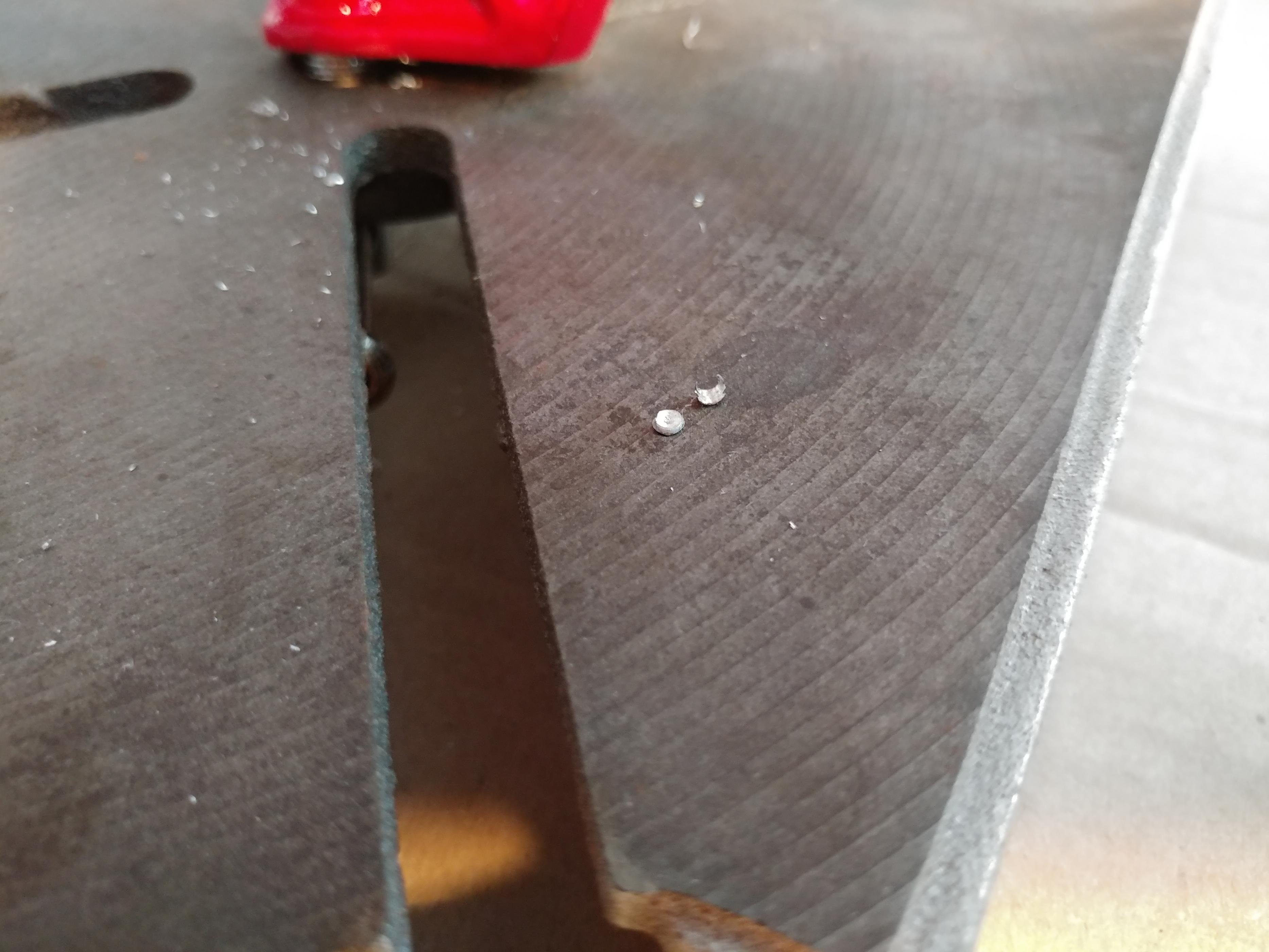

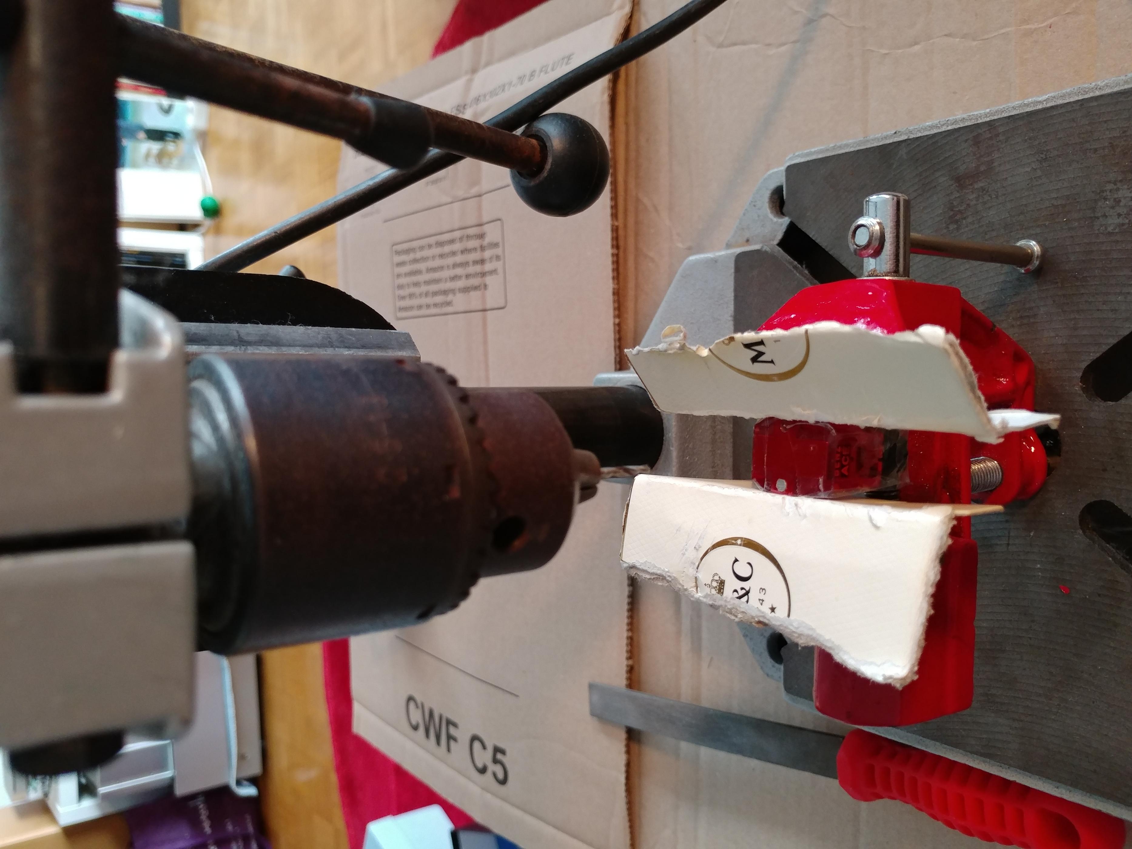

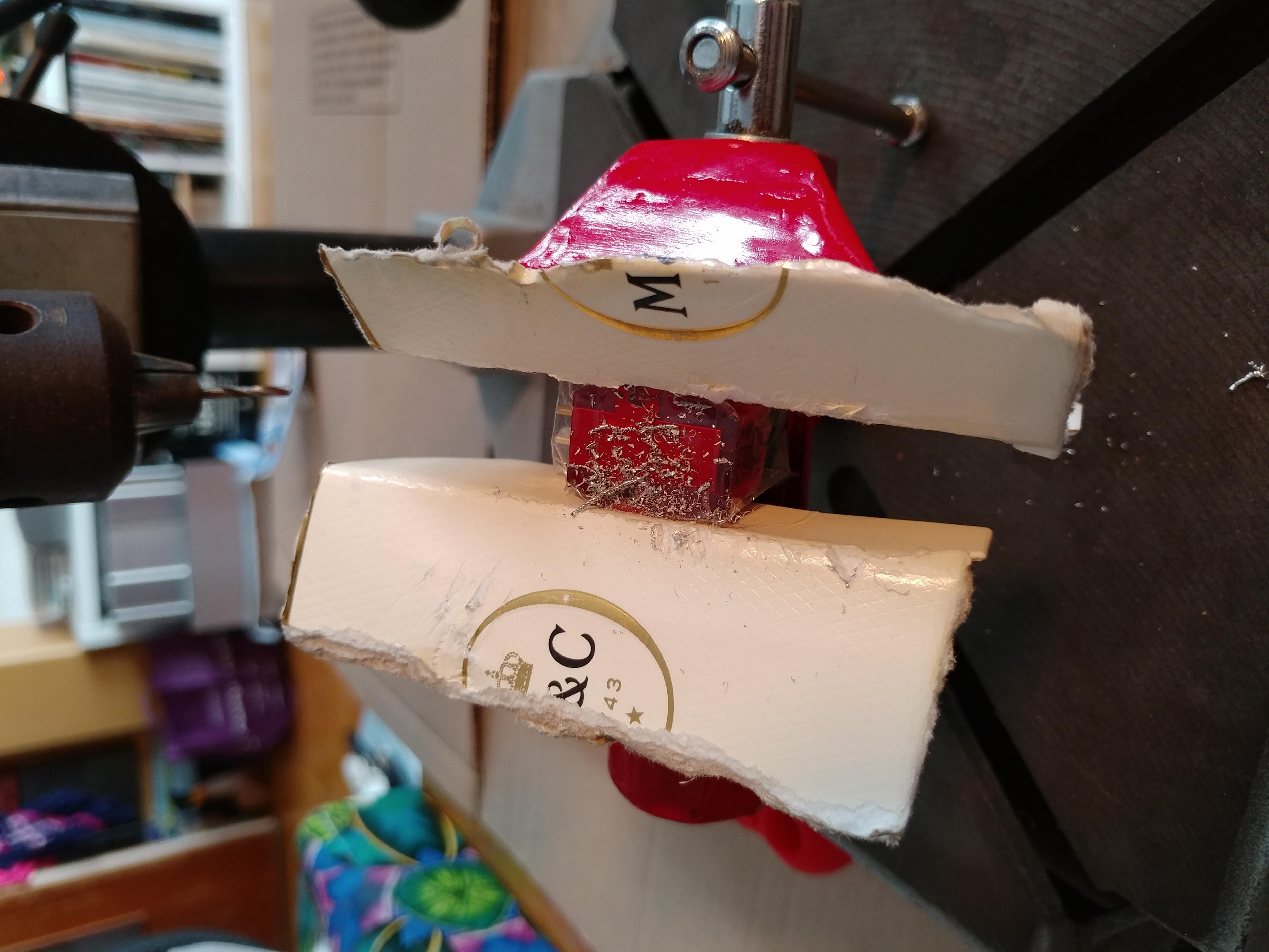

I once drilled out the core of an aluminum screw that got sheared off inside a Benz cart. I bought the cart that way, mind you, not my doing 😉
Anyway, I first tried cutting a slot into the remaining bit to get some torque on with a screwdriver, but not a chance. The screw had seemingly fused to the threads and the newly formed slot wore down quickly. So I filed down the remaining stump and went to town with the drill press.
After drilling out the core (nerve wrecking) I had to pry the screw's threads from the cart's threads. All in all it went as planned. Just thought I'd share.
