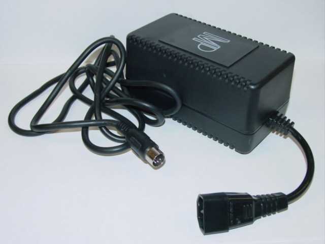

Mike maybe this would work for you - has 5V and 12V - I believe it may have the same connector as your panel. Hope this helps😀
Power Supply
