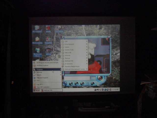

Yep just tries the soup ladel - it works a little better

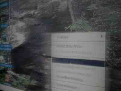

not mutch - I still had the ghosting look at the pic below
Oh and it does cut some off at 800x600 not mutch

because you arent using a point source light
I was thinking that - I guess that I will have to find a better
light source
I will go with a Metal Halide setup
500W halogen would work but the heat would kill my
small room - and a 250w Metal Halide should be as
bright as a 500w halogen and a lot less heat
250-300w is as high as I want to go to save power
So now I have to find a cheap Metal Halide setup that will
work in a projector 😕 :bawling:

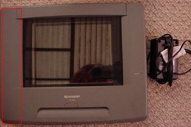

Sharp QA-1250 13 inch wide, 10 5/8 long, 2 1/8 thick
I am getting the measurements so I can make a box to
put it all in - I may just buy a trunk or big tool box ,ect ect

will, I'm planning the same. If it means anything to you, you can save a few inches of space by moving the left side curcuit board over to the other. its not much but the other advantage would be having all plug inputs, power switch and speaker on one side. They are just regular wires as you probly know. You could move the buttons too if you're real keen, getting everything on one panel.
Im gonna do that, trim the plastic case with a dremel and re-seal for airflow over the lcd.

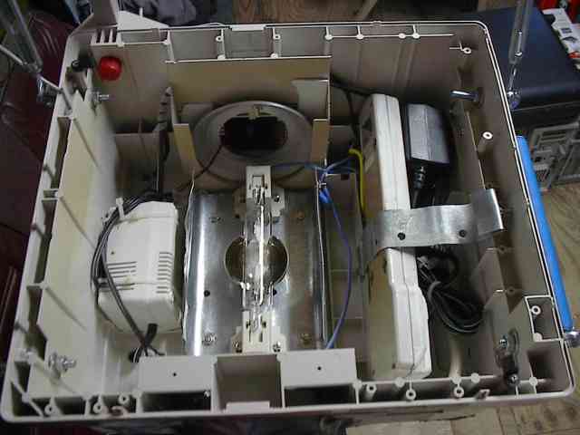

I put it all in a trunk got it working and then messed it up
by trying to make it better - I have worked a week on the
trunk staying up late nights - And I need a break -
Now I have put all of it back into the old OHP just to take a
break

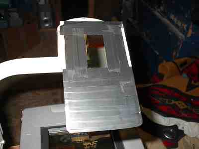

Have a laugh and look at this funky nasty waste of duct tape
:clown: - but it works - and I got to watch some TV - every one
thats sean it has died laughing, Sad thing, me to :smash:
- I thought I would share it - I will wait a week and decide
what to do

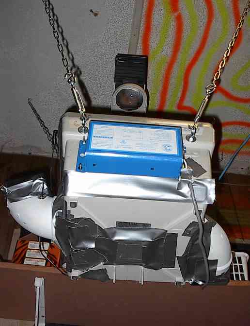

One last image - I had to use a lot of duct tape
to cover the holes dont worry I am using 2 12v fans
1 in and 1 out and 4in sewer pipe for air ducts and
to stop the light - I ran it for 6 hours and only luke
warm air came out - the only heat damage was the
yellowing from UV light - well this it for this ugly duck
on to bigger and better things :devilr:

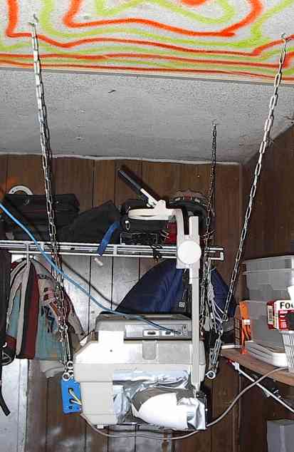

I have been using for a week - I almost melted my frensel
- I think air is getting traped at the top, inside of the
OHP, I am still getting only luke warm air out the vent fan
I removed the frensel and put it in top of the OHP
and then set the LCD panel on top - This is just temp
I am waiting for my MkIII projector kit
If you do retrofit a OHP with a HQI put a fan for a vent
as far up at the top as you can blowing out or you might
melt something :hot: :hot: :hot:
