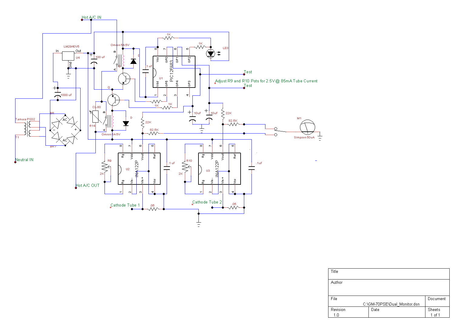

Sharing Meter with Switch
Maybe someone thought it has some form of non linear resistance like a fuse that really does.
Nah, leave it in circuit. You could always try some blind A/B testing with your friends but I really don't think anyone or any measurements will tell a difference. That is as long as the wiring isn't six feet long🙂

Progress. I was already monitoring the current through each GM70 with a PIC and INA122 op amps....the light went on and I tapped the INA122 output for the meters...duh!
Works great and no switching noise.
