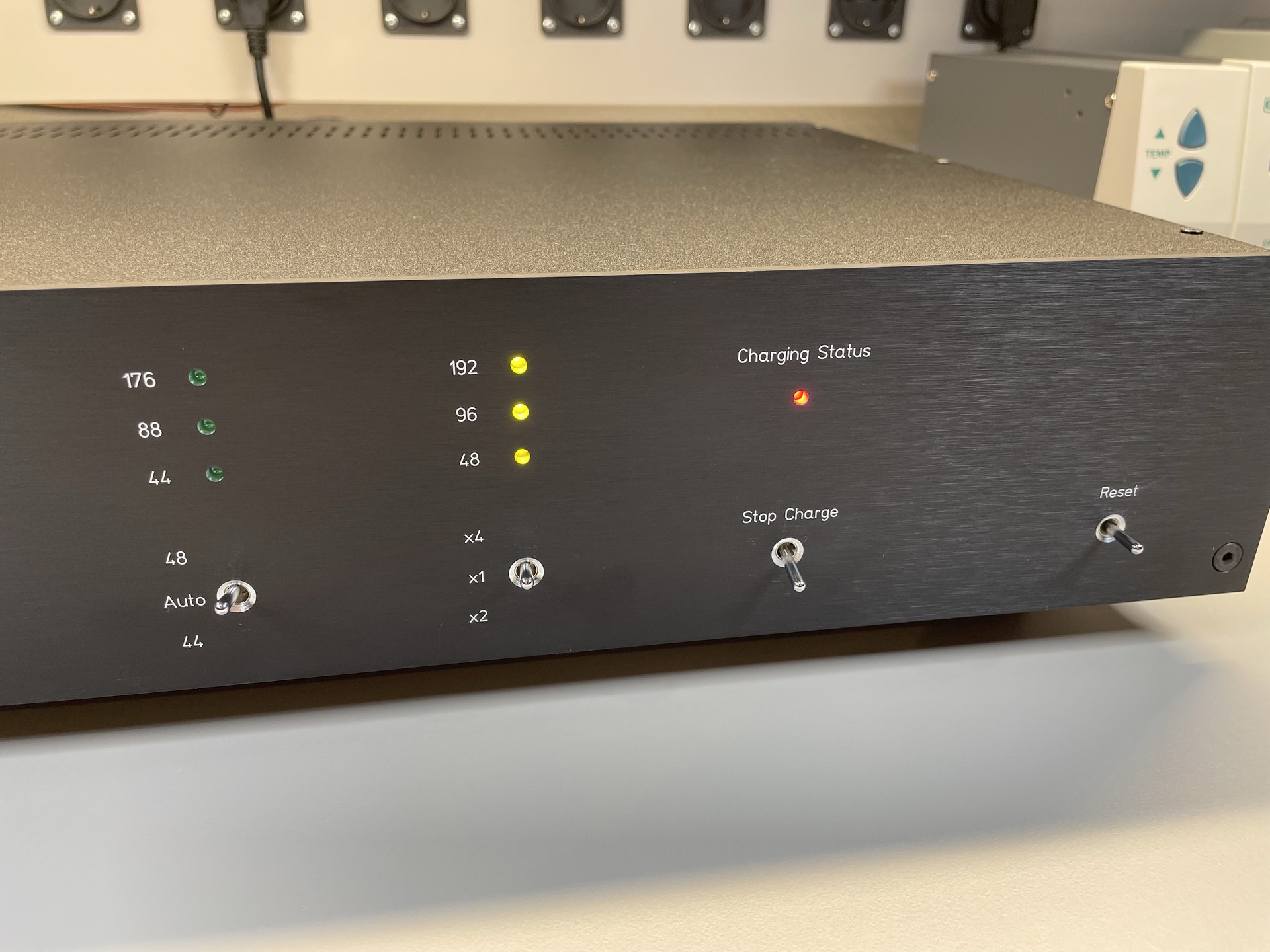

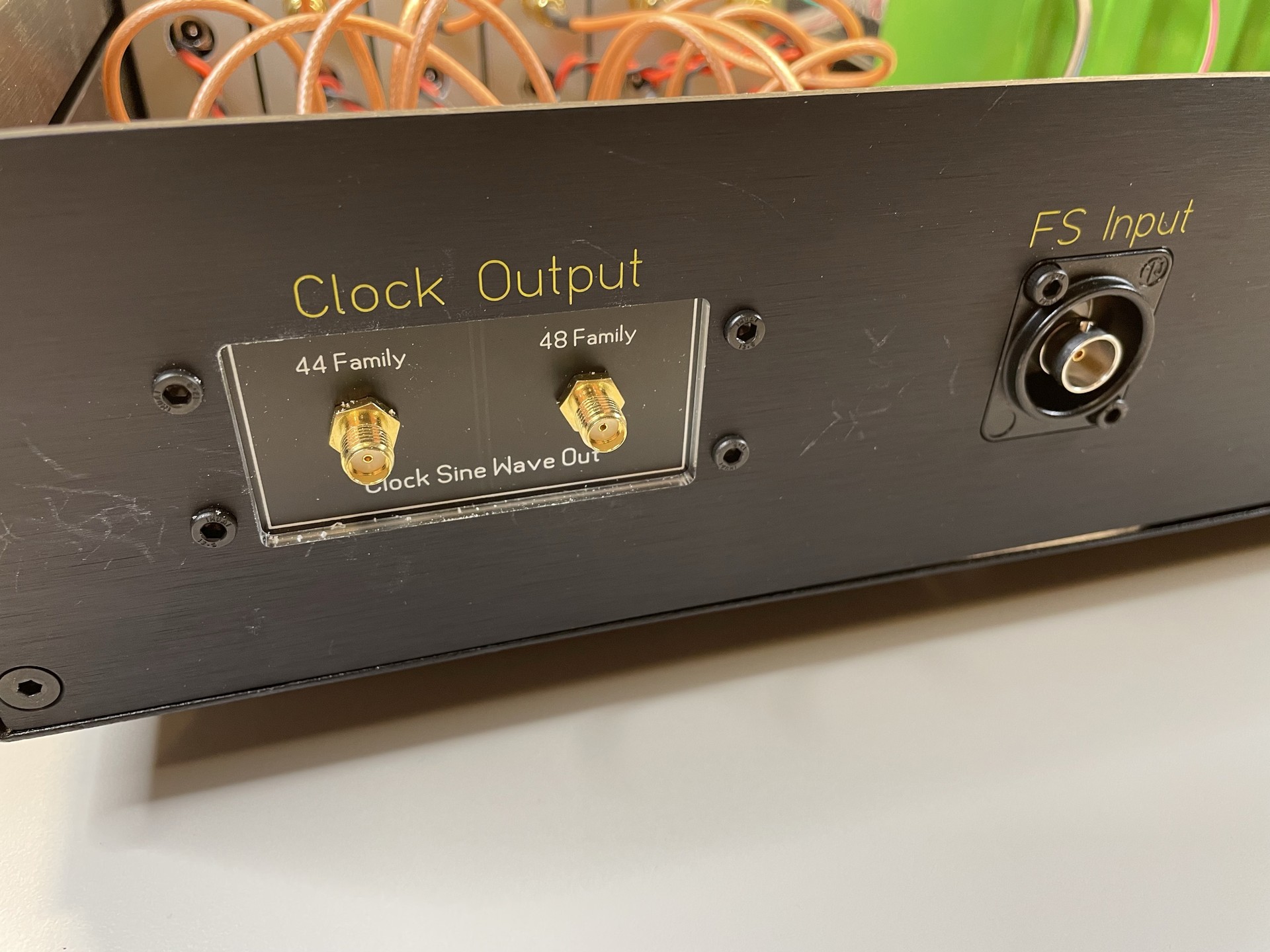

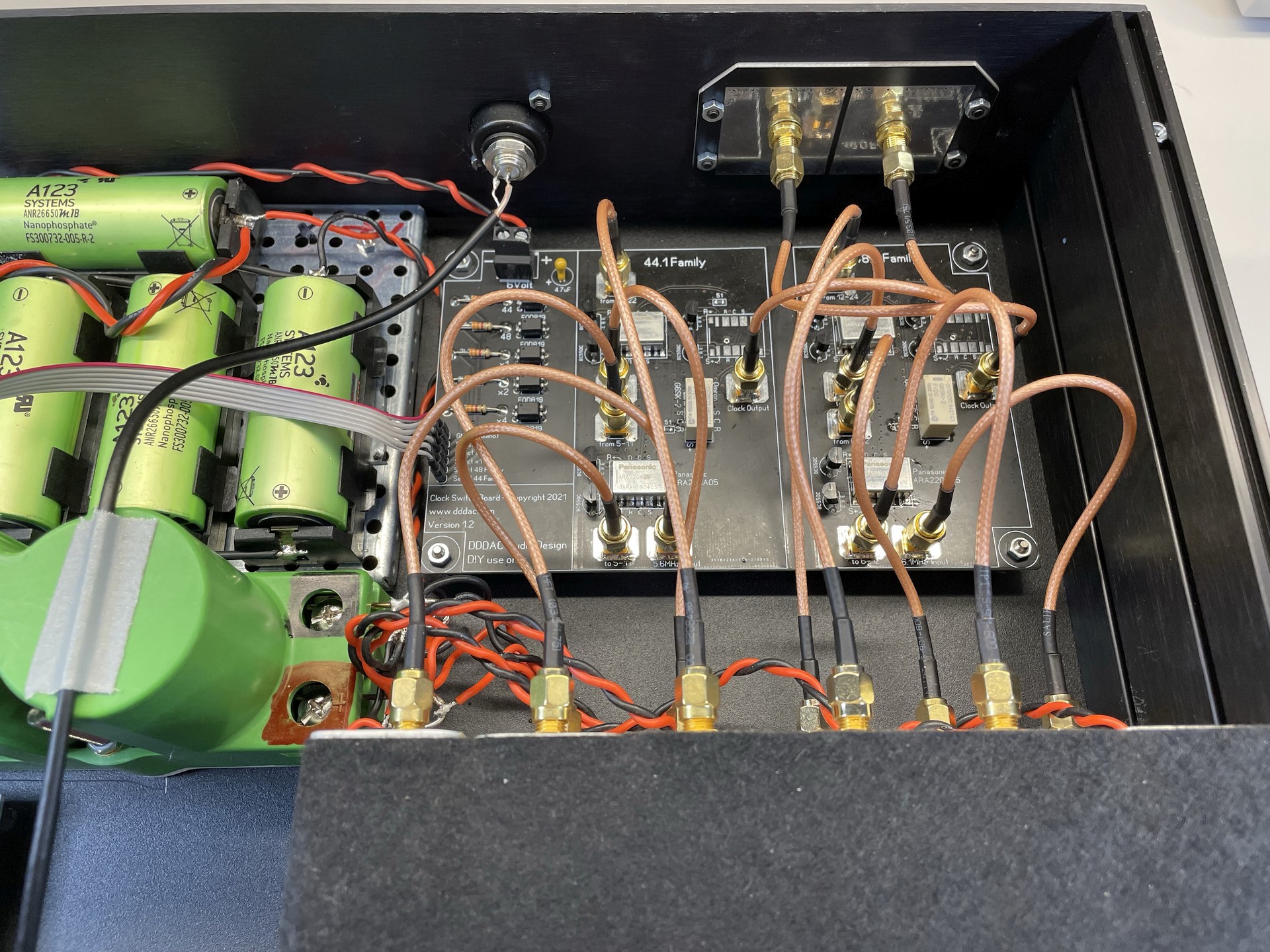

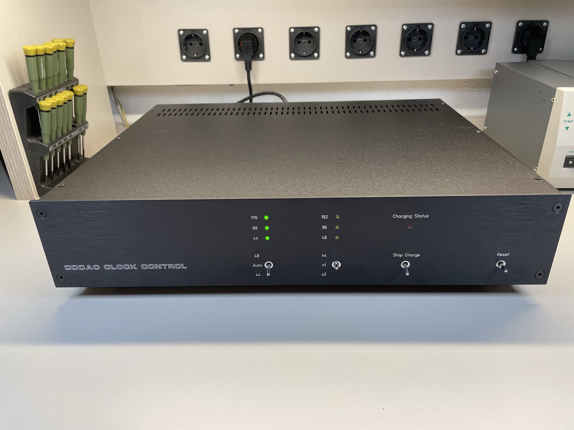

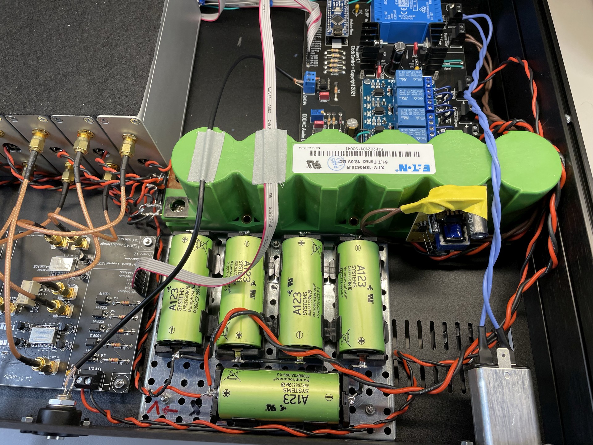

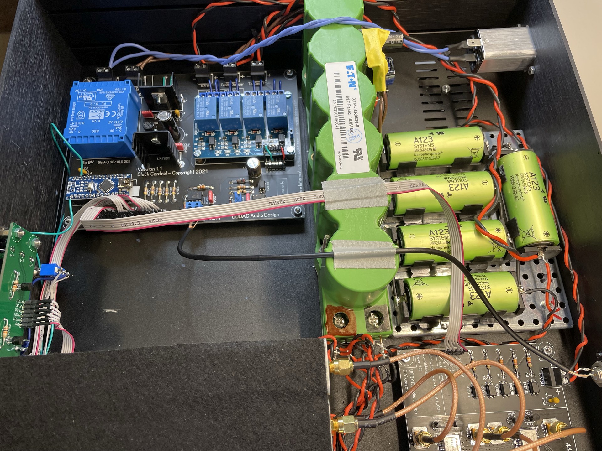

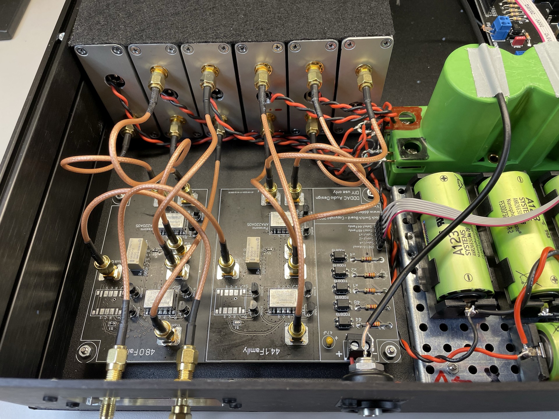

Yesterday evening I closed the chassis for the clock project - meaning everything works fine now. I tested everything with my bench DAC which is a RPI with the FiFoPi from Ian Canada. The clock is going to the sinePI squarer from Ian.
There was one problem though with the automatic switching. For that I need the L/R clock signal to determine the FS rate. I thought I could pick this from the NON-Isolated side on the FIFOPI - well.... wrong .... The problem was solved though by picking the L/R signal directly from the GPIO at the RPI....
Today I will get the clock signals and FS signal connected to my Audio Rack DAC and will be able to do (finally) the listening review on the doublers when yes or no in series with the basic clock.
below are some pictures of the current state of work

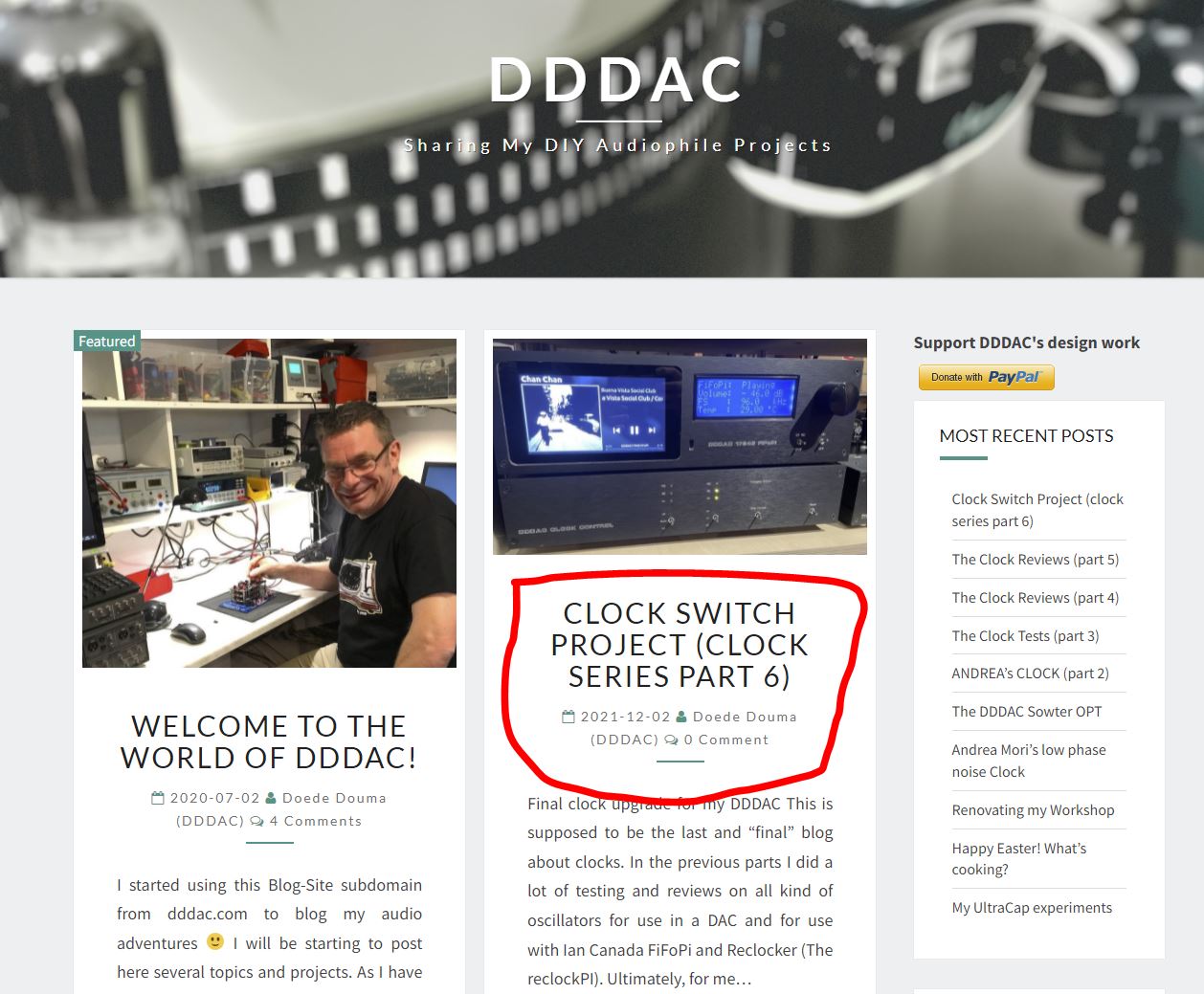

I just posted the final clock blog.
it covers the Andrea Mori clocks with and without doublers and the Ian Canada SinePi and ReclockPi as well
have a nice read 🙂
