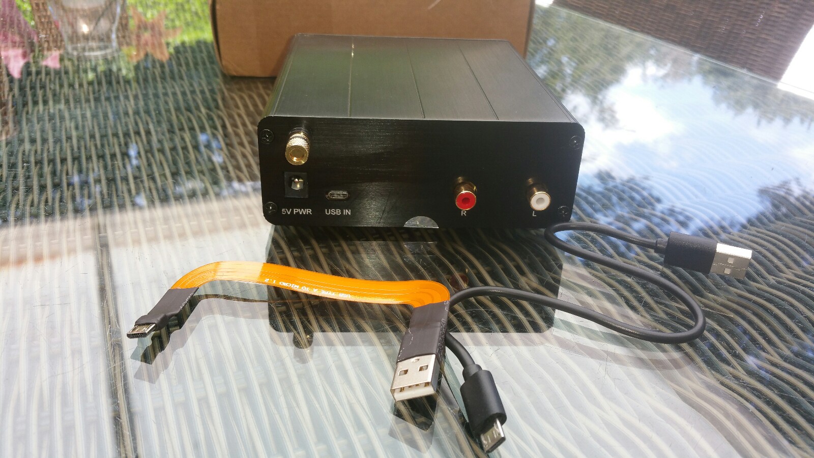

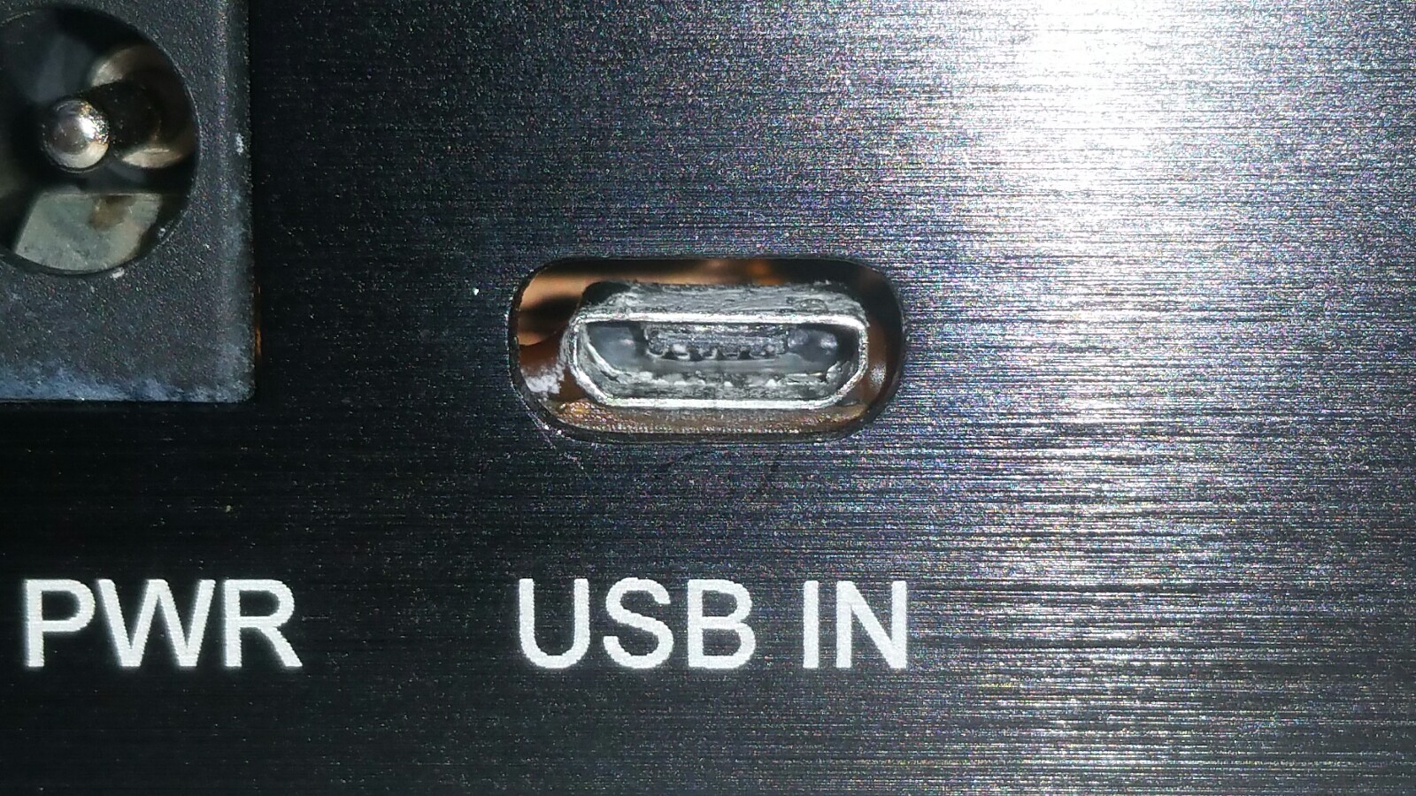

Today arrived the revolution dac, so far so good 😉
Now I want to connect the USB cable but both of them don't fit.
I think the connector in the revolution dac is not good, I make some pictures...

This is the 2e revolution dac the first one had no problems plug in and play together with the usbridge signature.

Hi Rudy
it seems that it has the right cable and connector. Its possible that some glue has gotten inside since we use it to make sure the uUSB will not detach .
Try forcing it and if not we will exchange . Do no forget that today is our last day in office
