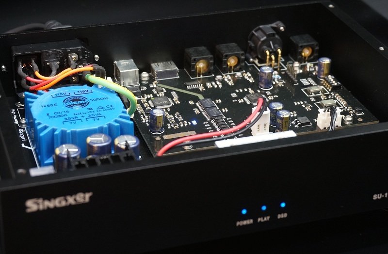

Singxer's board is a 4-layer PCB. A pair of Crystek CCHD-575 "femto" clocks handle timing, while two ISO7641 digital isolators provide galvanic isolation to keep noise separated. A custom Xilinx FPGA works its magic doing who-knows-what to help the signal stay clean and uncompromised.

Okay. The USB/SPDIF board has its own power supply. The USB power is probably only used to power dirty side of the signal isolator chips, which is okay. The board probably operates the USB connection in asynchronous mode which allows it to use its own clocks (which appear to be pretty good quality) to clock out the SPDIF. Regarding the clocks, they will be somewhat sensitive to the quality of the power supply that feeds them. Best to have a dedicated high performance LDO for that located right next to the clocks. Can't see that part from the picture, but looks like they may only use multiple decoupling caps which would not be as good. However, we are talking about SPDIF here. There is probably a limit to how good its going to work just given the nature of SPDIF. You should use a good quality, short length, 75-ohm coax cable to connect the SPDIF output to your dac. Cable quality can affect the amount of jitter arriving at the dac since a poor cable will add more.

Why, if my Singxer SU-1, do the galvanic isolation? Well, my guess is that no galvanic isolation is 100% imune of the noise created in the USB cable travelling along the data leads. Maybe if I have an incredible good USB cable the situation would be different.
