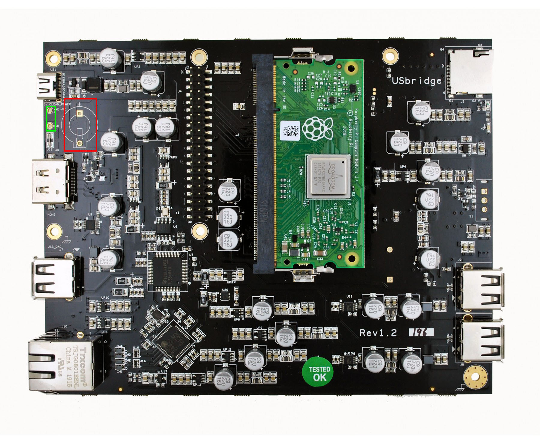

Hi cdsgames,
I have 3 little questions about Usbbridge SIG;
-Where do I have to ground it? to the chassis/enclosure? or directly to the ground wire of the IEC connector of my setup?
-In the picture attached, the connectors in green are the 5v DC in?
is that right?
-What are the use of the connectors in red on the pîcture?
thank you

@terry22,
I can help with this...
- Grounding position is the mounting hole on the bottom right in the picture you posted... see the grounding symbol there.
- Green-marked connection points ARE the 5V DC input. You can also feed 5V into the MicroUSB, but the connection points with a flying lead and a good connector should be better. Note that both of these go though a protection diode, though a higher-quality one than on stock RPis. I have not yet tried bypassing it to see if I can hear any difference.
- The connection points in red are for a Supercap, the same .33F/5V unit Allo uses on the Katana boards and the Bosses. There is a place for another on the bottom of the board on the opposite side. I asked Allo about installing them and they said they didn't see any measurable differences with them in or out (as opposed to what they saw on something like the Katana) and that in, you have to wait for the SC to discharge before attempting a reboot.

Hi Greg,
Thank you for your answer.
About grouding, I was more specificaly asking if I have to connect usbbridge ground hole to the chassis or directly to the ground of my AC IEC/plug.
Hi Terry
I recommend connecting PCB earth to chassis and then chassis to AC earth

Thank you!
