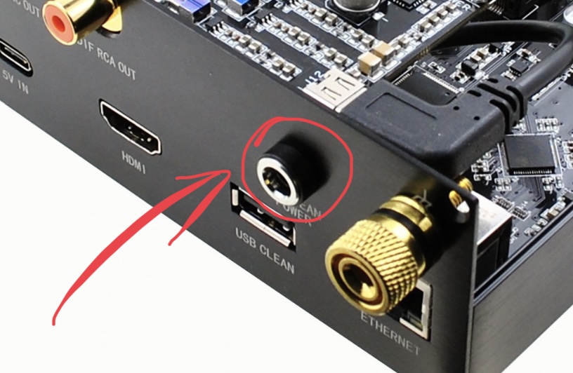

Hi, I am going to buy Allo USBridge Sig with Allo DigiOne Sig (combo in one case), and I would like to know if Moode OS 7.1.0 is fully supported? I would like to download the generic OS image from moodeaudio.org, put it to SD card ... or shoud I download image from allo site? Is there a difference?
I have also noticed the is a separate power input in the combo case for DigiOne Sig clean side. Which power plug should I use? Is it DC 5.5 X 2.1mm Input?
Hi Sojer
yes you can use the Moode image direct for USBridge. Yes input 5.5x2.1mm for Digione clean side
Hi Sojer
Thank you.
