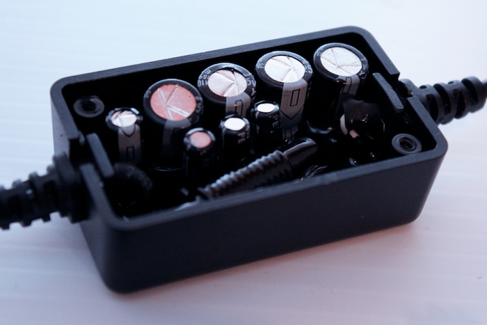

The original SBooster 'buffer' was a simple LC filter with plenty of capacitance[see image], the current Ultra is an active device (similar to noise reduction in iFi and Allo Nirvana?) at the end of the supply cable that connects directly to the load. For Shanti/Nirvana a 'simple' supercar buffer would be all thats required ?

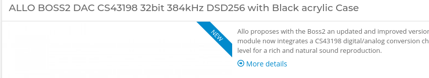

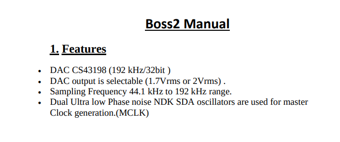

Allo please get in sync with Audiophonics regarding the BOSS2.
They sell it as 384k/256 DSD device and your manual shows 192.
And please copy your "test results" from the Boss2 bundle product also to the BOSS2 DAC section.
And finally I'd appreciate a note in the manual or elsewhere, if the display-board can be detached (desoldered)
