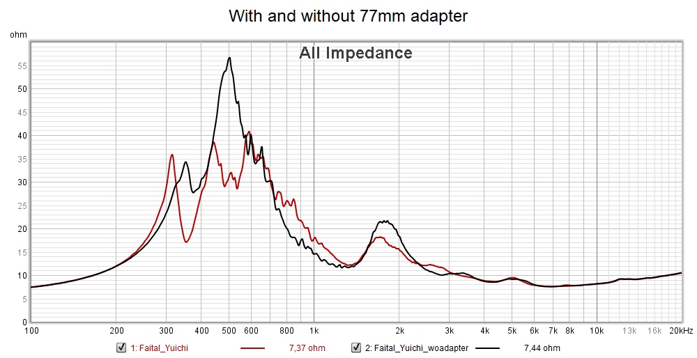

Here are the impedance measurements:
With horn, with and without the 77mm throat adapter:
Without horn, with and without the throat adapter:
I'm puzled why the dip (in the response) goes away without the throat adapter. The adapter is not a bad thing at all to my eyes, also without horn it increases loading in the 1,3khz area where the dip happens (impedance rises).

No, you are not f* :D Maybe you fool yourself :p
Very interesting impedance shots. I would assume that your test-amp is a good old voltage source - right? It simply delivers more power into the lower impedance.
You would need a current source or make the impedance more constant to the amp. Basically two attempts could be done. As I already said wire an 6.8 ohms resistor in parallel to the driver or wire an 47 ohms resistor in series with the driver. Both are quite simply to do. The second mimics roughly a current source while output level is limited.

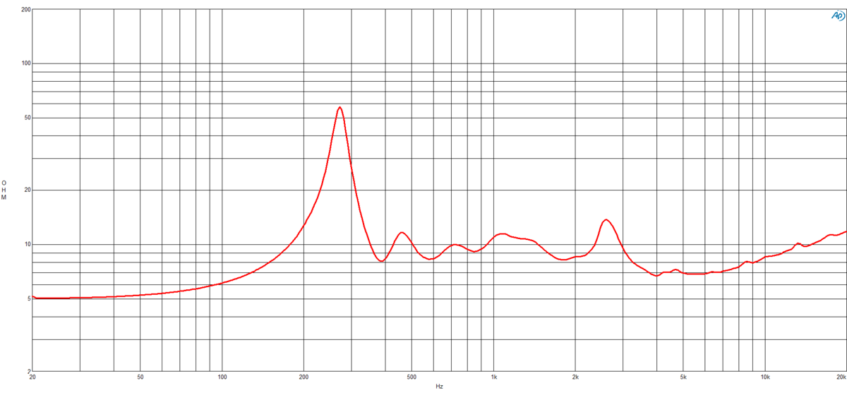

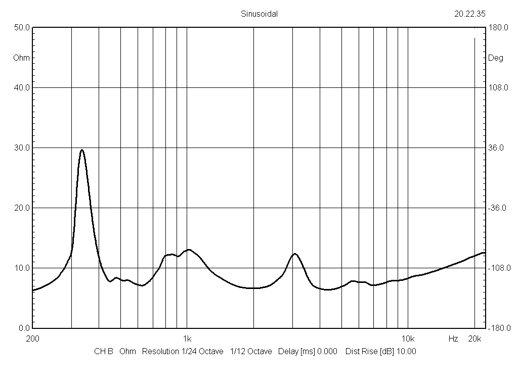

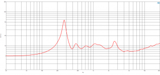

I am simply impressed by the TAD figures. It seems to have almost no basic resonance peak

The dip is not due to amp/speaker impedance interaction, it is there also without the crossover. Current driving (series res) the speaker will make it only worse because there is a dip in the impedance also at the same freq. Parallel resistor doesn't do anything with voltage source amp when measured without crossover like I have done.:)
