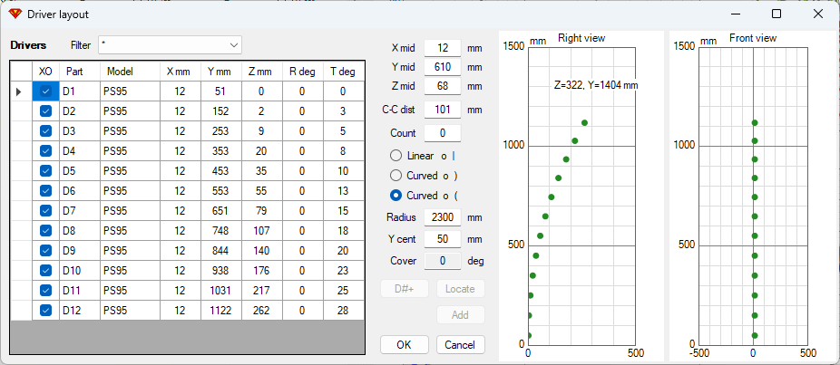

No off axis information, each drivers needs full space simulation on baffle.@perrymarshall

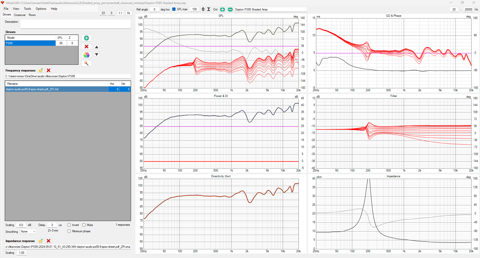

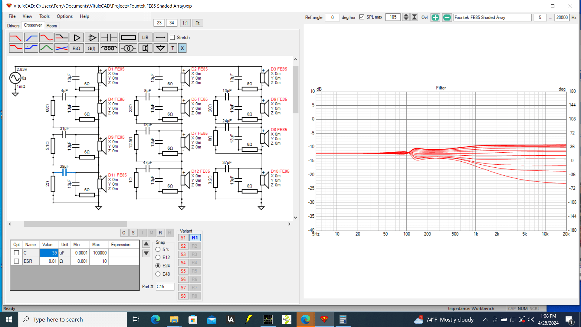

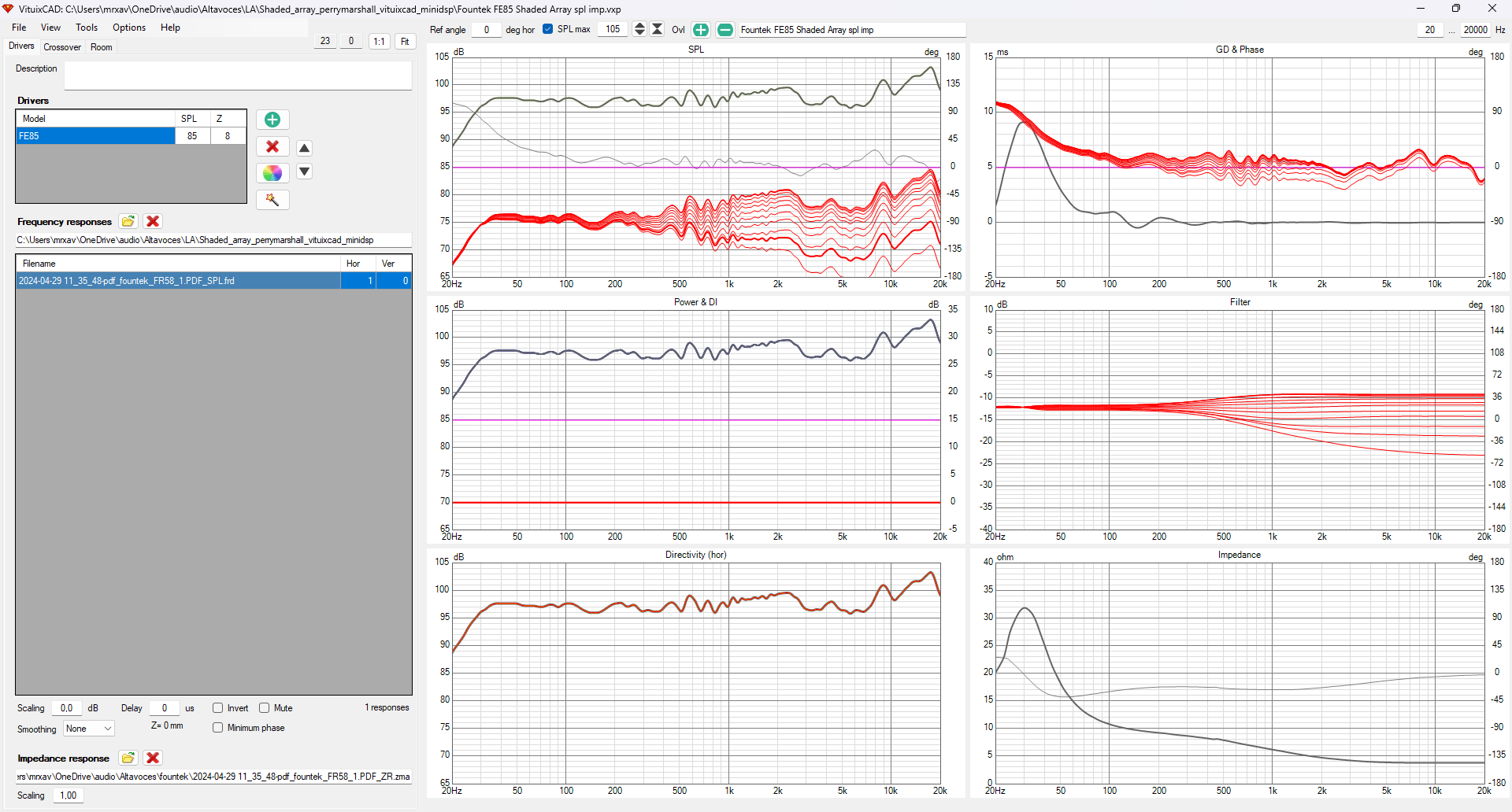

First of all, thank you for the publication, explanation and details of this project. To the extent of my financial possibilities, I am acquiring components for the manufacture of the OB Bitches Brew and suddenly this LA appears, which has always been one of my challenges and I have some interesting projects in the pipeline. I must say that I am a carpenter who is fond of music and lately I have been eager to learn in order to be able to make my own units. Therefore, my knowledge of electronics, acoustics and other ingredients is very limited.
For this reason I am asking this question, at some point you mention that the Dayton PS95 units could be a good replacement for the Fountek FE85, as I live in Europe it is easier and cheaper for me to use the Dayton units.
Before I wanted to do a simulation with both units to compare, the result confused me because just as the simulation of the Founteck is close to the measurements, the Dayton seems to move away from said frequency response (I understand that the measurements have been made with the miniDSP correction ) So the question is, is the simulation with the Daytons considered good and will it all be a matter of playing with the miniDSP settings?
Attached is a screenshot of both simulations with VituixCAD.
Thanks again for sharing and enlightening.
If you dropped in 12 copys of the same FRD
then no the model assumes they are all mounted on top of each other.
Center to center gets wider and wider for each driver.
So xyz coordinates must be set.
speakers are all same drivers so phase is same of course.
but center to center is farther apart so actual phase of
each driver be different. relative to the listening position you establish.
And phase needs to be correct for model to even be accurate.
otherwise you have factory FRD file.
Model thinks your on a Half space IEC test baffle.
And they are all magical mounted in same place.
Once you model it in full space on a skinny tiny baffle.
Youll find out how unmagical they are.
Then deal with the baffle step that results.
And then the magical cancelation from drivers mounted
millions of miles apart.
So your rolling off the top end to get rid of the cancellation.
From mounted so far apart.
Then find out that 1st crossovers wont fix it.
specially vertical
Maybe 2 or 3 drivers first order maybe would get.
For 12 speakers, center to center of your bottom to top driver.
probably stepper filter, The distance will justify how low
it needs to be in frequency.
Thank you very much for adding more ingredients, well let's see how all this fits into the final cake, as you suggested I have given coordinates to each unit, it is the first time I simulate this in VitixCAD and although the help gives a few touches on each topic I will surely I'm leaving something out again, I appreciate the notes and observations.
but let's see what we have advanced today, I have done the simulation with both units (Fountek and Dynaudio) although to avoid confusion I will only publish those from the main thread (Fountek) the results apart from the frequency response are not very different.
I don't know where the unit width measurements are defined, now with the default width, the curve and position of the drivers in the lateral projection correspond to the model (I think so)
The box needs to be simulated for the port study but that will be at another time.

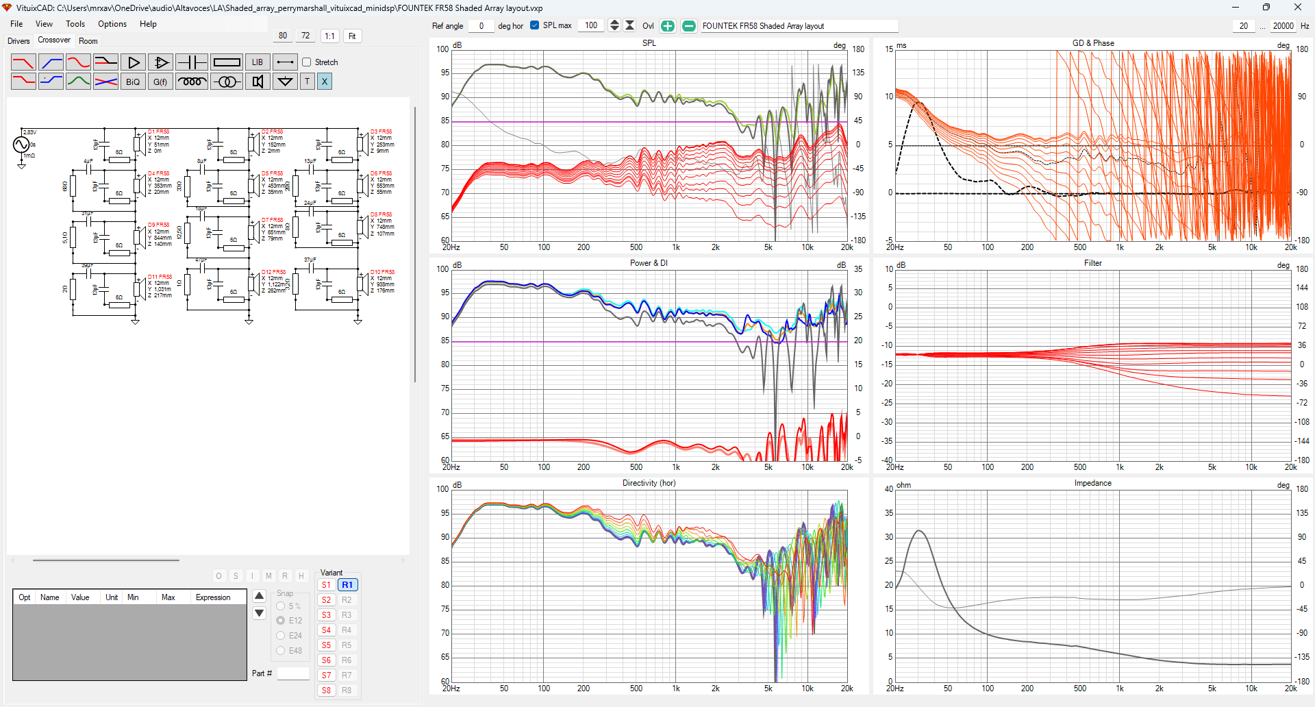

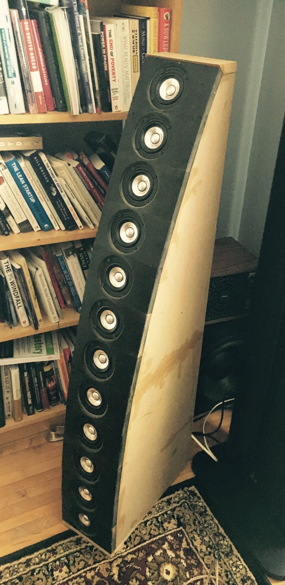

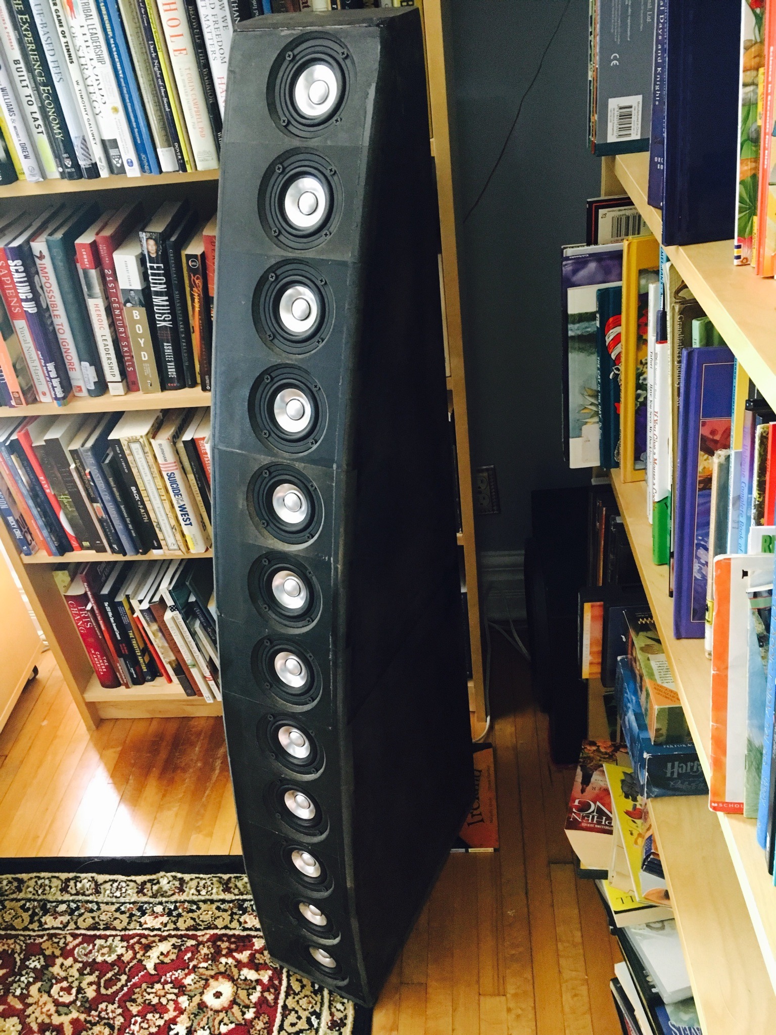

Very interesting & clever design and build.I was always fascinated with “How much juice can you squeeze out of a full range driver?”
In this design with twelve Fountek FE85 3.5” full range units, I managed to squeeze a lot of juice from small drivers, without a traditional crossover. This design achieves High-Definition transparency, deep imaging, excellent impulse and step response, flat phase response. The system comfortably handles 250 watts and plays very loud without distortion.
This design has unique feature: All 12 full range drivers receive 100% signal below 100Hz, sharing the load equally. With DSP EQ they have plenty of bass.
Above 100Hz they shift into Shaded Array mode. Above 500Hz the Constant Directivity radiation pattern is fully in force. This means spooky-good imaging all throughout the room.
Lots of slam even with wide dynamic range percussion recordings.
Totally coherent sound as these full range drivers cover 9 octaves.
Extremely transparent, as the FE85s have very thin light aluminum cones and a light, airy signature sound.

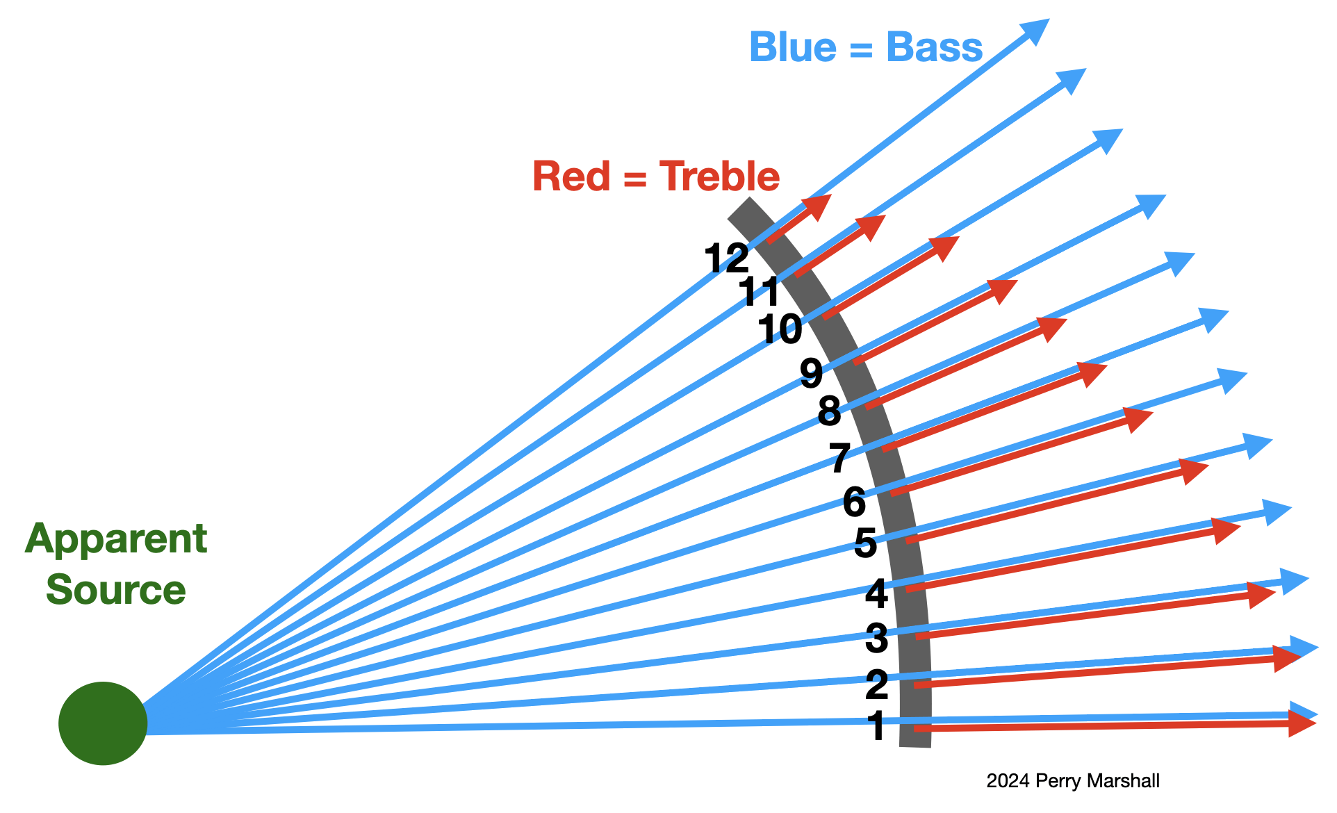

I designed these based on Don Keele’s work, which is patented. I obtained Don's permission to build the design, and met him in person at the 2017 Parts Express competition where I showed them off.

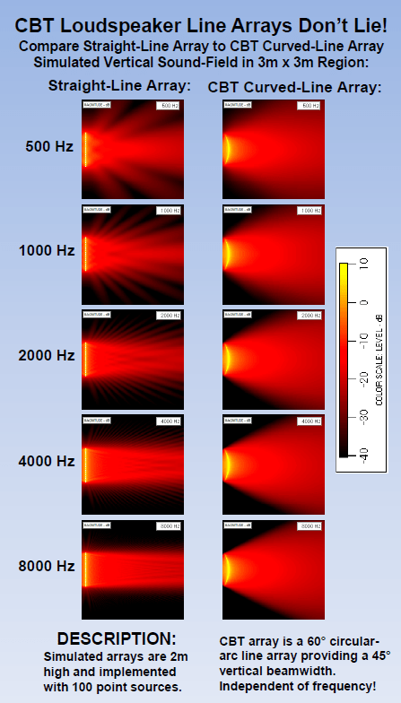

A shaded array is a curved line array where each driver receives a unique signal level according to a Bessel function. This eliminates most of the lobing and comb filter effects of a line array. (Conventional line arrays are notorious for comb filtering effects. You have to use lots of tiny drivers in order to eliminate them.)
In auditoriums, shaded arrays ensure all seats get equal SPLs no matter how far from the speaker. In a home system, a shaded array with the hottest drivers near the floor results in equal SPLs whether you’re right next to the speaker or all the way across the room.
When I invite people over to listen, I ask them to get up and walk around. They’re astonished that the sound level and image doesn’t change no matter where they are in the room. When I host listening parties with a dozen people, every seat in the house is great.
You can stand right next to one speaker and hear the other speaker clearly across the room with a nice stereo image.
The graph below is from Don Keel’s website, it shows even distribution across all frequencies for a shaded array with the hottest drivers in the center. In my design, the floor is the centerline through the middle, with floor reflections simulating the lower half of the array.
Imagine a black dotted line running right across the middle of each heat map above. That dotted line is the floor of the room.
Put your couch on top of that floor and now you can visualize how the sound is distributed throughout the room from the Shaded CBT Array.
This means the hottest drivers are the ones at the bottom, with the signal tapering off as you move up to the top of the array.
This design has an extra twist that I’ve never seen anywhere else, which is: All 12 full range drivers receive 100% signal strength below 100Hz, so they share the load equally.

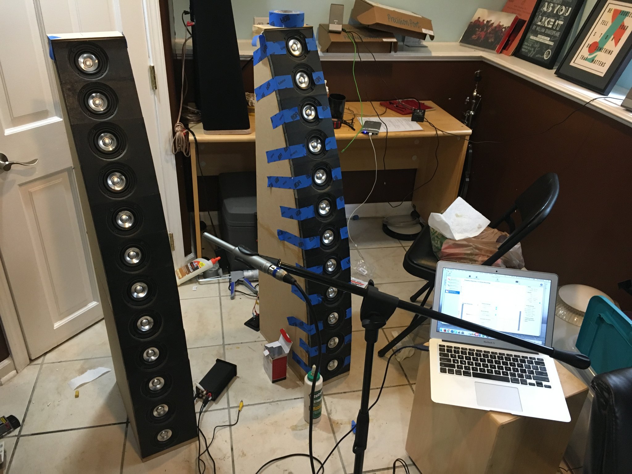

One thing that separates the men from the boys in speaker design is radiation pattern. I like "CBT Constant Beamwidth Transducer" Shaded Arrays because their distribution pattern of sound throughout the room creates superb imaging in every seat of the house. If you stand up and walk right up to one speaker, the apparent source of the sound recedes to somewhere a few feet behind the speaker. You can hear the left and right equally well anywhere you stand or sit.

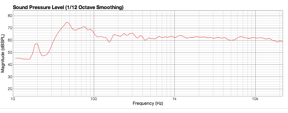

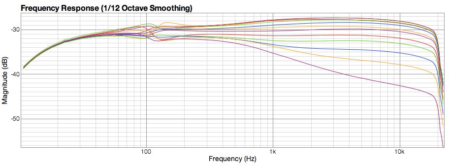

Measurements
This is the system response in my room, average of 18 positions, mostly near the listening spot, with the EQ that sounds right after much tweaking:
As you can see they deliver 35Hz-25KHZ. Of course at listener position in a real room, you want about 10dB more bass and that's exactly the case here.

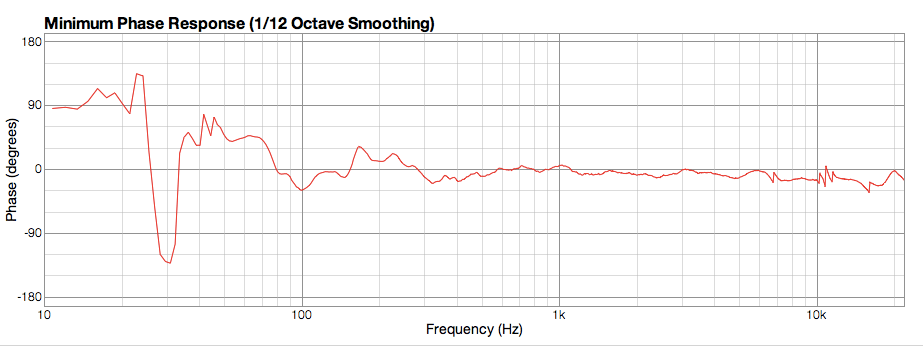

Phase response is essentially flat above 80Hz:

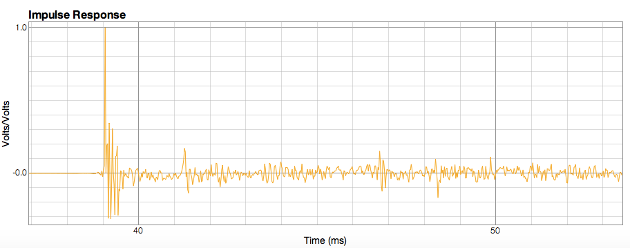

Most speakers butcher Impulse Response. Not these:

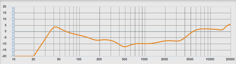

I used a MiniDSP 2x4HD to EQ these speakers flat. Above is the correction curve, which is absolutely necessary because without EQ the 3.5” drivers start rolling off below 150Hz.
The total system has roughly the same output capability of a quality 10” woofer in a bass reflex enclosure. The DSP boosts the signal the the 43Hz reflex tuning frequency and rolls off quickly below that, adding 6-10dB additional headroom at low frequencies. This is a critical aspect of the design, as a 6-10dB gain in LF dynamic range is not trivial.

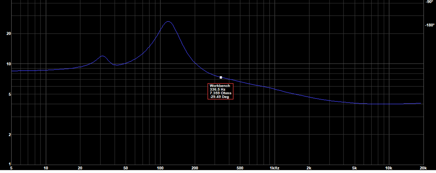

Impedance
They are easy for any amp to drive. You can see in this graph the port tuning frequency of 43Hz and the impedance is around 10 ohms at low frequencies and 4 ohms at high frequencies. These speakers are easy to drive.

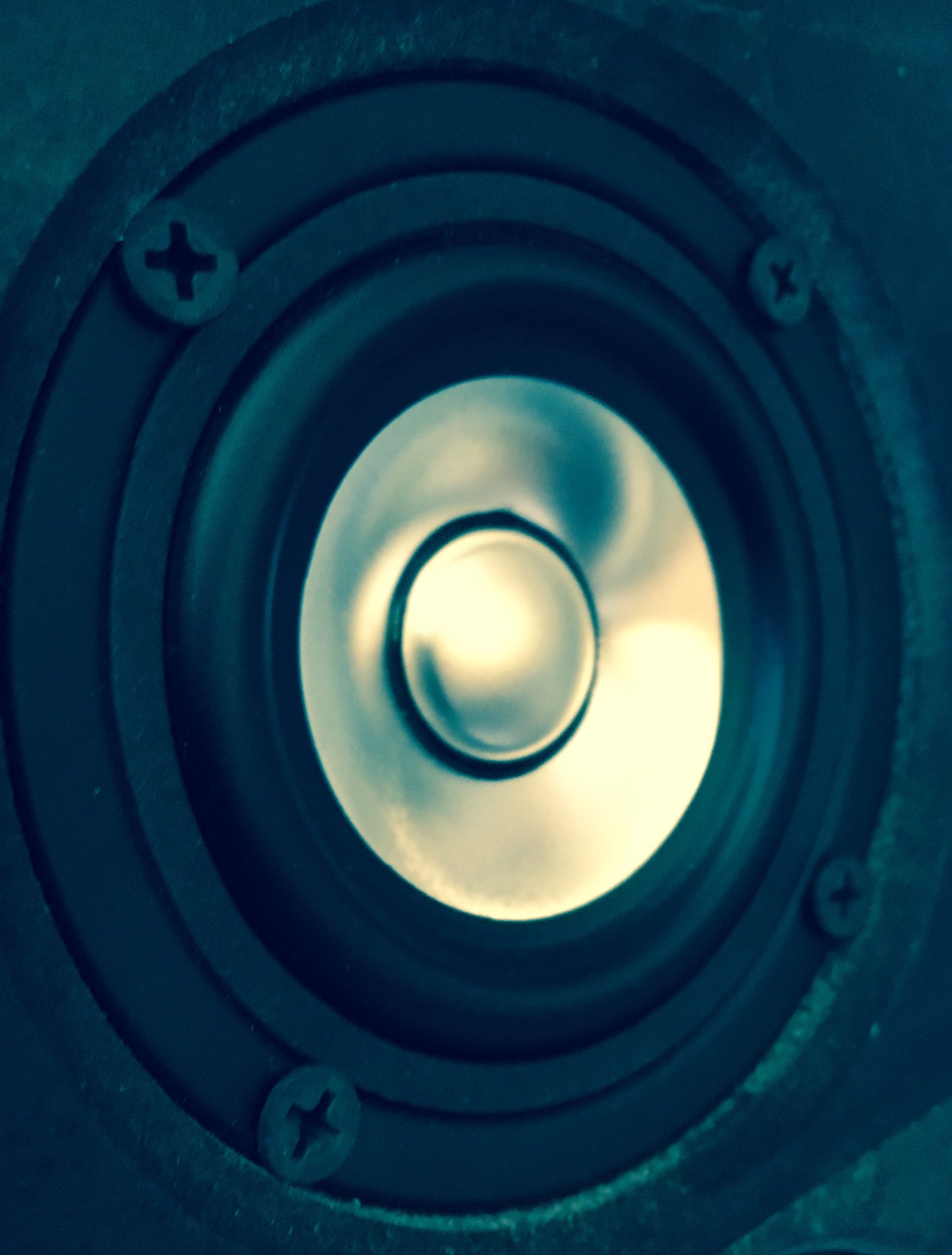

The Fountek FE85 is an excellent full range driver. It has a 3/4” voice coil and very light cone assembly of less than 2 grams. It has a fabric surround which ideally matches the acoustic impedance of the aluminum cone and very smooth response. It has very good high frequency resolution, as good as many dome tweeters.
Individually they handle about 10 watts RMS, so with 12 units per channel and equal power distribution at low frequencies, this system has no problem putting out 110dB+ SPLs in a real room.

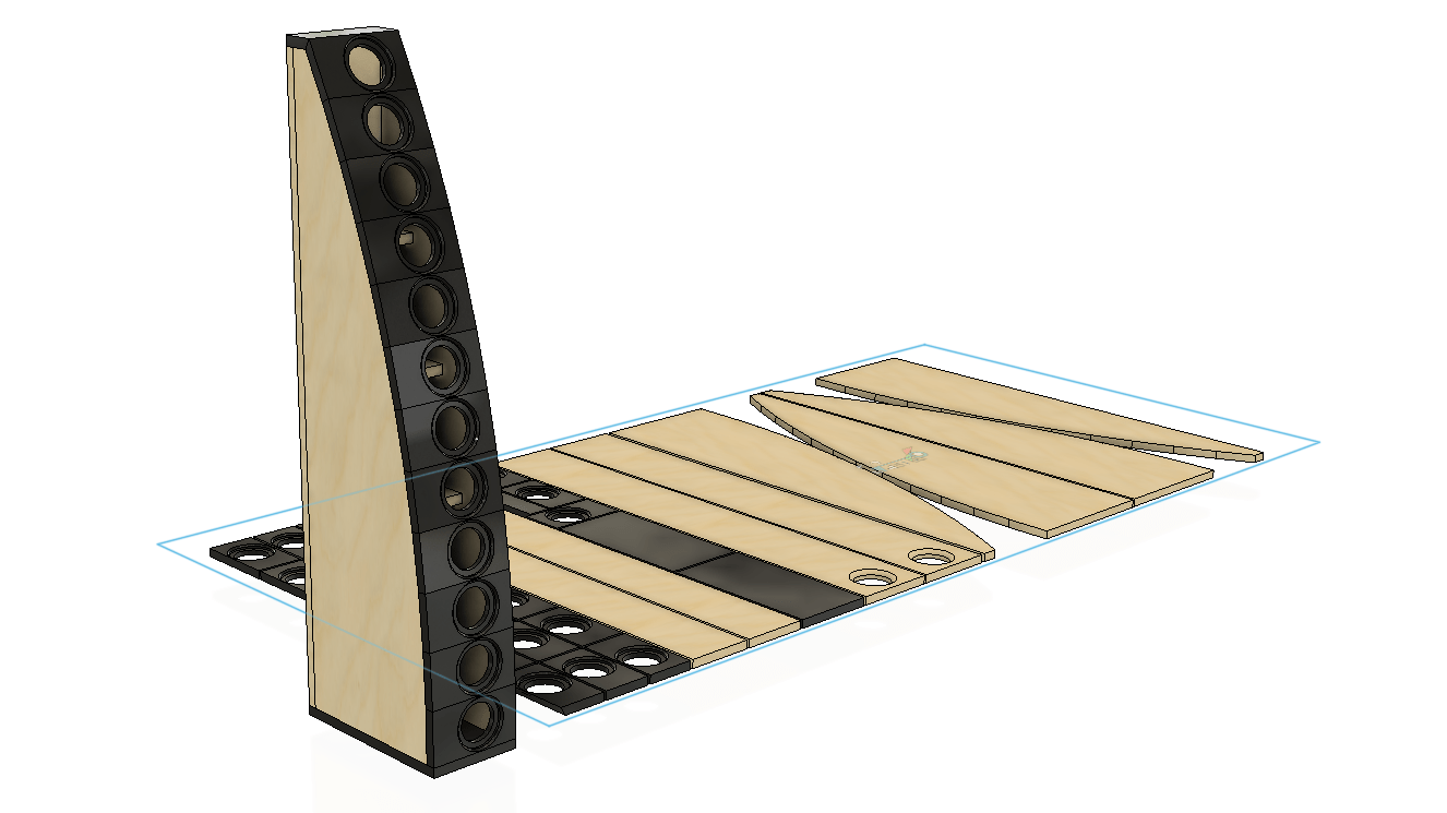

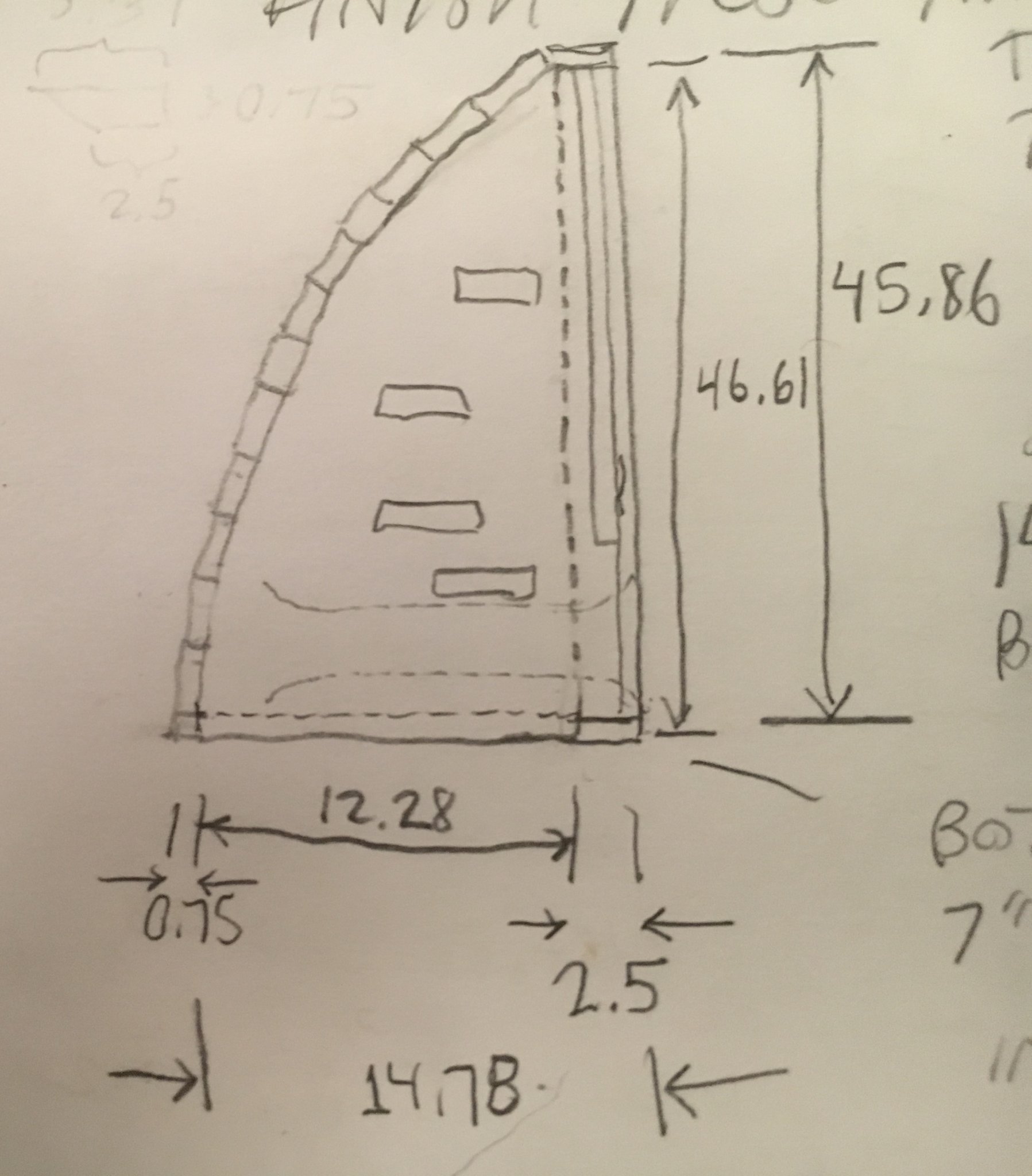

Cabinet details

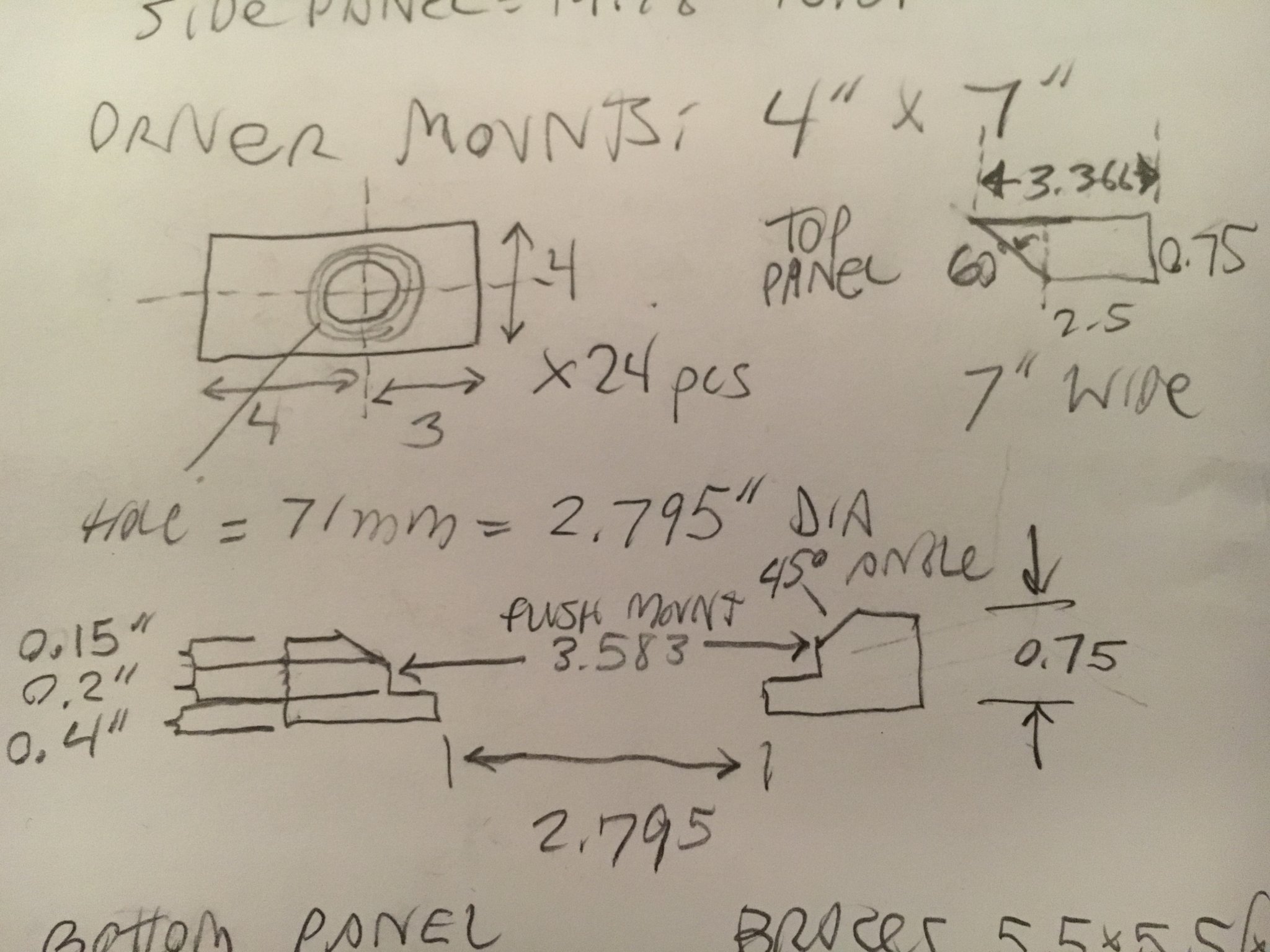

The cabinets are 46” high, 7” wide and 14.75” deep. These are the sketches I gave to my carpenter Joseph Budka, who milled these on a CNC machine:
The drawing below shows the coordinates of each facing surface on the side panel that touches the front panel pieces, along with the angles of each facing surface.

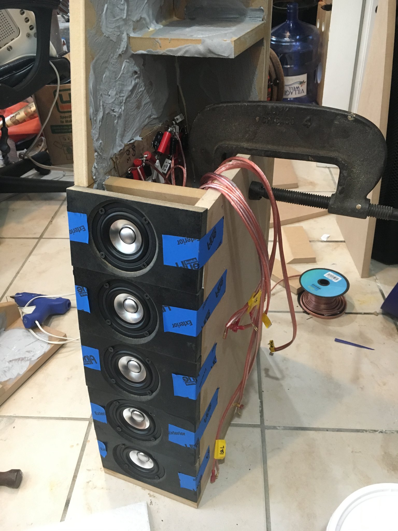

I wrapped them 360 degrees with black grille cloth with an oak wood cap on the top. I used very dark wood stain that makes it almost black.
I took these to the Parts Express 2017 speaker design competition where I got a lot of questions from curious designers. (Coincidentally, the speaker that won the competition was a much more sophisticated 2-way Shaded Array design.)

Good, moved along quickly with the learning curve of simulation.
It is a difficult model to start with and should be great learning experience.
You have learned quickly, very good.
looking at the scribble mess of expected phase.
It appears to be more realistic, and we can see off axis info
In normal speakers, if center to center spacing is tight.
And arranged vertical. Horizontal is easy to make beautiful
and flat. That is the easy part.
Already we can see with many drivers and crossover components
Horizontal response is junk. Not your fault, the concept is nonsense.
For 95 dB of bass and 85 dB of combing high end we could use 2 drivers
and 2 crossover components.
For final deletion switch over to vertical directivity so we can view in sim.
1st orders cant fix the horizontal, and will never ever fix the vertical.
Essentially have added 3x cone area for 9 dB of boost in one area
And 9 dB of cancellation in other areas.
So it needs 9 dB of EQ to fix it.

Well, well, we move on, I understand perfectly that the BB is in another league, I have it in the peephole and components are arriving.
The simulation of the sub box in VituixCAD is a job for the next few days, maybe the weekend, even if it is simulated I like to know and understand what I am working on, that way it is easier or at least there is a reference on the to make corrections.
I have transferred the sketches that you published to CAD, I also have the cutting sheet, initially I want to use 18 mm Baltic birch, both units fit on one board!
If it seems appropriate and with your approval, I could publish the dimensioned drawings and cutting plans to encourage and facilitate construction.

Kevin Kendrick won the 2017 Speaker Design Contest with this CBT design:
10 woofers, 20 tweeters in shaded array.
The path to configuring a closed, open or multi-source speaker has different challenges. That may have a bearing on what we hear about them, but not on their worth as a speaker.That is a contentestable statement. Not something i found true.
I've been wanting to build a line array for years now with some 3.5" driver like the Peerless TC9 or something similar, was thinking at first with maybe 16 drivers for a half way line to save some cash, or floor to celling if I managed to save a bit more of it. I've always know about the comb filtering issues with them but since some people say that it ain't a problem in practice I've been quite positive that those might be the "ultimate" speakers.I was always fascinated with “How much juice can you squeeze out of a full range driver?”
Measurements
Schematic:
This design requires an elaborate filtering network to provide each individual driver with the exactly correct drive signal according to Keel's Shaded Array methodology. Each driver has a Zobel network (6ohms + 13uF) which flattens the impedance and makes behavior more managable.
The wiring consists of three parallel sections of four drivers wired in series. Each driver starting with driver #4 and above also has an RC network which directs extra high frequency energy towards the bottom drivers and less HF energy to the top drivers.
As you can see, drivers 1, 2 and 3 get 3dB extra signal above 1KHz, and drivers 10, 11 and 12 get 10-15dB less signal above 1KHz, with the intermediate drivers getting exactly proportional signals. I am very proud of the above family of curves.

Impedance
Fortunately the FE85 is still available. Plus many great alternative choices are available from Dayton, Tang Band, FaitalPro and many others. As long as you choose an 8 ohm unit, you won’t need to change any of the Shaded Array filter network values. However your DSP EQ will change and anyone with a DSP and a microphone can easily pull that off.

Cabinet details
How do they sound?
The stereo image is deep. The apparent sound source is about 2-3 feet behind the speakers, just as Don Keele’s Constant Beamwidth Transducer model predicts.
I’ve built LOTS of different designs, you can search my screen name on this forum to find more. These are one of the better systems I’ve made, successfully squeezing a great deal of performance out of 3.5” full range speakers.
Resolution is high definition and extremely detailed. The aluminum cones have a slight edge and if your amp is harsh or sounds grainy, that will come through.
“Shaking the house” and full range drivers don’t usually go together in the same sentence, but these deliver. They have a LOT more dynamic range than 99% of full range designs. The DSP Assisted Reflex means that even with songs like “Russia on Ice” by Porcupine Tree, which has a loud 34Hz pant leg flapping synthesizer late in the track, these have no problem shaking the house.
If I were to build these again, I would consider a more expensive high end driver with underhung voice coil. I would be tempted to choose a paper cone instead of aluminum, as the metal cones have a slight edge that can come off hard at times. The Dayton PS95 is a very good choice.
I would also consider an even larger array, using 16 or 18 drivers instead of 12.
VituixCad and MiniDSP 2x4HD files are attached in Zip files.

Yes, there is a reason why I placed the drivers asymmetrically. It’s so the defraction patterns on one edge do not match the defraction patterns on the other edge. It spreads the peaks around a little bit. The front panel is 7 inches wide and the drivers are 3 inches from one side.

Shading always gives you less comb filtering than equal signal to each driver. Keele's work clearly shows this.
https://www.xlrtechs.com/dbkeele.com/CBT.php
See this graphic in particular
https://www.xlrtechs.com/dbkeele.com/images/Card Back Large.png
4" spacing between drivers is obviously less than optimum, but it's the best one can do with a full range driver. I got very little comb filtering effects in my own measurements.
