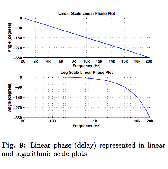

If and when you seen a straight-ish looking phase trace sloping downward, on frequency displayed log scale, like in post #2...
that is simply not linear phase. The straight line must be on a linear freq scale.
True.
In Chris' SH-50 phase plot in #2, looking at 2 octave intervals (rough old eye estimates):
50-200Hz ~330 degrees shift
200-800Hz ~45 degrees shift
800-3200Hz ~20 degrees shift
3200-12800Hz ~45 degrees shift
Smooth, but not linear.
The excess group delay plot also confirms a smooth, but not linear response.
Good enough, once the ragged frequency response is corrected ;)

Achieving a linear-phase characteristic in a speaker system is a high bar. You don't achieve it by lowering the bar.
All you do is cheapen the efforts of those speaker system designers that did achieve it. (And there aren't many.)
I searched/looked all over the Danley Sound website for claims of linear-phase operation. I see none.
Nor do I see any evidence of it from the measured phase plots on the numerous spec-sheets. So, kudos to Danley for that.
