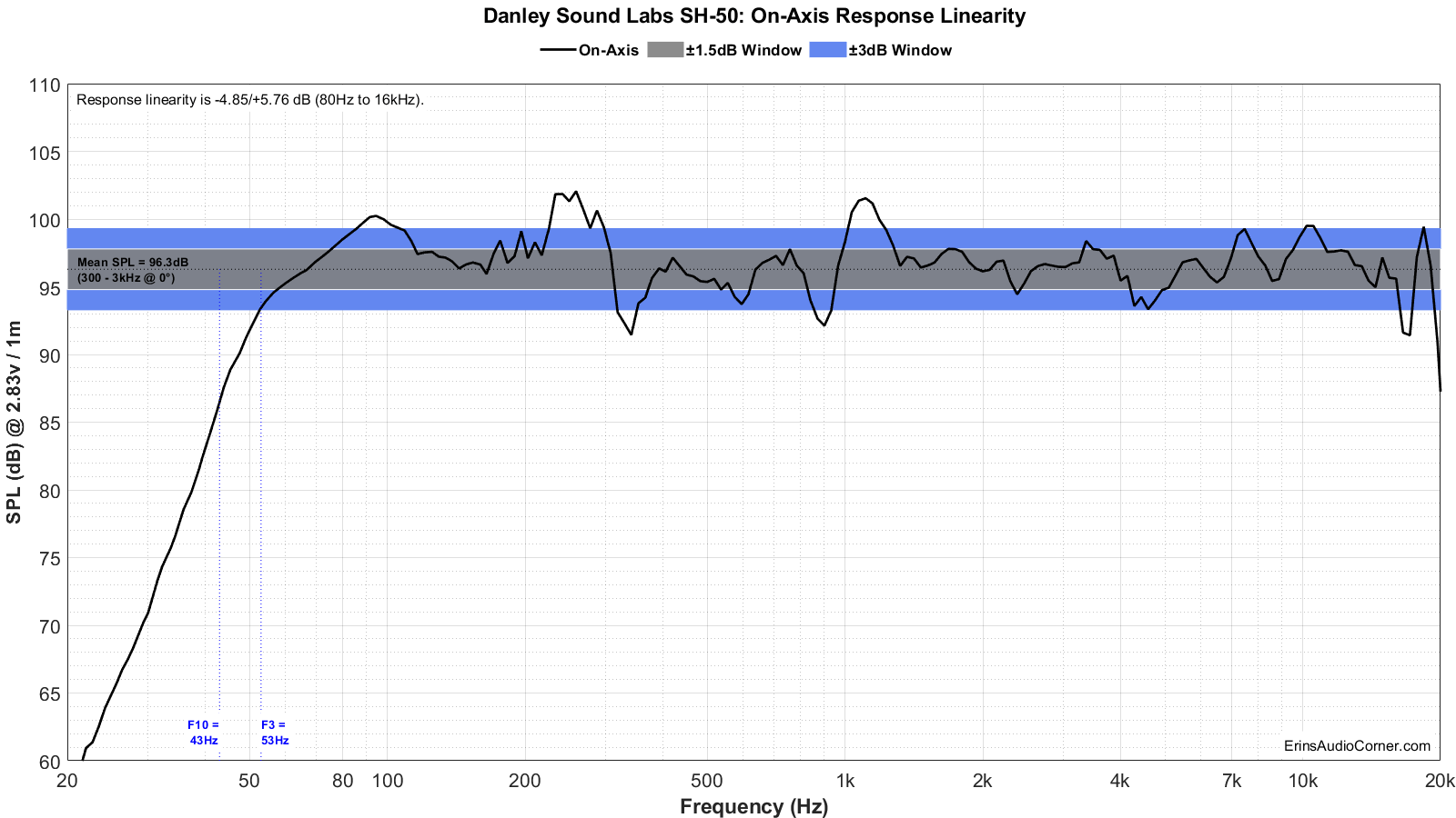

My assessment of the SH-50 passive crossover is that its only shortcoming is achieving ±1.5 dB amplitude response across its nominal 50-20,000 Hz passband (a characteristic which is easily EQed back to that level of flatness using careful EQ upstream). Here is an excerpt from Erin's review using a Klippel NFS (R&D) showing what I'm talking about:
This is nominally in half space/full space (i.e., there are LF effects of having a floor present at the lowest frequencies, but not nearly as much as the full 6 dB of rise in response would suggest). In my listening room in a mid-wall location, the SH-50 exhibits a much greater rise in amplitude response between 60-300 Hz due to quasi-quarter-space loading, and must be EQed flat again.
This is not the case in just about any other passive loudspeaker crossovers that I've encountered. Most passive crossovers usually have other issues, not the least of which is heating of passive components when playing the loudspeaker at "hand volume" (i.e., at or above 90 dB/1m). Other crossovers and driver voice coils simply do not have the efficiency of operation to avoid electrical resistance rise, etc. that plagues almost all direct radiating loudspeakers. Much more can be said on this subject, but I think that the key readers here may be familiar with this subject. You can check Erin's Audio Corner on this subject to see just how immune from heating effects the passive crossover and driver voice coils are. [A warning: I recommend the measurement plots at that site, but not the conclusions drawn by the article's author, which I think are quite off the mark. The Klippel NFS is a good piece of automated gear, however. YMMV.]

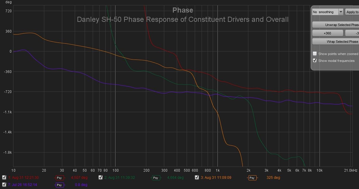

What you see above are the overlays of the individual driver phase responses (compression tweeter = red trace, midrange cones = green trace, woofers = yellow-orange trace) with their combined responses (indigo trace), showing that the output of the SH-50 with passive crossover is minimum phase. I can't tell you how much this surprised this writer when I measured it myself, and began to scratch my head as to how Mr. Danley achieved this result. (What then happened is that I also discovered how to do it myself using DSP crossover IIR filters only.)
Folks, in my experience, this is the actual "secret sauce" of the Synergy series of loudspeakers from DSL over the prior Unity horns from Sound Physics Labs--linear phase using passive crossovers.

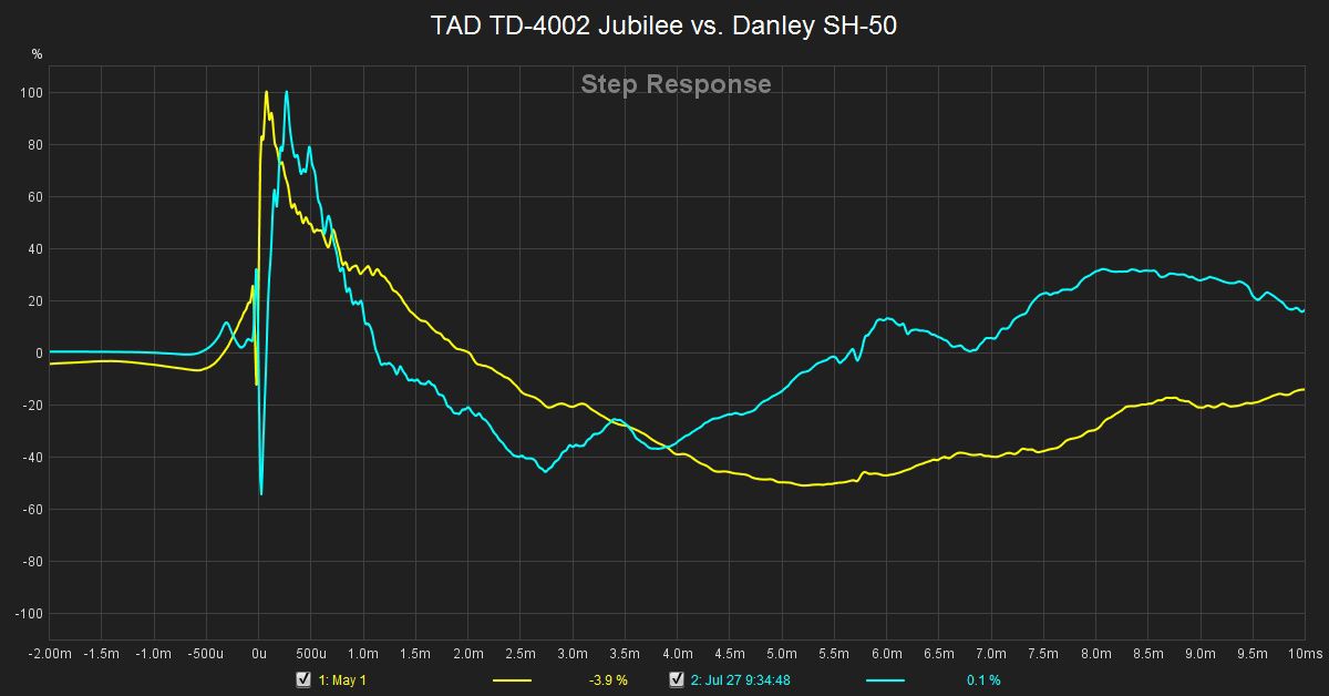

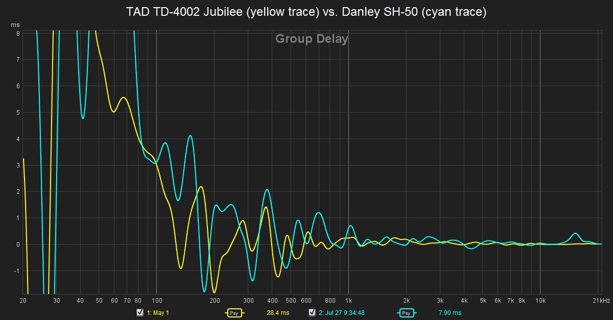

Additionally, you can verify the linear phase argument by looking at the excess group delay plot:
(the cyan trace only) and its step response (again, cyan trace only):
One really doesn't have a driving argument for using FIR filters with this loudspeaker design (passive networks).
