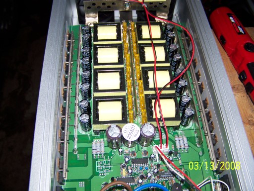

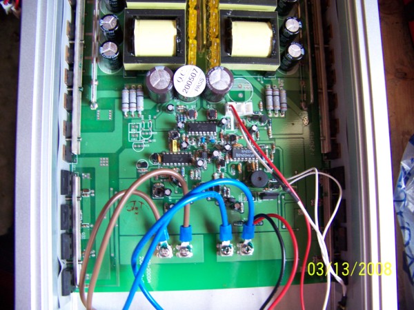

...and here is a pic of the inside. Note the eight (8) smaller xfmrs, whose secondaries are connected in series (thus guaranteeing equal current-sharing) on the high-voltage side. Granted, this is arranged to put out +160VDC (for 120VAC, RMS), but you would change the turns ratios to get the +320VDC needed to produce 240VAC RMS.....
