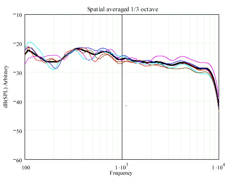

salas said:This one? Has an agreeable ''house curve''.
Yes, thats the one. This was, by the way, many years ago and before I used the three subs that I use now. The low end is much smoother these days and the 200 Hz. dip was the ceiling reflection. I should take some more recent data - but there are a lot of things that I "should do".

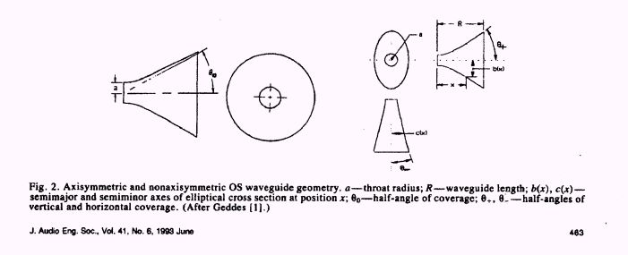

gedlee said:Non-axi-symmetric wavguide won't elliminate the holes in the vertical response. The Yamaha data that I posted was non-axisymmetric. The holes result more from the spatial seperation of the drivers than anything else.
Indeed, however, axiasymmetric provides the potential for a reduced center distance which, according to the Linkwitz formula, moves the vertical nulls further away from the central axis, thereby expanding the available vertical listening beamwidth remaining free of aberrant response.
Further, since the vertical beamwidth is also narrower, ceiling and floor reflections are reduced throughout the rest of the HF response above the crossover region, and what reflections ARE present exhibit a more uniform power response the wider it is possible to space the nulls.
And finally, you suggest that it would be a trivial matter to "fix" the on-axis response anomaly characteristic of axisymmetric waveguides using this approach, obviating the necessity of employing a contrived horizontal off-axis listening alignment.
None of this is news to you, of course:
A critical point to make here about that curve is that it was obtained with absolutely no EQ. I can't overstress enough the importance of this fact and it is no coincidence. If EQ is used to create a smooth "house curve" then the speakers direct field is no longer flat. ONLY with CD is it possible to get house curves like that with a perfectly flat direct field.
