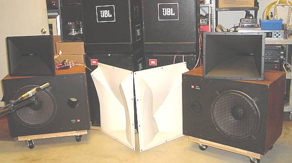

I think this can be achieved with any horn that provides constant direcivity.
It is simply already toed in in the everest horn.
If you take a 4430 (or K2, or PT wave guide, etc.) or a Nathan/Summa and toe them in more than you normally would you achieve the same result.
read the quote from the original paper in this post:
http://www.diyaudio.com/forums/showthread.php?postid=1626246#post1626246

"It is simply already toed in in the everest horn."
Hello POS
That's not entirely correct. The patern on the 2344 is symetrical in the horizontal plane. The pattern for the 4660 horn is asymetrical. You may be able to get another CD horn to mimic the patern using a combination or toe in and directivity but the 4660 type of horn is a different animal. It was specifically designed for this coverage pattern.
Rob🙂

Indeed, there is but one "true" sweet spot, where both level and time cues are correct.
BUT, as the Smith et al. paper explains, the level precedence can override the time precedence within a limited range and the image will remain stable with lateral displacements of the listener. It's a psychoacoustic trick, a "Trompe l'Oreille," as it were, that works so well as to be disconcerting at first, but ultimately, is quite engaging.
Is it perfect? Well, no, and it's better with the JBL defined directivity horns Rob cites (below,) but as Pos suggests, it will work with just about any constant-directivity horn/waveguide in a system appropriately configured to generate the effect. Nothing precludes one from sitting "on center," if desired, of course.
As Earl suggests, if you're not getting it, something is wrong....
Note: The white horns are the 4660/Everest I, not connected. What's playing is H2600/3100 on B380s
