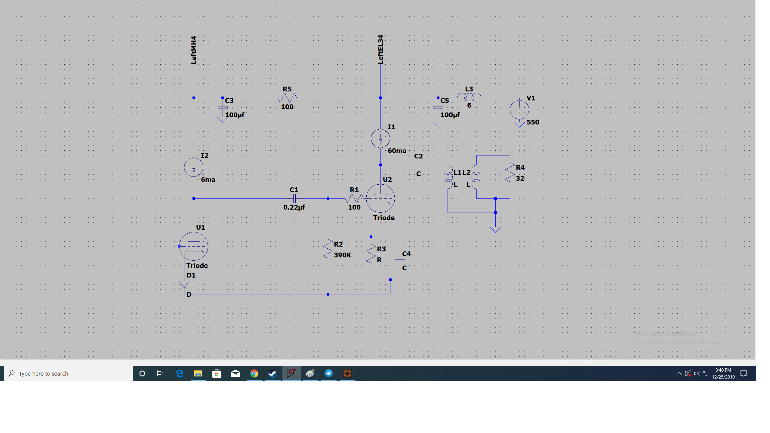

Here is sort of a block diagram of what I was talking about. If you used a parafeed transformer and a CCS on the output, then you effectively shield the audio path from the power supply.
This allows you to have 1 power supply rail with minimal cross talk.
The obvious problem is the higher voltages and the heat dissipated by the heatsink would be considerable.
However if the problems can be solved, then this approach means that the effects of the power supply on the signal path are minimized and you wouldn't have to worry about filtering as much.

Hey TJ - no worries! I have been busy myself, I am still parsing through through some of the suggestions you made. That is an interesting idea, parafeed output is something I would like to use in the future, but this time around I think I am going to stick to the air-gapped output transformer and rather improve on my power supply design to reduce crosstalk. Obviously there were some glaring issues that I'm now aware of, but hey, better to make mistakes before I start building 🙂
.........My understanding is the AC output impedance in a SET amp is roughly equivalent to the ESR of the final cap in the supply, which is 2mOhm....

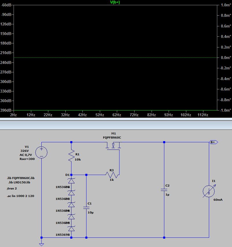

You could build a simple FET serial reg like this. Just run some current through a string of zeners to get a reference voltage. Output voltage is 3V under the reference voltage..

45 Ohm impedance B+ versus a 4500 Ohm primary impedance is 40 dB of separation (at 20Hz with a 175 uF cap).
That is 60 dB separation at 200 Hz.
If you can find a phono cartridge that has 40 dB of separation at 20Hz, and 60 dB separation at 200Hz,
then you have found a miracle product.
Let us know the cartridge model.
Try and find a record cutter that has that kind of separation.
