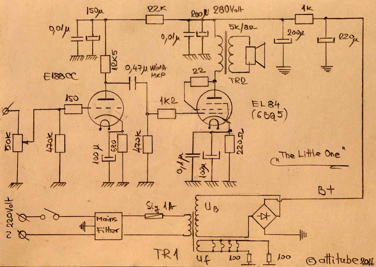

El 84 SE triodewired
I can recommend this tubeamp. 1,5 w class A, triodewired. Have a pair of Klipsch RF 15 and pair of Klipsch RP 160 M. Great amp and gives enough power for my Klipschspeakers! Easy to build!! Hammond transformers.
