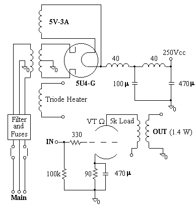

I sold my tube amp and want to build an SET to go with my Klipsch La Scalas. I used to be an electronics tech and can build from a schematic, and have done so many times.
Not looking for a kit, just a schematic that works. I thought of the Decware Zen but the schematics I found on line just don't look right.
There are plenty of good SET designs out there, can anyone here recommend one?

this one: my CELLINI triode amp
was supposed to be a ‘starter’ amp, my first tube amp. It used not so fancy parts, a bit of a tinkerer’s odd ball amp. But today, more than a decade later, it’s still my best tube amp.
You’ll get suggestions for way better amps, much more popular etc. but I thought I’d throw this one out because it is one of those under-estimated pleasant surprises. Not so long ago it went up against a SIT amp into a pair of MA Alpair 10.3’s and came out remarkably well.

Klipsch La Scala speakers are 105 dB. sensitive. The 2 WPC triode wired "12" W. multi-grid power tubes yield is plenty.
What might be an issue is damping factor. I'm thinking a linear (unbypassed cathode bias resistor) EF86 pentode voltage amplifier DC coupled to a ZVN0545A source follower (for isolation from O/P tube CMiller) cap. coupled to the "final". Add "plate to plate" short loop NFB, for increased damping factor. Definitely use good quality O/P "iron".
The EL84/6BQ5 and its relations make good triodes, but the 6V6 family makes even better triodes. For this power range, it has been said that #45 DHTs are needed to best trioded 6V6 family tubes.

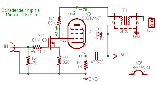

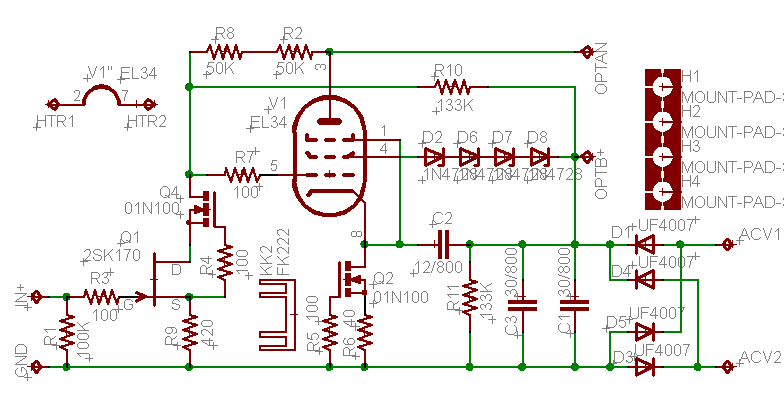

I mocked up an AC coupled, cathode biased version of Michael Koster's Schadeode so that I could easily test different tubes by changing the cathode resistor and the screen grid zeners.
https://www.diyaudio.com/forums/tub...tial-feedback-se-amplifier-2.html#post2710121
The plate to grid feedback is 98% by my seat of the pants calculations.
I tried the Rev1 circuit with 6L6WXT+, 7581, Philips top cap 6BG6GA EH 6CA7, 6CB5A and 6P20S, 26LW6 and 4D32.
The lower PD tubes produced 1 watt with midband distortion at 0.15% or lower, 8 watts at 1% and 10+ watts at 3%.
The higher PD tubes all performed better than this. The 26LW6 produced 1 watt at 0.1% distortion and 14 watts at 3%. The 4D32 produced 1 watt at 0.08% and 15+ watts at 3%. I only operated these tubes at 80% and 75% PD respectively, because my bench supply only produces 550 volts and my transformers were rated for 80ma.
After these tests I ordered a handful of 6LW6 tubes and intend to build a stereo amp with them. I intend to use the Rev2 circuit for this amp.

I should add that I performed these tests with Bud Purvine and James 5k ohm transformers. I could get more power from the 4D32 using the the 3.5k tap but it was not needed. My speakers are 95+DB efficient.
I tried cheaper transformers and got less power and higher distortion.
I used triode wired 6V6s in a bi-amp system and really liked them. So, I tried a JJ 6V6 as well. I got 2.4 watts at clipping and higher distortion overall.
Except for the 4D32 all the other tubes were acquired for $20 or less so the 6V6 is not even an option for me.
Steve
