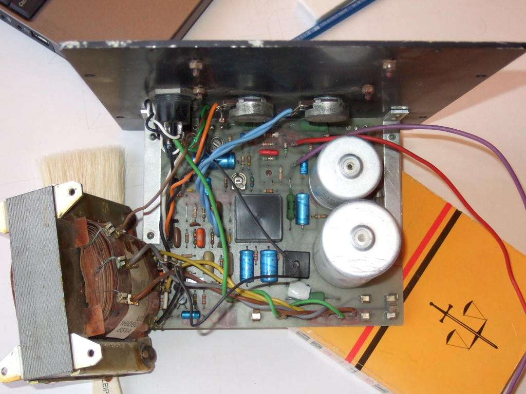

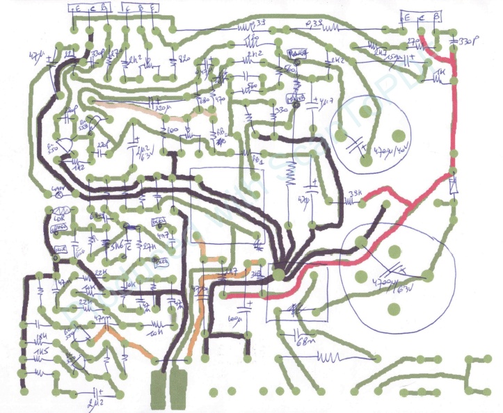

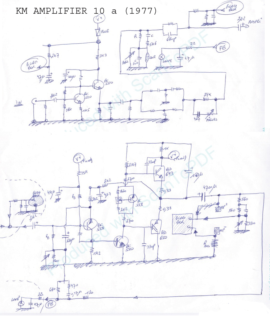

KM Amplifier 10 a dating back from 1977.
See attached files.
There is a black box receiving power supply and ground. Such black box may thus contain active elements like transistors. There are two input ports on the black box : one receiving an image of the speaker current, and one receiving an image of the speaker voltage. There is one output port on the black box, delivering the feedback voltage.
There is a lamp + LDR combination managing the low frequencies amplitudes. At low frequencies, the LDR has the capability to short circuit a capacitor to ground, hence decreasing the low frequencies amplitudes. Note how the output signal gets lowpass filtered before feeding the lamp : as consequence, such short circuit only happens when there are powerful bass at the the output. This seems to be the protection against excessive speaker excursions.

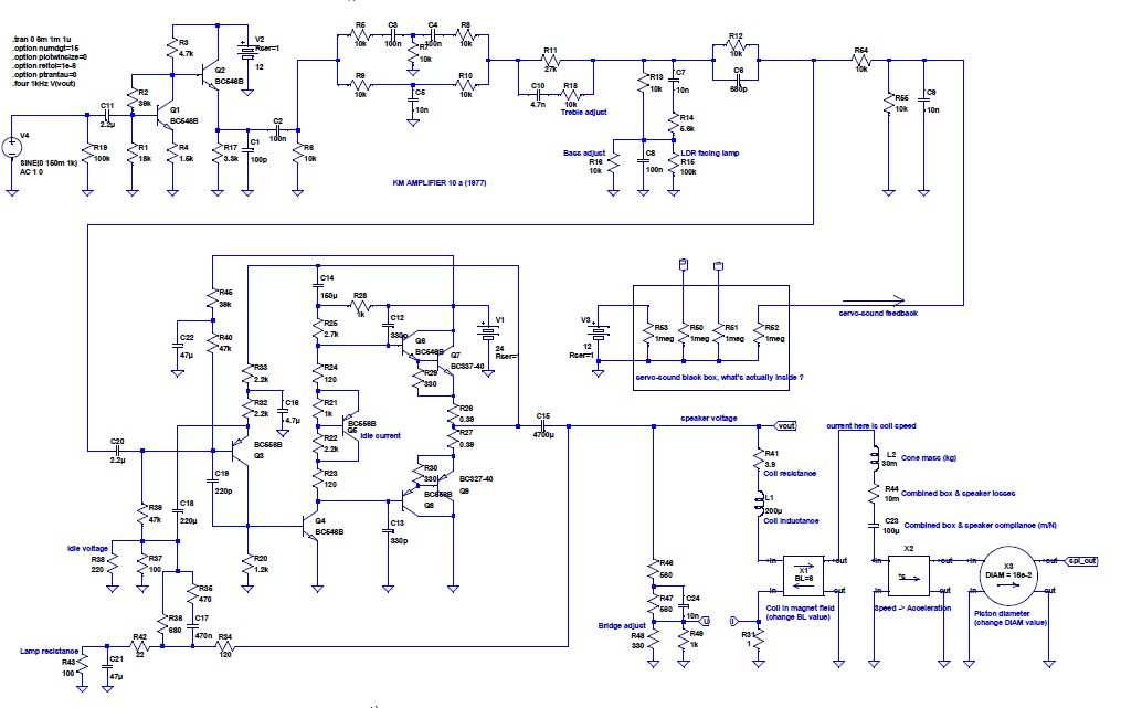

Hi
The files from msg #42 for example.
i am able to run a few simulations if I remove some steps it seems to enable the convergence of whatever the LTspice is doing but for the file Servo-sound and servo-sound equalized I cannot get a convergence.
If I could get it to work I could share a Matlab routine to do genetic optimization of the parameters (box volume feedback loop filter parameters with target curve etc.).
Mickael
The files from msg #42 for example. I am able to run a few simulations if I remove some steps it seems to enable the convergence of whatever the LTspice is doing but for the file Servo-sound and servo-sound equalized I cannot get a convergence. If I could get it to work I could share a Matlab routine to do genetic optimization of the parameters (box volume feedback loop filter parameters with target curve etc.). Mickael
The files from msg #42 do refer to specific components embedded in my custom library named "my_own_npn_pnp_bjt_v402.lib". Surely you have not asked LTspiceIV to use "my_own_npn_pnp_bjt_v402.lib". So, on your side, LTspiceIV doesn't know about the power transistors used. If you are new on LTspiceIV, you better not use the files from msg #42 as they contain a complicated hand-made opamp model using discrete transistors. If you are new on LTspiceIV, you better not use the files from msg #42 as they contain a complicated hand-made power amplifier model using such opamp as front-end plus some discrete transistors you don't find in the LTspiceIV default library.
You better start from msg #60. Over there you have files forming a simpler foundation for what you intend to do. There is no custom library needed. The opamp model and the power amplifier are much simpler. Actually they are the same, basing on a Laplace function definition without any current & voltage limit.
Using the files from msg #60, invest some time in adding the required feedback for implementing a servo-sound arrangement. I can help you if you want.
The files from msg #60 also contain some Monacor speaker models you can use. You may need adjusting the internal loss parameter, depending on how much fiber you put in the box.

KM amplifier 10 a (simulation v0.1)
see attached files
need to know what's inside the black box
need to put the right R and C values in the input equalizer

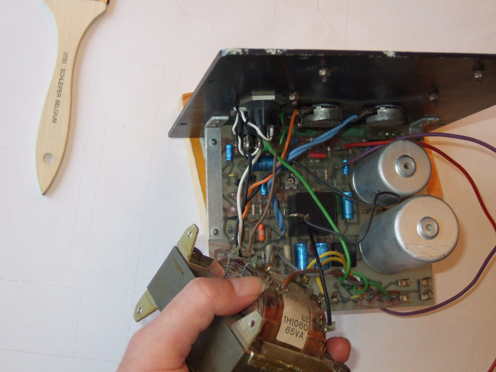

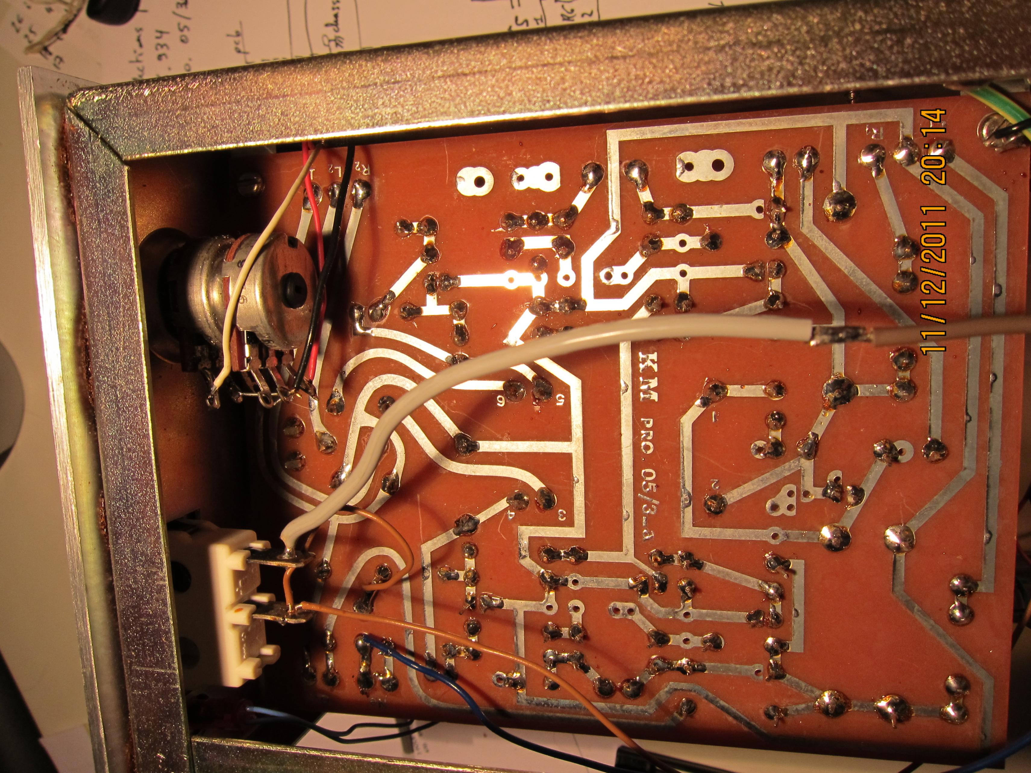

a few more pictures concerning the KM amplifier 10A

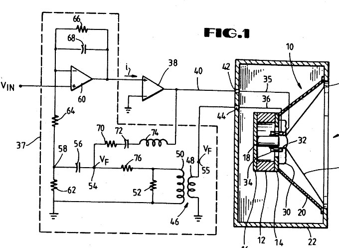

Before sending a whole unit, it would be interesting to "virtually regenerate" the four patents filed by Louis W. Erath, using LTspice simulations.
1) the US3449518 patent filed 1965 Sept. 15 about current drive, special feedback networks and optical feedback for bass reinforcement at quiet listening levels (did KM ServoSound got some inspiration from this ?)
2) the US3493682 patent filed 1966 Nov. 21 about a new standardized way to connect a loudspeaker to a power amplifier outputting a voltage (the speakers contains the required frequency compensation network, that the amplifier uses in his feedback loop - now tell me what's happening in case of long unbalanced wires ?)
3) the US3497621 patent filed 1967, June 19 about more refined optical feedback circuits for extending the bass boost at quiet listening levels (did KM ServoSound got some more inspiration from this ?)
4) the US5086473 patent filed 1989, Nov. 27 about a feedback system for a subwoofer using current in the feedback path, and a RLC series network also.

Viewed from here, the most appealing circuit is the one disclosed in the US5086473 patent filed 1989, Nov. 27.
Being filed in 1989, it comes after thousands and thousands of KM ServoSound systems sold in Europe. Most people will then infer that such patent is worth nothing.
Actually such patent has a high value to my eyes because unlike the KM ServoSound, we find no additional active components. The whole equalization gets done using passive components, and I find this very reassuring, very refreshing compared to the Linkwitz Transform (pre-equalization requiring one opamp), or compared to some complicated feedback requiring opamps, attempting to operate as "velocity feedback" (see JC Bodot "Zippy" in France).
Concerning the US5086473 patent filed 1989, Nov. 27, there is something unclear to me. Is the power amplifier (#38) a conventional power amplifier outputting a voltage, or is it supposed to output a current ? Why is it represented as distinct from the differential input stage (#60) ? Let us read the patent text : "A current signal is delivered to the drive coil (#34) by a broadband audio amplifier (#38)."

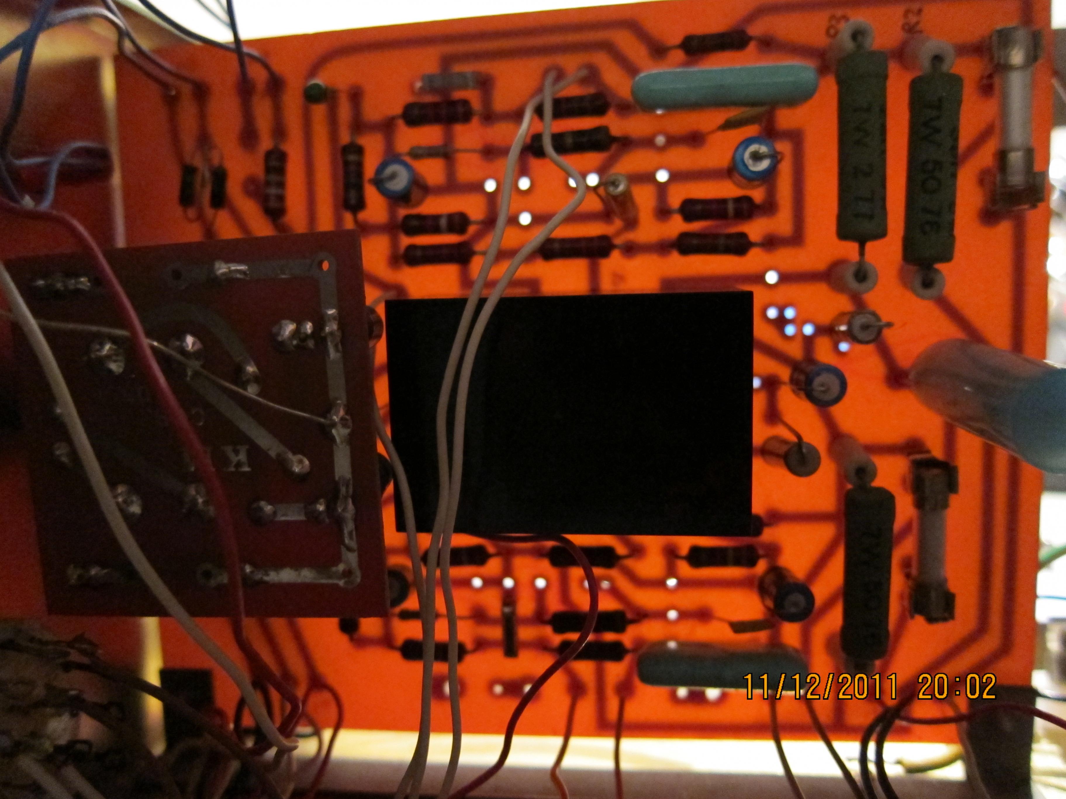

Hello steph,
I managed to find out what is in the blackbox of the air preamplifier. The box is made of resin or epoxy. I googled and find out that aceton would deluate the resin or epoxy. Indeed it worked, if you let the blackbox one hour in the aceton, you can scrape off the epoxy. It is a long process but worth doing it. I found 4 resistors, 2 electrolytic capacitors and a 3 piece coil. The aceton made the blue surrounding of the capacitors unreadable. I used a esr/ capacitor meter to find out the cap values.
Hopes this helpes.
I noticed you are from belgium ? Well i am.
Peter
Great! What blackbox are we talking about? KM amplifier 10a or KM amplifier 15b?
blackbox
Hello,
I'm talking about the one that is the pre-amplifier ( see attached fotos) BUT my description will help you to find out what is in any blackbox ( servo sound , KM )
Detail : the blackbox is just plastic and is surrounding the epoxy.
If you squeeze the plastic , it comes off, and shows you a brown epoxy box.
Also interesting : on the KM-52 speaker , there is no blackbox on the double-sided pcb !!
