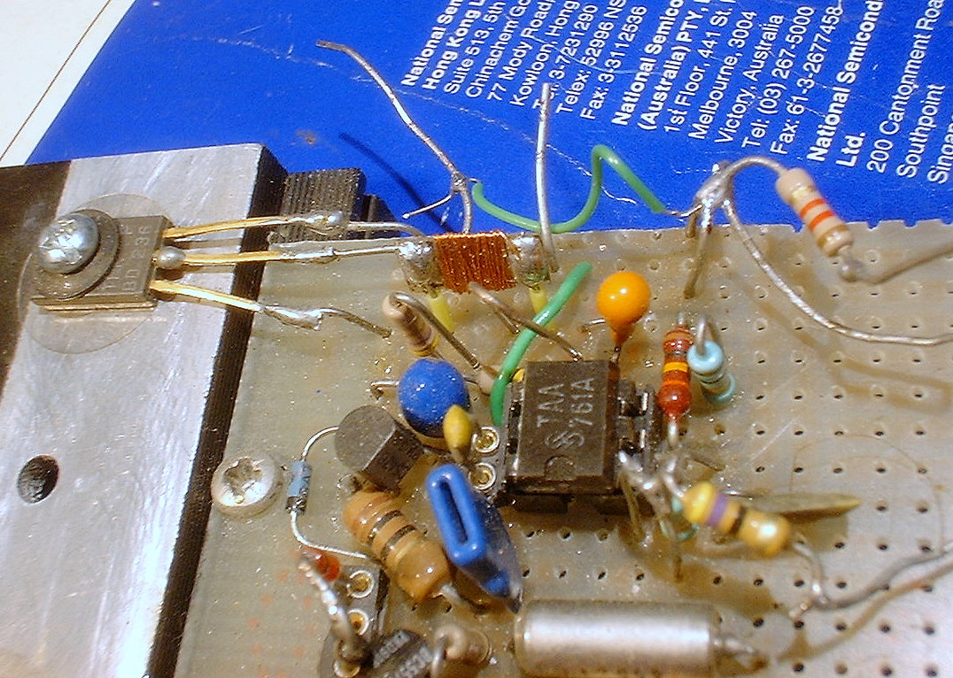

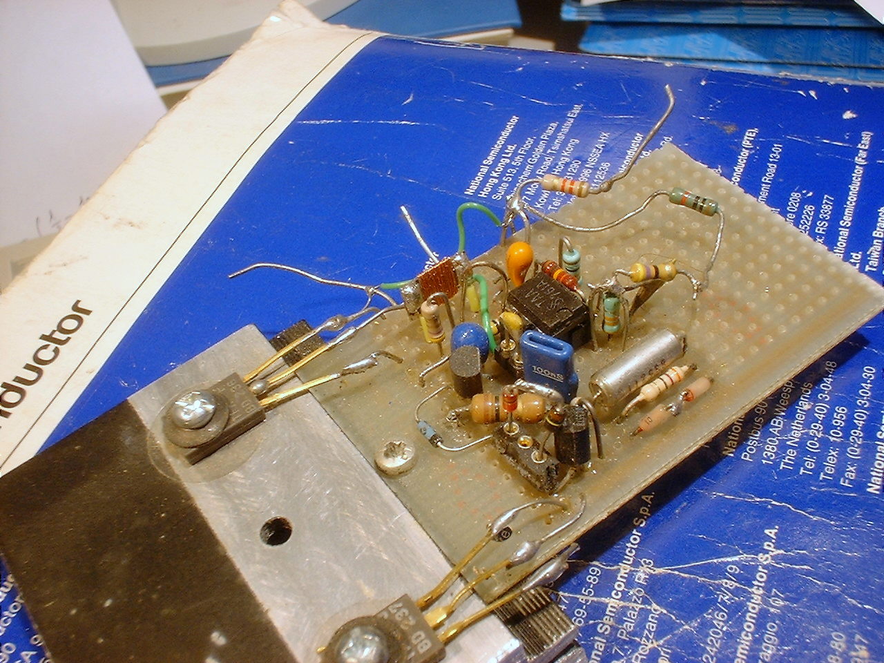

The two pictures could give you some clues about the insides of Servo-Sound "black box": it is a thermal image shunt.
Unfortunately, I don't understand. Is a less cryptic description available ?

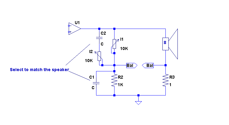

There is a simple experiment that will convince you to the contrary:
You just have to put your speaker in a bridge arrangement.
Make the measurement at 50Hz f.e. You balance the bridge for a low power level, 0.1W.
Then, increase the power to 10W: you will see the balance go away.
Once it is settled, you can rebalance it, but you won't be able to remove the residue completely: harmonics will remain.
If you want to remove mechanical effects from the test, you can repeat it with the voice coil immobilized: you will still get non-linear effects, meaning thermal effects are to blame.

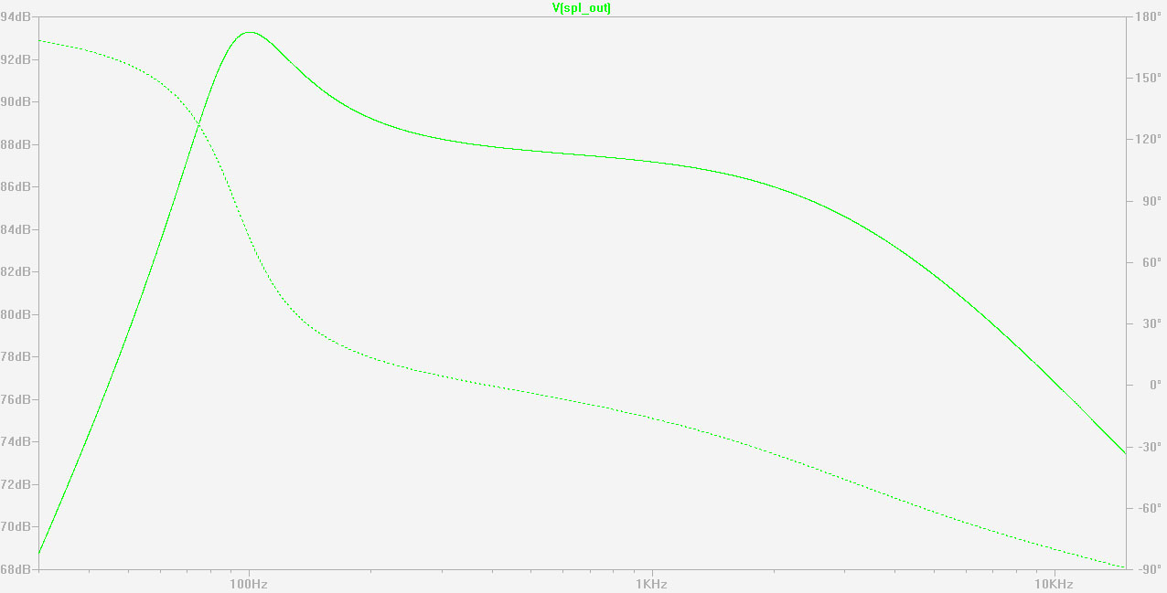

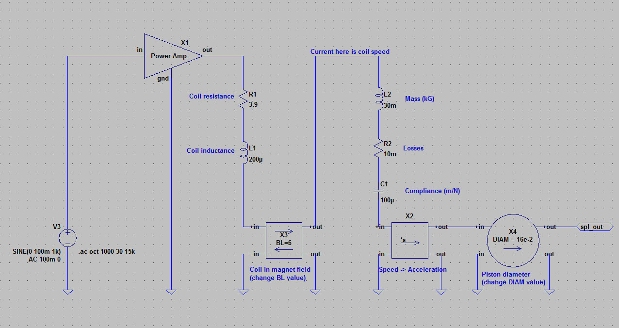

For modelling the speaker driver in the closed enclosure, I suggest we use the intuitive good old way, so everybody will be able to understand what's going on. No need to refer to the Thiel-Small theory. LTspiceIV will in fact illustrate the Tiele-Small theory. With the advantage of being able to focus on the back EMF (motional voltage) extraction.
1 - The coil mechanical force is proportional to the instantaneous current in the coil. This relation gets represented in our LTspiceIV model using a current controlled voltage source. The resulting voltage is thus the instantaneous force.
2 - This mechanical force tends to create a mechanical displacement of the coil. If the system has a mass, the force creates an acceleration. If the system has a compliance, the force creates a displacement. If the system has imperfections, the force dissipates. A real loudspeaker driver embeds those three components.
3 - In our LTspiceIV closed box model, if we chose the coil speed as operational variable, the coil speed is equivalent to the current (not a physical current, but a current flowing somehere in the model) flowing through the mass + compliance + dissipative element put in series. You need to think about this deeply : why do we arrange those three components (mass, compliance, dissipation) in series, submitting them to a same "current" which is the voice coil speed, with an global voltage on them that is the voice coil force. You may say that point 3 is like entering in religion, but if you think twice you will see that there is a physical reason for designing the whole thing this way. This kind of reflexion will help you understand, later on, why and were we need to add components like in a 4th order bass reflex box, or like in a 4th order dualchamber box.
4 - Very fortunately in such conception, mass is equivalent to inductance because high frequency voltage = high frequency force, so it means less current through it = less mechanical displacement. Dissipation is equivalent to resistance. Compliance is equivalent to capacitance because with coil speed being the current through it, by integrating the coil speed over time you get the excursion, and the excursion is of course proportional to compliance.
5 - There is a back EMF generated proportional to the speed of the coil. So now you understand why above, we selected the coil speed as operational variable in our LTspiceIV model. This relation gets represented in our LTspiceIV model as a current controlled voltage source.
6 - This resulting back EMF voltage source is wired in series with the source voltage (amplifier output), with the correct sign. There is your "motional voltage", actually.
7 - After all this being said, one should remember that the acoustic pressure is not proportional to the coil speed, but proportional to the coil acceleration. So if one wants to draw SPL diagrams, one needs to differentiate over time (speed/time) the "current" flowing in our LTspiceIV model. We will thus need to create a "p" or "s" LTspiceIV subcircuit.
8 - And now, because you know both the acceleration of your membrane, and the size of the radiating surface of your membrane (piston surface), you know the instantaneous acoustic pressure. Without needing to read Thiel-Small litterature, but using the same language and variables as Thiele-Small.
Actually, this is Thiele-Small explained in plain english, with LTspiceIV doing the maths.
I let you think about this, so you can make up your mind.
Next week I will post the correspondent LTspiceIV schematic for a loudspeaker driver in free air.
Immediately after, we will see how compliance gets reduced when mounting this loudspeaker driver in a closed box. This is an application of the physical law of gases saying that Pressure x Volume = constant. As a result, we'll get the LTspiceIV model of a closed box loudspeaker.

Attached you will find the continuation of post #30 about modelling a loudspeaker in fee air, using LTspiceIV.
See the attached pictures, and enjoy !
Steph
  • Loudspeaker in free air.zip
Congratulations steph, this looks excellent. And useful too.
You render a great service to all the community.
Thanks!
