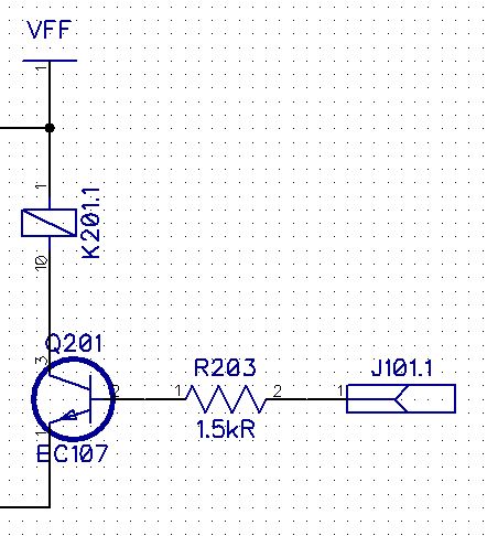

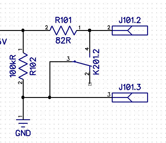

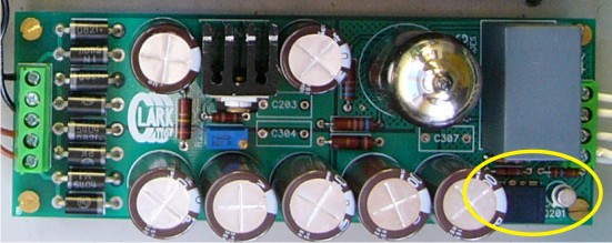

The main player I'm listening to right now is a Rotel RCD-855 (another SAA7210 > SAA7220 > TDA1541A based player) with an aftermarket output stage of my own design. This output stage uses a muting relay is exactly the same way a stock player uses a muting transistor, that is it shorts the output to ground during powering on and off.
Circuit description (see pictures 1 and 2): J101.1 is connected to the KILL or MUTE signal on the mainboard (test point 93), which goes to the base of transistor Q201 through base stopper resistor R203. This causes relay K201 to become energized when the MUTE signal is high. K201 then closes and shorts the output to ground.
You can see the output stage in the third picture, the muting section is circled.
This circuit presents no capacitance to the signal, and is about 95% as effective as the transistors. It works well for me!

I think the capacitance of the transitors is greatly overestimated. That is a circuit with 200 ohm impedance (usually) - the CE capacitance makes no difference in 0-100kHz range. Non-linear or linear... Otherwise, those transistors won't be able to work at MHz that are specified in the catalog.
As a curiosity - does you relay "flip" between the discs change or between songs? I never measured when the "kill" signal comes on.
I guess a reed relay is fast enough for the job.

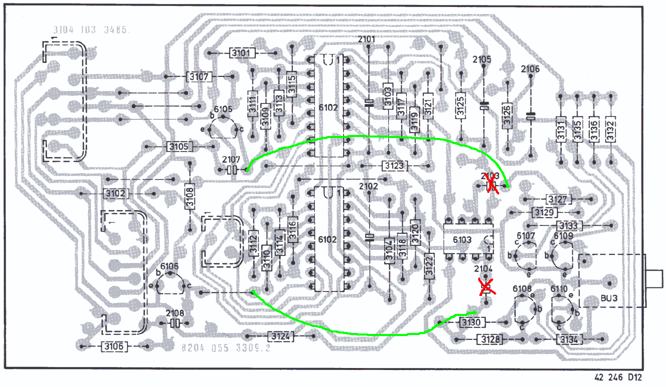

Using SoNic_real_one's recommendation, I did a bit of work to the RVC board.
I removed the 4 100uf NP caps, replacing the first pair (C2107/C2108) with a pair of low ESR Panasonic 330uf/25V caps (bypassed with .01uf Panasonic PPs) that I had in stock. I mounted them with the (-) towards the output. I then jumped to the indicated pads using 22ga 5n silver solid wire that I had on hand, insulated with teflon tubing (I didn't have any small gauge shielded wire around-I'll have to do some shopping). As I'm not in a very RFI rich environment, I've not noticed any problems.
The sonic difference was night and day--and that's an understatement.
I didn't pull the muting transistors yet-that's next. I want to let the new caps burn in first.
Thanks very much for your advice.....
Dan
