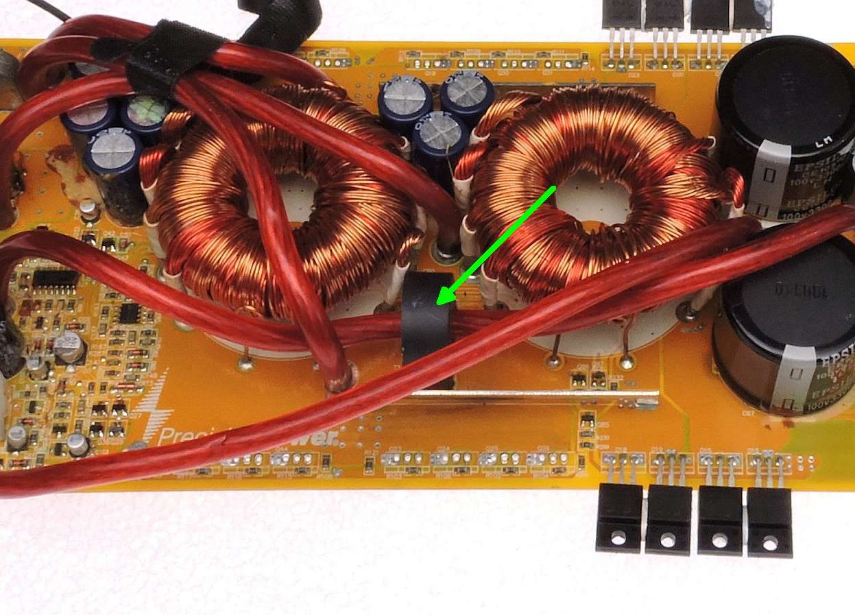

Because Q14 and Q87 are removed, the amp is not going into protect at any voltage. Pin 16 stays at 0.006v when the PS voltage is 14.0v

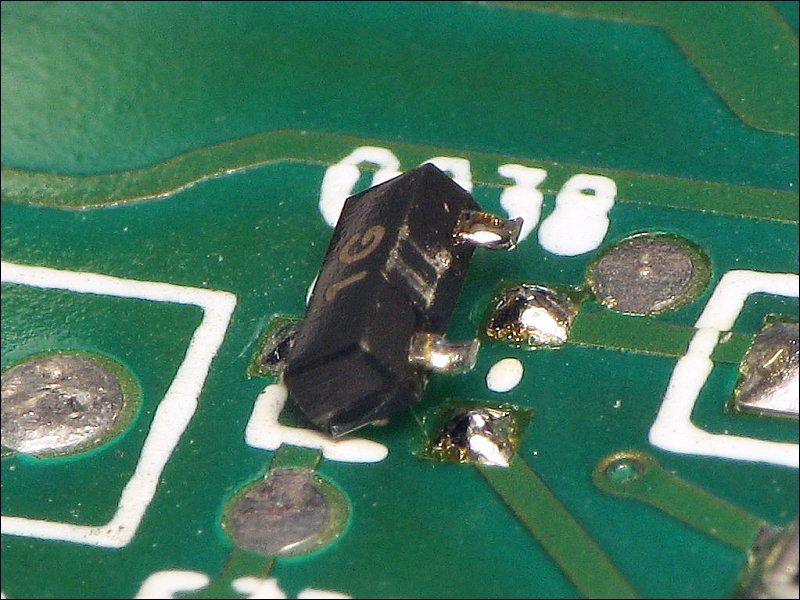

Reinstall those transistors, one at a time, to see if either causes the problem to return.
The voltage on pin 16 may pulse so you need to monitor it with your scope.
You say 'removed'. If you mean completely removed, lifting is easier. See attached.
When lifting Q13, the amp is not going into protect.
Both Q14 and Q87 installed
So strange. I replaced Q13, then it powered on just fine at 14.4v. After 20sec it went into protect.
Now it always goes into protect directly after powering on (with all transistors in place).
When the amplifer has been turned on without transistor Q13 or Q14 it doesn't go in protect, If you connect Q13 it goes in protect again when the amp is at 13v

Bertje, C44, R101 (reads 10.05k) are OK. C42 fell apart when desoldering. I try to find a new 1nF SMD capacitor.
Perry, There is no TL074 in this circuit. Only a TL074C and a TL072 which are both placed on the right side of the output pwm driver card. The CT is connected to PIN 3 and 5 of the TL074c
Look like the C42 was the problem 😀
I could not find an exact 1nF capacitor, so I replaced it with something as close to the value I could find.
The amp is powering on just fine now, no protection anymore.
