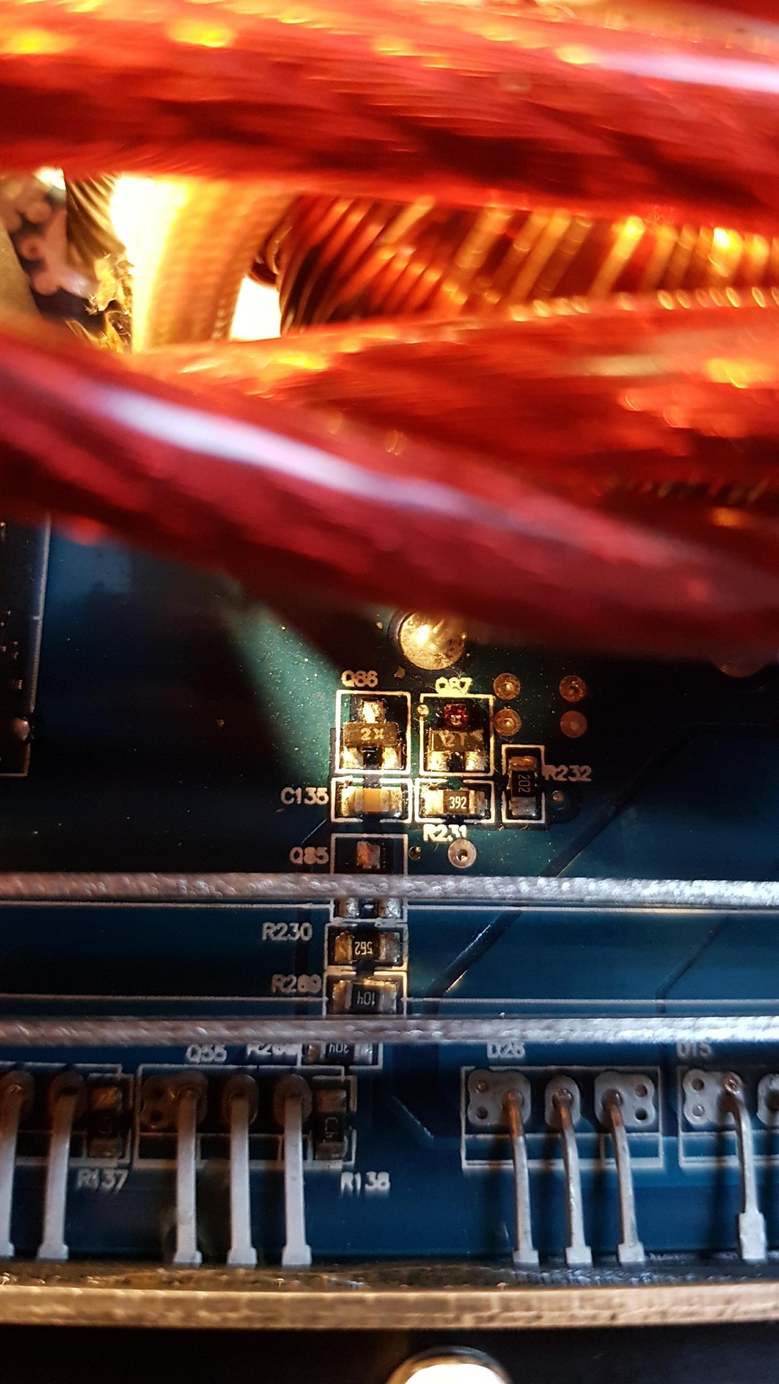

The collector's circuit is driven by other transistors or possibly comparators, In some amps, it's the Q85, 86 and 87 group (off of collector of Q87) but you said that your amp doesn't have those. It may have a similar group.
Perry,
I checked again, while searching for some issues with the SLA1500 wiring scheme. Very hidden under a bunch of wires and steel strips I found the transistor group Q85, Q86 and Q87 🙂
Lifting the collector of Q87 does not make a difference unfortunately

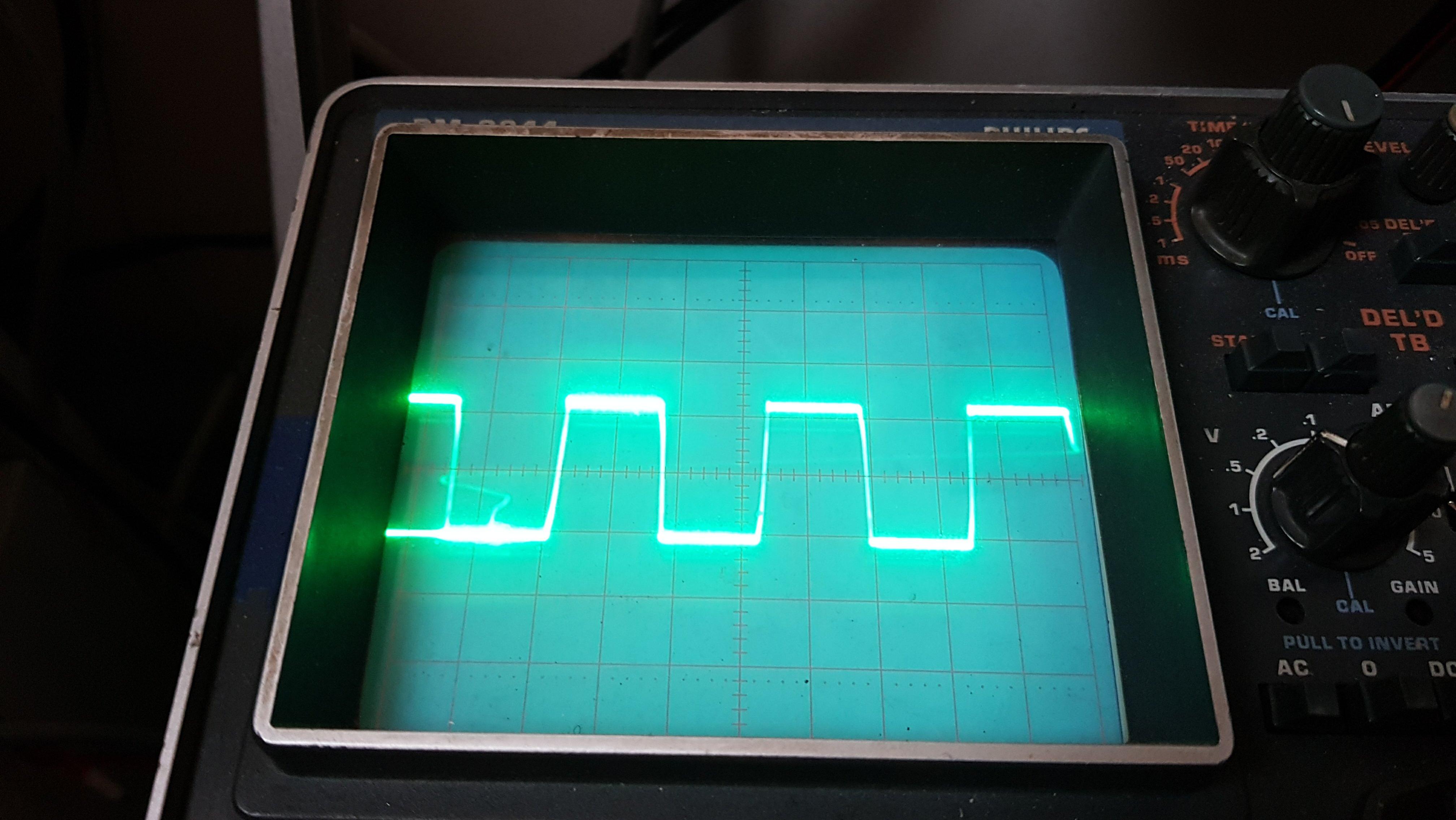

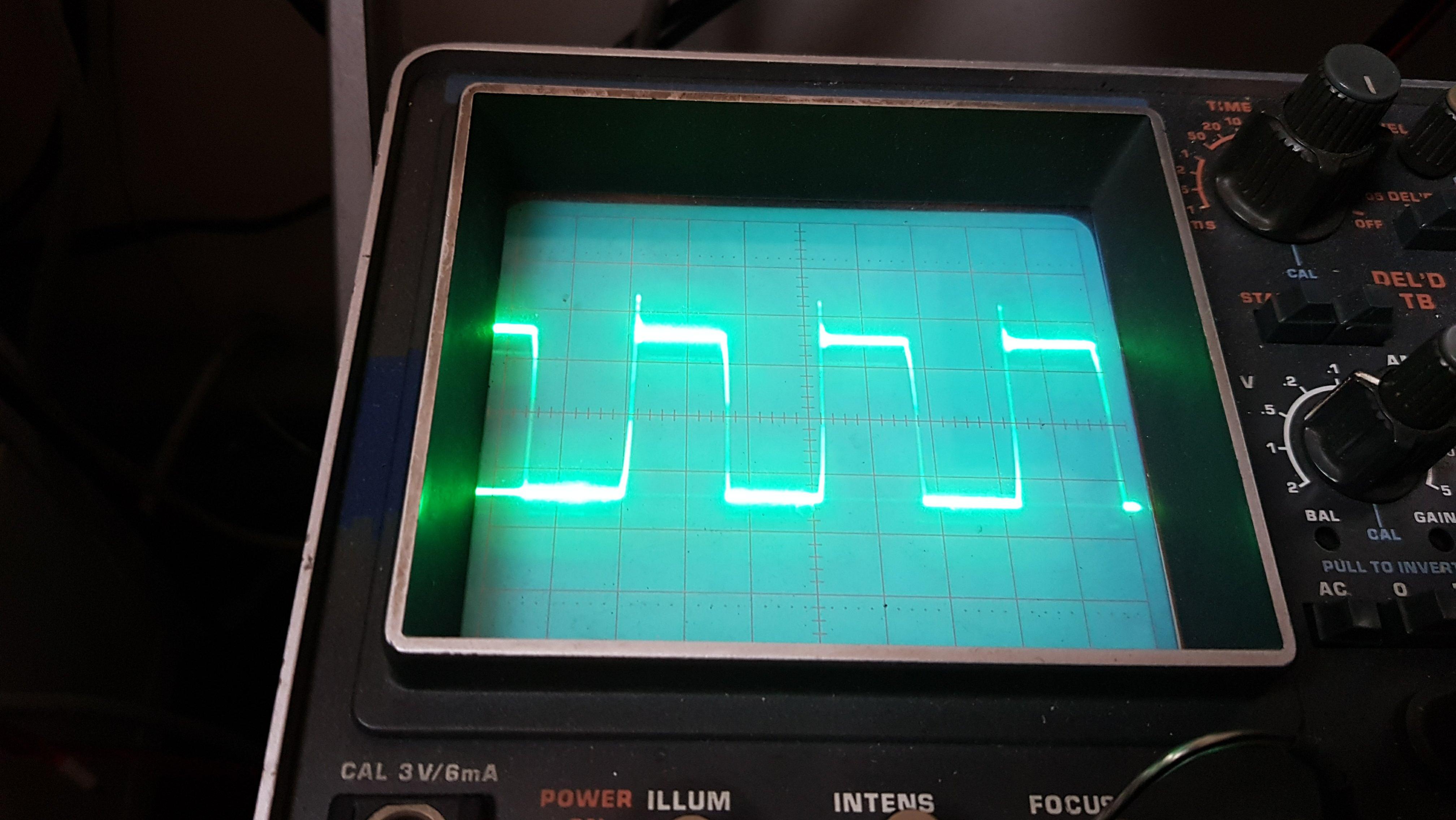

I just noticed, maybe this has something to do with it or could give a possible clue.
The 2 attached photo's are measured from the back of the power supply fets.
Photo with the very clean pwm wave is with a PS voltage of 10.9v
Photo with the peak in the pwm is with a PS voltage of 14.4v
This peak starts to rise around 12.8-13.0v of PS voltage when the amp is normally going into protect.
The transients shouldn't cause a problem.
