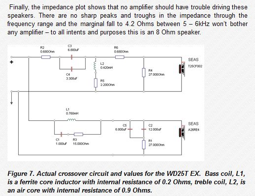

My 2-way has a 0.76mH iron-core series woofer inductor with DCR 0.2R. Might changing to a Jantzen air core with 0.17R

It can't do any harm, can it? Gotta be better than a ferrite.In the end I have gone for some Jantzen Wax-Coils which have a wooden bobbin apparently . I am assured that with such a relatively high crossover point (2kHz) they are a safe bet and are likely to make quite a difference. Hopefully a positive one.
We shall see.
Thanks again.
Ferrites are IMO, the theoretically worst component in crossovers. All that measureable hysteresis.
How much better will your speaker now sound? Usually it won't matter much, because the SEAS woofer is a great big 3.8mH ferrite inductor itself.
But here, the 0.76mH bass coil is part of a resonant circuit notch at 6kHz with the 15R + 1uF tank. Which exaggerates any non-linearities IMO.
It's not going to be huge, but 0.76mH is comfortably within sensible and affordable air coil range, so why not do it?
BTW, this filter does do something to the woofer. It rolls it off more smoothly than running it fullrange. But not a huge change IMO, because the shunt has a high 27R.
Thanks Steve for the bother. I don´t´know what difference the wax and foil make to the cheaper basic wire air core apart from slightly higher DCR but, as you say it´s not going to break the bank, fortunately.

- series woofer inductor. Lower DCR is better ?
