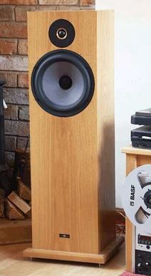

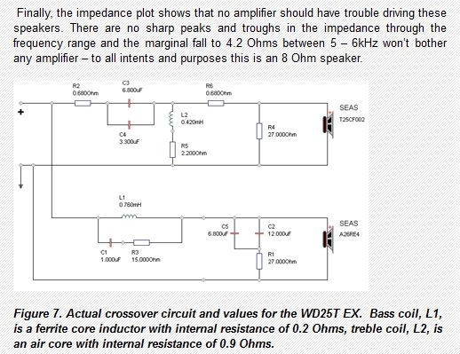

My 2-way has a 0.76mH iron-core series woofer inductor with DCR 0.2R. Might changing to a Jantzen air core with 0.17R be a good move or as a technical friend says "a coil is a coil " ?

IMO, it is worth changing the iron-core to an air-core here, but nothing to do with DCR, which really doesn't matter a scrap here.My 2-way has a 0.76mH iron-core series woofer inductor with DCR 0.2R. Might changing to a Jantzen air core with 0.17R be a good move or as a technical friend says "a coil is a coil " ?

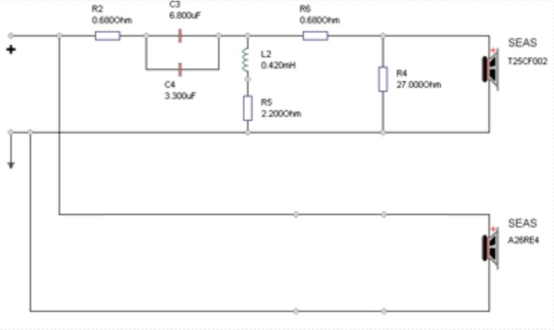

It's because a resonant tank notch is fitted across the coil. This will amplify the iron-core's non-linear limitations.

TBH, it's not a terribly impressive 2kHz crossover speaker, IMO. The bass filter doesn't really do much at all! 😀

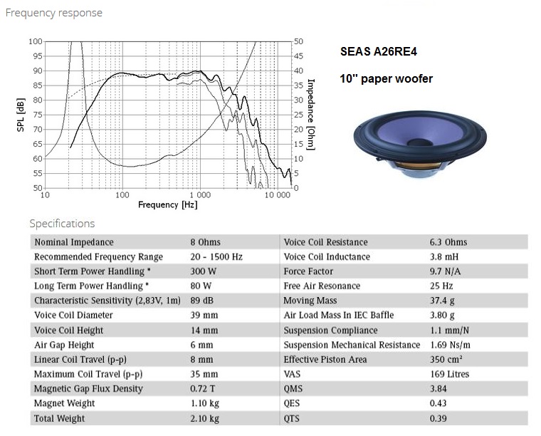

part of the LPF is the woofers Le high value ( but Le is a dynamic variable as a function of displacement so...) for homework someone could put it SPICE
look at the size of that woofer magnet whoa (weak motor? you be the judge.)

As I said, I´ll take pot shot at either the Jantzen air-core (0.76mH/ 0.17R) or the Jantzen C-core Toroidal (0.76mH/ 0.03R) in the New Year some time. The toroidals are supposed to be for very high power and weigh 1/2 kilo so perhaps the air core will win.

If we are talking about the difference between .2 ohm and .17 ohm then it doesn't really matter. But in my system the air core was about 1.5 ohm and the iron core about .4 ohm, and there are two of them. In this case it is a huge difference.

The C-Coils are not air-core, just so you know. Over here we can't get C-Coils in less than 1.5mH value.

In the end I have gone for some Jantzen Wax-Coils which have a wooden bobbin apparently . I am assured that with such a relatively high crossover point (2kHz) they are a safe bet and are likely to make quite a difference. Hopefully a positive one.
