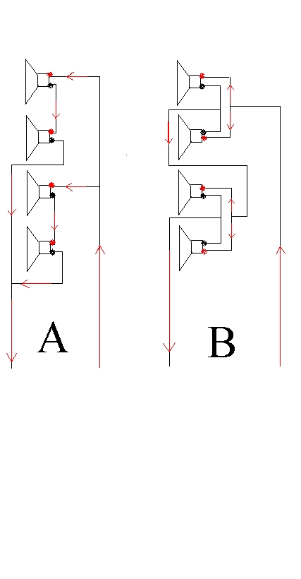

how about this... To get down to the pure question of the topic...
If you have a multiple of four drivers you can either configure series'd parallels, or parallel'd series.
to explain I have taken the time to draw a diagram in microsoft paint.
figure A is a configuration of parallel'd series.
figure B is a configuration of series'd parallel
Which do you think will sound 'better' and why?
personally I think B wins. The reason... inductance plays a major role in a driver's response, especially at high frequencies. With two drivers in series, the inductance doubles thereby causing higher frequencies to be attenuated more. By adding a second set of series drivers in parallel to the first(A) the overall inductance is the same as a single driver or, four drivers configured in pairs of two, paralleled, with the pairs connected in series.
the paralleled pairs connected in series would give half of the inductance per pair and add them back together with the series connection to equal the inductance of a single driver. In this case the inductance at any point does not go above the inductance of a single driver.
Maybe i'm just blowing smoke.

The difference batween A and B is that A lacks an extra wire between the mid connection points of its two driver chains which in B first ties two in parallel.
This extra wire averages two drivers before any are driven in series.
When driven in plain series, as in A, each driver difference can modify its own partner to a greater extent.
The resistors in CLS's drawing are going to help damp any audible impedance change interactions due to individual driver reactances. The bass notes cannot sound the same as when drivers are connected in parallel, though if 'needs must', then resistors across each helps to minimise series induced transduction losses.
Cheers ....... Graham.

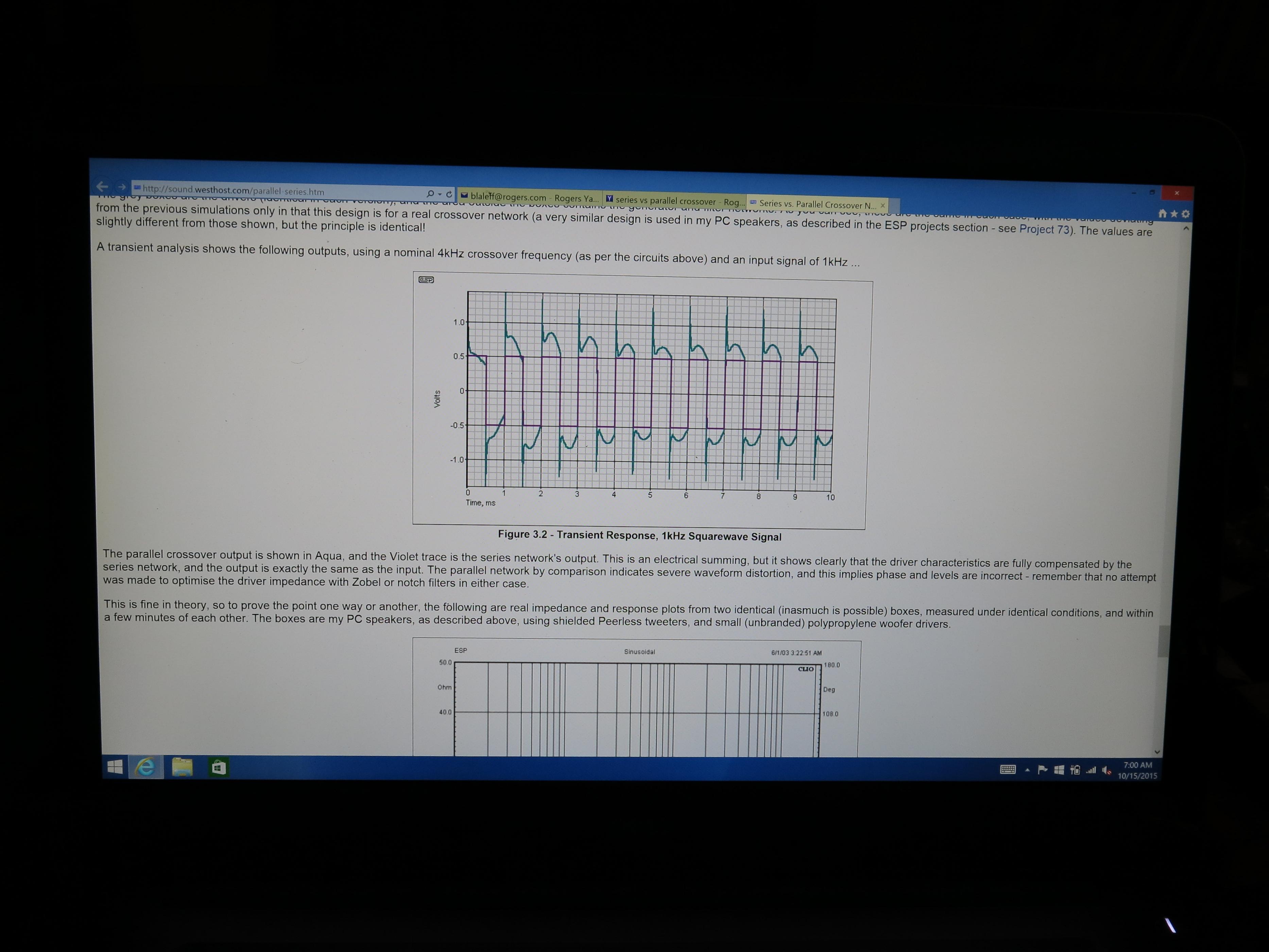

A long time ago, Elliot Sound Production did a series vs parallel article.
Series vs. Parallel Crossover Networks
Great article. Long. A must read. I hope the link works.
Esp input a square wave into each crossover. They plotted the output.
The series crossover output the exact same square wave. If we draw an analogy to music; female voice in, same female voice out.
The parallel crossover output has little bumps. Female voice in, slightly altered female voice out. For some of us, we can hear this little variation. For others, no difference.
Salk Sound builds series crossover speakers. Do a search on what their owners say.
