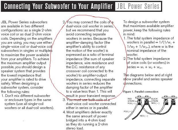

Svante said:.....Since the two driver's electrical impedances and back EMFs are identical, the back EMF of one driver is just right to cancel the back EMF from the other and vice versa..... [/B]
Back EMFs are in phase. (inductors in series)
What JBL says about this....strange...
Well, then JBL is wrong. My explanation with the cancelling EMFs may suffer from bad wording, so I'll give it another try:
As I said I very much prefer the explanation that the impedances are identical, and this ensures that the voltage across each driver is exacly half the driving voltage. Still, let's try to look at each impedance as an electrical impedance Ze and an EMF. When two such identical circuits are connected in series:
V+ ------Ze1-------EMF1-------*------Ze2-------EMF2-------GND
...and the voltage V+ is applied, there will be a voltage drop over each of the Ze:s and the two EMF:s will appear. Now, if there had been no EMF1, the voltage at the midpoint (*) would have deviated from V+/2 (due to the presence of EMF2). My point here is (which I unclearliy called cancellation in my previous post) is that EMF1 assures that the midpoint assumes the voltage V+/2. The fact that we have a mechanism that forces the voltage to V+/2, makes the circuit equivalent to having two separate speakers driven by two separate voltage sources of V+/2.
If I really were to defend my statement that the EMFs cancel, I could redraw the schematic above like this:
V+ ------Ze1-------(+)EMF1(-)-------
GND ------Ze2-------(-)EMF2(+)------*
Then we see that if EMF1 pulls the midpiont voltage upwards, EMF2 would pull it downwards by the same amount. But then, that would just be a poor excuse for my bad explanation. Sorry about that.

Svante said:Well, then JBL is wrong....
Svante,
I tend to agree with you that the JBL must have made a mistake. A simplified explanation of the problem may go more along these lines:
Electrical Speaker Dampening is determined only by current Iemf, which is induced by voltage Vemf. The value of Iemf is determined by the total impedance in the circuit. If we assume that the output impedance of an amp is zero and that the connection cables are ideal, then the only impedance in the circuit is that of the speaker coil Ze. Iemf is then:
Iemf=Vemf/Ze
If two identical speakers are in series, then the total voltage VEMF is 2xVemf because these voltages are in phase. The total impedance is then ZE=2xZe and IEMF is calculated as:
IEMF=VEMF/ZE=2*Vemf/(2*Ze)=Vemf/Ze=Iemf
It follows that each speaker, given the same Vemf, generates the same Iemf. However, as this applies only to ideal cases, and we know speakers cannot be 100% identical, the voltages Vemf generated by the speakers cannot have the same value. Thus, it can be said that the damping factor is a bit lower for serial speaker connections but the serial connection cannot cause the factor to drop below 1, IMO.
Regards
Milan
