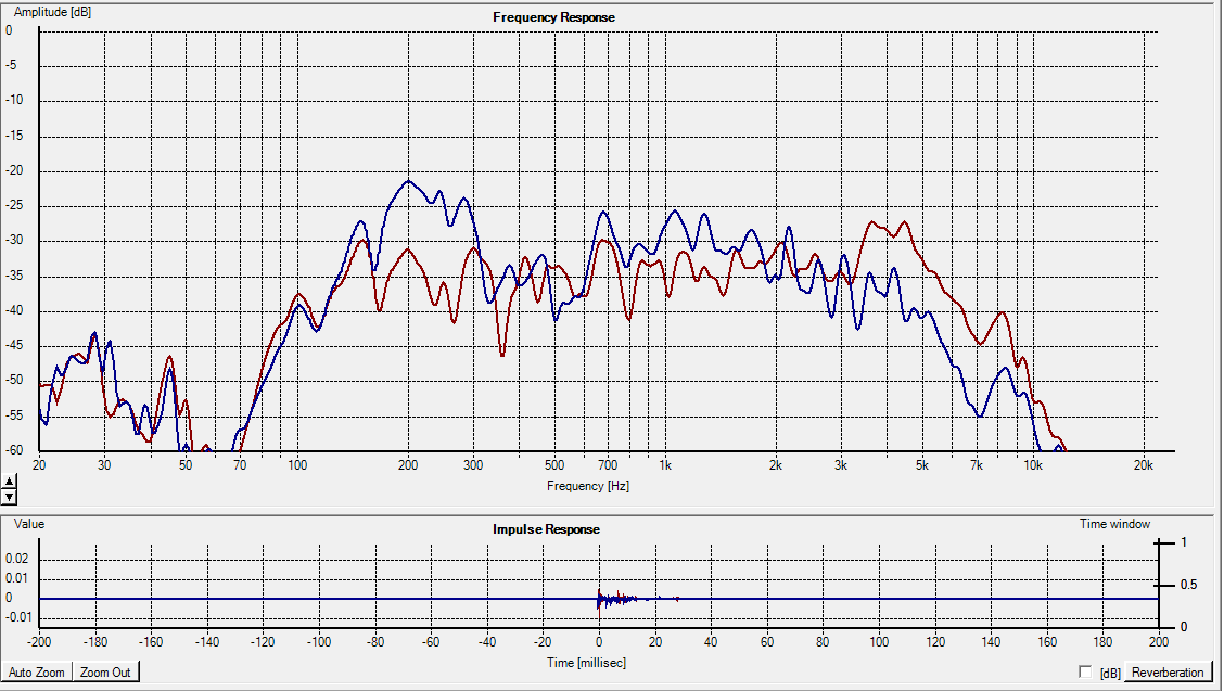

I kludged together a Klam over the weekend, but for only one driver, no K-Tube. ~10 liters sealed rear chamber, 24" total length, with ~11.5" of it the Klam aperture. The driver is rear-mounted a bit like an Altec A7, with cone constriction and 45° side panels leading into the Klam mouth. I briefly tried it with an APT80 on top. The high system Q and bandpass gain make for strong output around 150Hz-300Hz IIRC the measurement I did. Whenever I'm within a few meters of it, it sounds terribly boxy, but that goes away when I back up. I could only get ~20 feet from it in my basement. The high sealed f3 makes for not much bass considering the bandpass gain.
I'm a complete noob, so I don't know much about designing/ measuring speakers, terminologies, etc... But when I was playing with the Klam, I found out that I needed a very small back chamber to have the compression required for the bandpass. And when the driver's qts went up, the chamber had to be even smaller.
I made a makeshift Klam with a 8 inch driver that has a 0.22 ish qts yesterday, and the rear volume had to be quite small. (I attached a plant vase and used golf balls for adjustment. LOL)

My drivers have rather stiff suspension and their actual Qt is more like 0.9 unfortunately. The boxy sound would still be there as it's resonance and reflections from the front chamber surfaces though.
Carl one time said to try a Polk 6" coax in a klam8 - its qts is probably around 0.9 - back chamber on the Patio klam8 is around 0.22 cubic feet not including the speaker - a 30 degree angle version might measure smoother - would be a good thing to mockup and measure
http://img685.imageshack.us/img685/4966/smallklam.jpg
that's pretty respectable response and smoother than what the 40 degree klam8 did with BG20 - if the boost area were occurring somewhat lower then could aid when elevated on a tripod. You could make a 1.5" or so diameter paper passive K-tube and place one end near the dustcap and other end exit near the main aperture - don't know if it would matter much with a midrange. Perhaps drive the K-tube tweeter with whatever cheap can keep up with the Faital.
It's cool that you tried that krazy idea. Looks like the gain BW is about 180 to 300hz. There's also a little gain from 1-2kHz, but it is presumably directivity gain from the internal reflections.

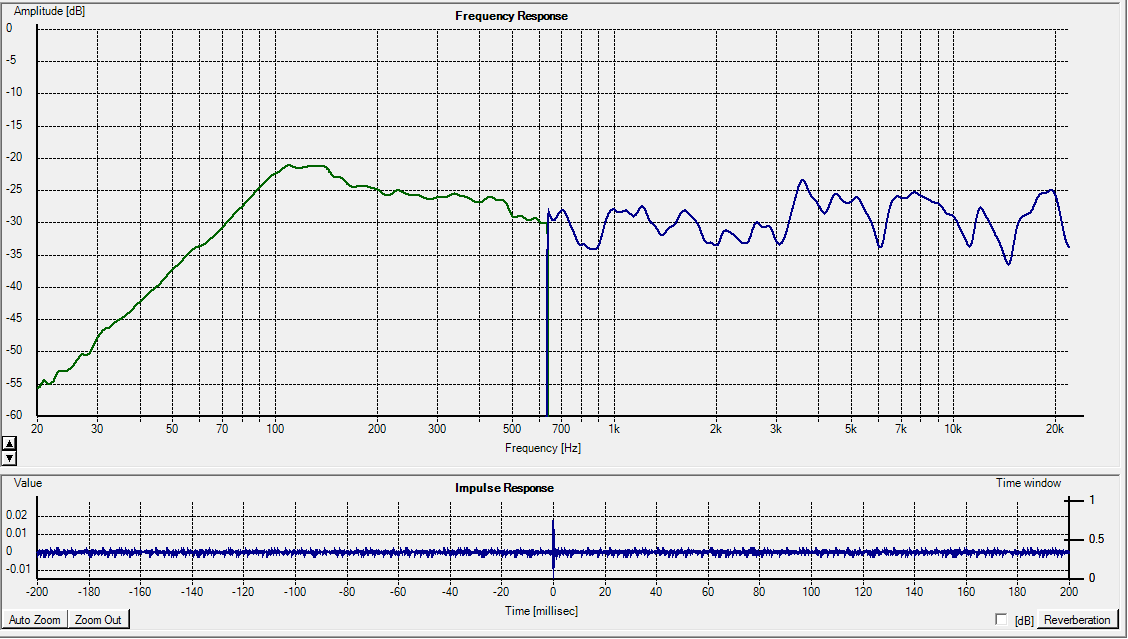

The Klam sounds too boxy within the range I'd be listening to it IMO. For now, I've made a 20L box to house both 6FE100's side-by-side with a single APT80 above them, centered. Quick and dirty Xover with 0.4mH on the paralleled 6FE100's and 1µF on APT80. Should be good enough for the shop and what'll most likely be a majority of talk radio in mono.
Not 100% if I did the near-cone splice correctly, but that's roughly how it sounds. 🙂

and here's an indoor graph of a little klam8 loaded with a BetsyK fullrange driver.
one trace is on the nose axis, the other is "under" the klam and on a perpendicular to the 38 degree slanted aperture pane

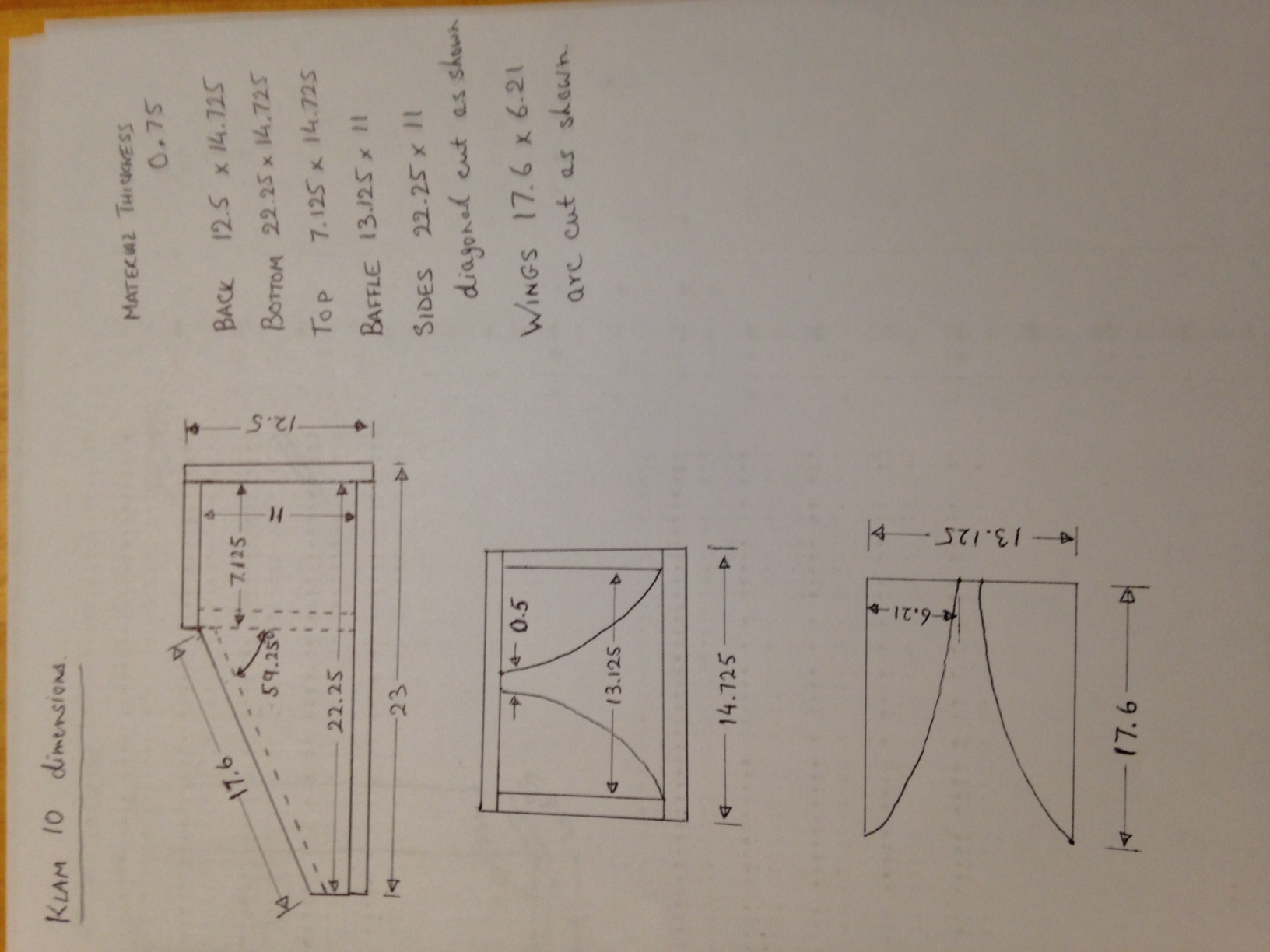

maybe Carl's klam10 scaled down "a bit" would work http://imagizer.imageshack.us/a/img88/6868/notesjpgsn5.jpg
3/4" pink foam board maybe for the shell and baffle - might be stiff enough for the wings (?) - don't go by that radius on the note
- I'll have to calculate it to get it to open up fully - my builder went by that spec and choked off the aperture
C's Klam10 aperture should look like this - his lighting makes the mdf look almost like pink foam board - lol
Ah thanks for the pointer. I found Carl's notes to be a bit confusing - seems to me that the material thickness is not consistently accounted for, creating some discrepancies in dimensions, and some details seem to be omitted.
I tried to reconstruct Carl's plans without the discrepancies, and I'm attaching my document to this post. Perhaps it'll be useful to someone.
Incidentally, the radius of 35.5 mentioned by Carl should work fine, the issue is where you assume the center of the circle to be. Looks like your builder miscalculated the location of the center from which he drew his arc, resulting in that lip. Actually, I wouldn't even bother with drawing a circle, I'd just take a flexible strip and attach it to the two desired endpoints so that it flexes into an arc and then I'd trace the arc.
I see what you're saying on the arc swing reference - my klam10 came in IIRC at 22.5" overall - here's Carl's with the top removed
