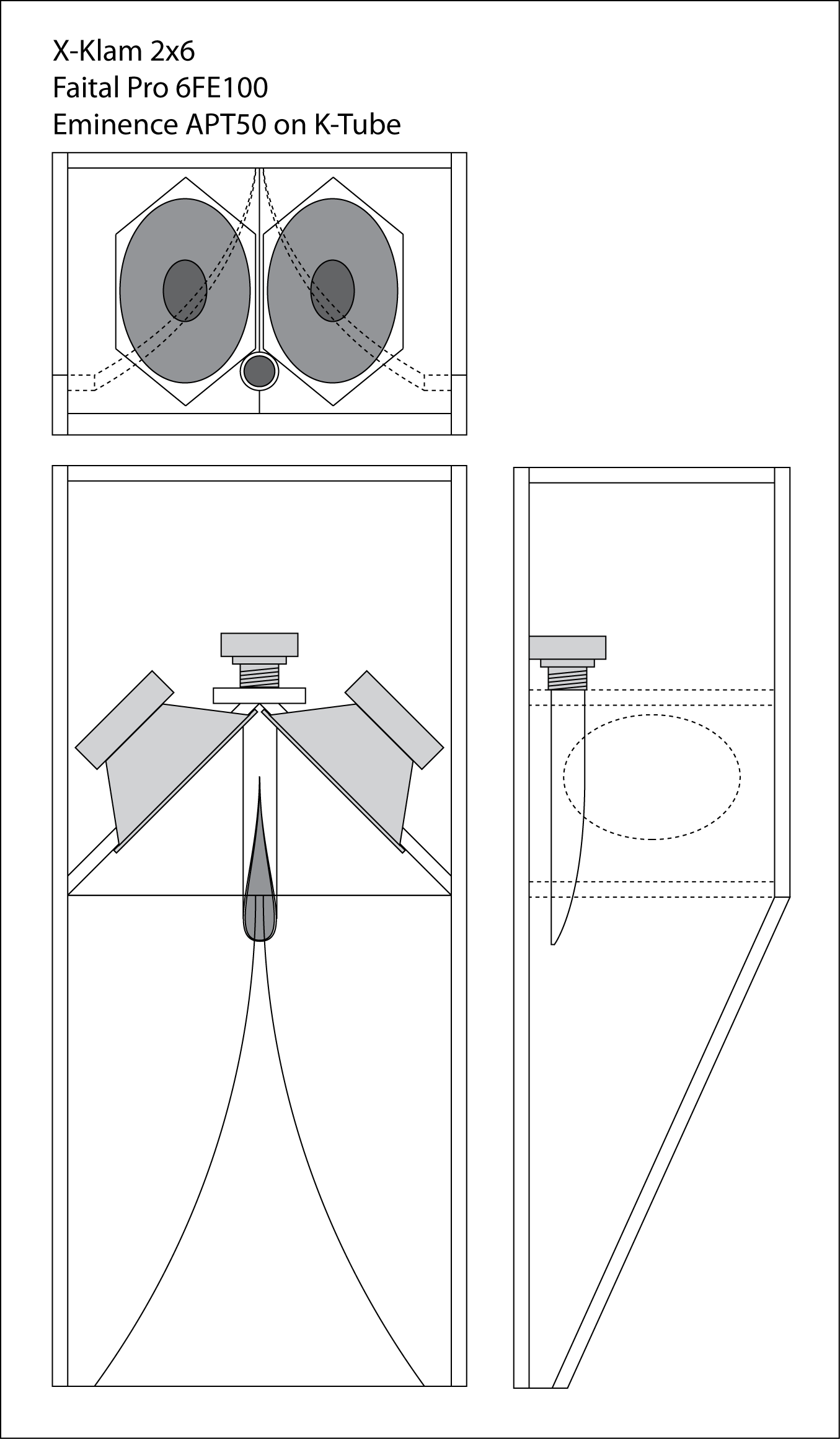

hey IG & walters - what are your thoughts on cavity shape, reflector angle/shape and the effects of rounding/curving junctions of sidewall to baffle in Ultra-Fidelity Ks? Also - your thoughts on making an effective small klam?

as far as shape of the baffle and vent area, shaping the sides like a short conical horn could work very well. someone on the kld forum had done this and posted fr charts. I remember commenting that the shape worked very well. it was for a smaller ultra -fi cab type but might work for klam as well. I had a klam with canted sides that did not work well at all. I started thinking about relationship of exit to aperture back then.
walters - - was that IG81's little cardboard K with canted sidewalls? -everything I have use parallel sidewalls with their pitfalls
the couplers below are all pretty good - IIRC, despite Karlson's warning about directly scaling K15 to a 12", that was also good. (The front shelf might be shortened in such a build)
K18 IIRC, 22.5 x 41.5 x 16" - has bent upper reflector, place for K-tube overall volume pretty much like K15. average frequency response, rear choke shelf but no front shelf - subjectively very good - it should do well with a good low morivng mass 15"
Klam 15 - (have not examined it for system Q - probably could trim off the back chamber by a few inches to advantage
