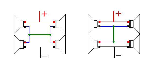

This green line in the middle addition the two sets impedances. You could do this connection for 4 drivers of 8 ohms etc
Please tell me where the error is. I am comparing mine and your image side by side. Please tell me if I made a mistake in describing the connections in each photo.
1. In my image, first and second drivers' terminals are connected positive-positive and negative-negative. Parallel connection. In your image, it's the same.
2. In my image, third and fourth drivers' terminals are connected positive-positive and negative-negative. Parallel connection. In your image, it's the same.
3. In my image, there is a connection from the negative terminal of the second driver to the positive terminal of the third driver. Series connection between the two arrays. In your image, it's the same. Except that in my image it is blue and in your image it is green. But does the color of the interconnect make any difference in the real world connection properties? As much as I know, No.
4. In my image, two wires are crossing over, however, are not joined in the cross-over point. In your image, no wire is crossing over. But again, does this mean anything in the real world connection properties? I think No.
So, I ask you to carefully look at my image again and tell me where the mistake resides.

Hi Shaan
I vote for the one on the left (repeated in your post #9).
In theory both schematics give identical results but in real life the drivers will not be identical.
The main issue is if you take two drivers with different resonant frequencies and connect them in series, there will be a small frequency range where the cones tend to move out of phase with each other - high driver excursion without matching output. This is a accompanied by a big peak in impedance.
Connecting the 2 in parallel forces them to work together in a more coordinated fashion and gives much better damped impedance hump.
I'd prefer a series connection of 2 well damped parallel-connected pairs to a parallel connection of two badly-behaved series-connected pairs.
Hope all of the above makes some sense - I'm up to my eyeballs in painkillers right now (and they're not f***ing working either 😕😡) - so struggling to be coherent.
Cheers - Godfrey
p.s. half agree with richie00boy about safety, but I'm assuming you're not planning to blow them one at a time anyway.

Maybe we can agree on this wiring diagram - redrawn with no wires crossing over?

I ask excuses, the both images are the same electrically, the connection is the same. Was my fault, sorry.

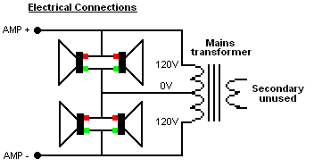

If you can live with a transformer, it can be all good.🙂
Nothing fancy - just an ordinary, cheap mains transformer.
Linearity should be really good. Since they're designed for 240V @ 50Hz, you won't be getting them anywhere near saturation.
If the DC resistance is too low, you could add a small resistor to each end of the primary, but probably not needed, especially if the amplifier is transformer or capacitor coupled at the output.
Actually, if the amp does have a capacitor-coupled output, transformers in the speakers could help with switch-on thump too.

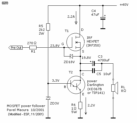

I'm using a 20watt MOSFET power follower driven by DoZ preamp as my amp. It's class-a and needs no transformer at the output. 😎

Nope, no neglect. The transformer's purpose is only to help ensure the input voltage is divided equally between the top and bottom halves at low frequencies.
At high frequencies, where the leakage inductance becomes significant, that will effectively remove the transformer from the circuit, which is fine - it's only there to help with low-frequency symmetry.
Losses should be minimal, and will only present a slight extra load in parallel with the drivers.
It doesn't add anything in series with the speakers, so there's no effect on damping, frequency response etc.

MOSFET follower DC coupled to the speaker?
I was thinking output transformer for a valve amp and maybe a capacitor for SE SS.

Just adding little more info, It's Cap coupled SE class-a. 😀
Preamp
Follower
Follower
