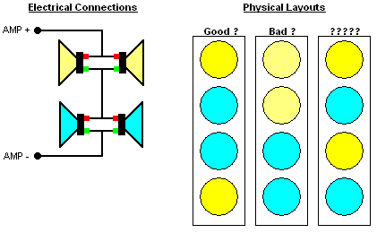

Whichever is easier mechanically. They are electronically equivalent. So the one that's easier to connect the wires is the better one. With any meter from outside the box they will measure the same. The only small difference is that in the left-hand drawing the green wire carries no current (almost).
I see. Thanks for the information!
