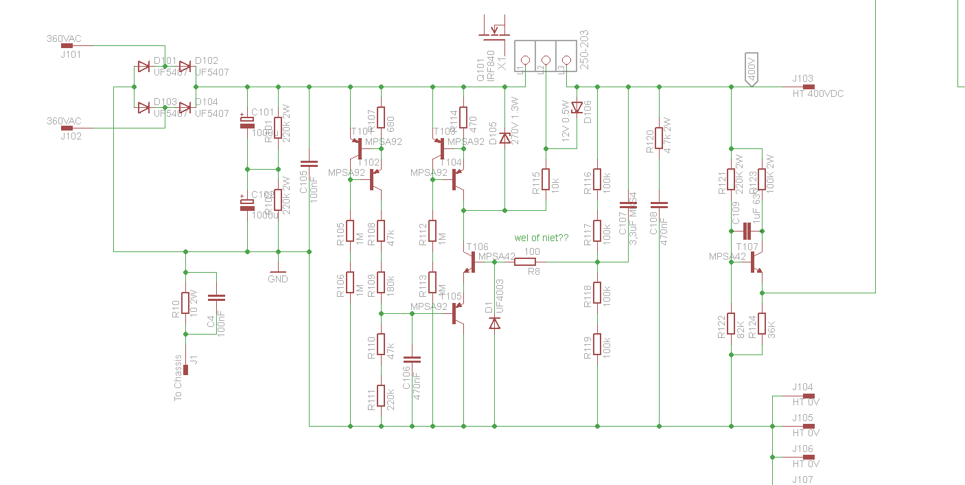

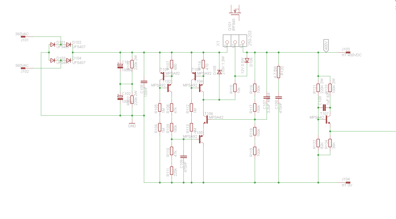

Series MOSFET regulator 400V, what the hell
Well, maybe not so much.
If the Vbe of T101 is operating in the flat slope then the effect of supply voltage on the CCS operating point will be very small.
OK, not as bad as I had originally thought.
I still would not do it that way though.
LOL
Yes...on paper I prefer it.
But I have not tried it yet.
Time will tell.
Actually, if you would have used the output to source the CCS I would probably have accepted it.

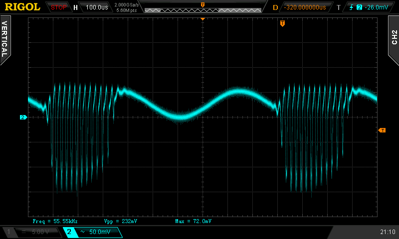

How is the step response for 10% to 90% of load? (and 90% to 10% of load)
I use this as a stability indicator.
