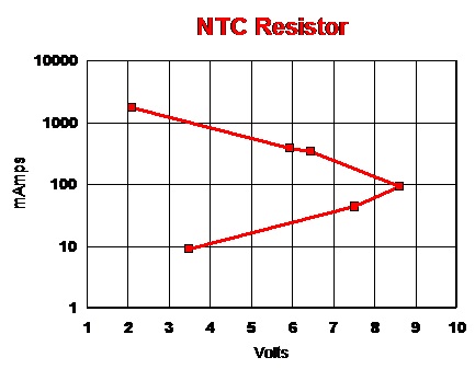

NTC Plot Example
Measured data using a constant current generator in 4 terminal mode.
Applied I Measured E Calculated R
9.23 mA 3.48 Volts 377 Ohms
34.7 7.52 217
91.8 8.61 94
345 6.44 18.7
390 5.95 15.26
1.73 Amps 3.65 2.11
This NTC was made for the TV Buz. Connects between the power
plug & the power source. Made by Nutronics in Sarasota, FL.
About 40 years old. Because of thermal inertia the measurement
settling times are long, up to 10 minutes.

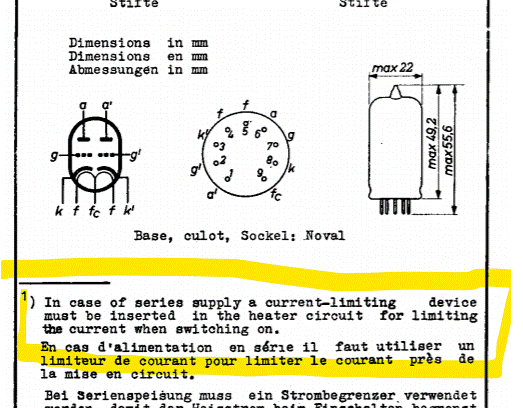

Again, the ECC81 82 & 83 are designed for series string, have been from their first delivery.
This is what it says in the Philips data sheet for ECC81, and what prompted my query in the first place.
If you are concerned a series resistor and a timed relay could be used. TheThis is what it says in the Philips data sheet for ECC81, and what prompted my query in the first place.
relay shorts out the resistor after a few seconds. A more complicated but better solution is to rectify the AC, add an DC stab circuit configured for a current limiter of 350 - 500mA.
In your case it might be unnecessary as the transformer used has some series resistance. The tubes you have seem to have been working for several 10's of years, chances are that new tubes will last equally long.
That said, if you have hum problems, new tubes might fix that.

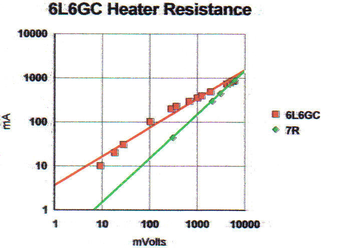

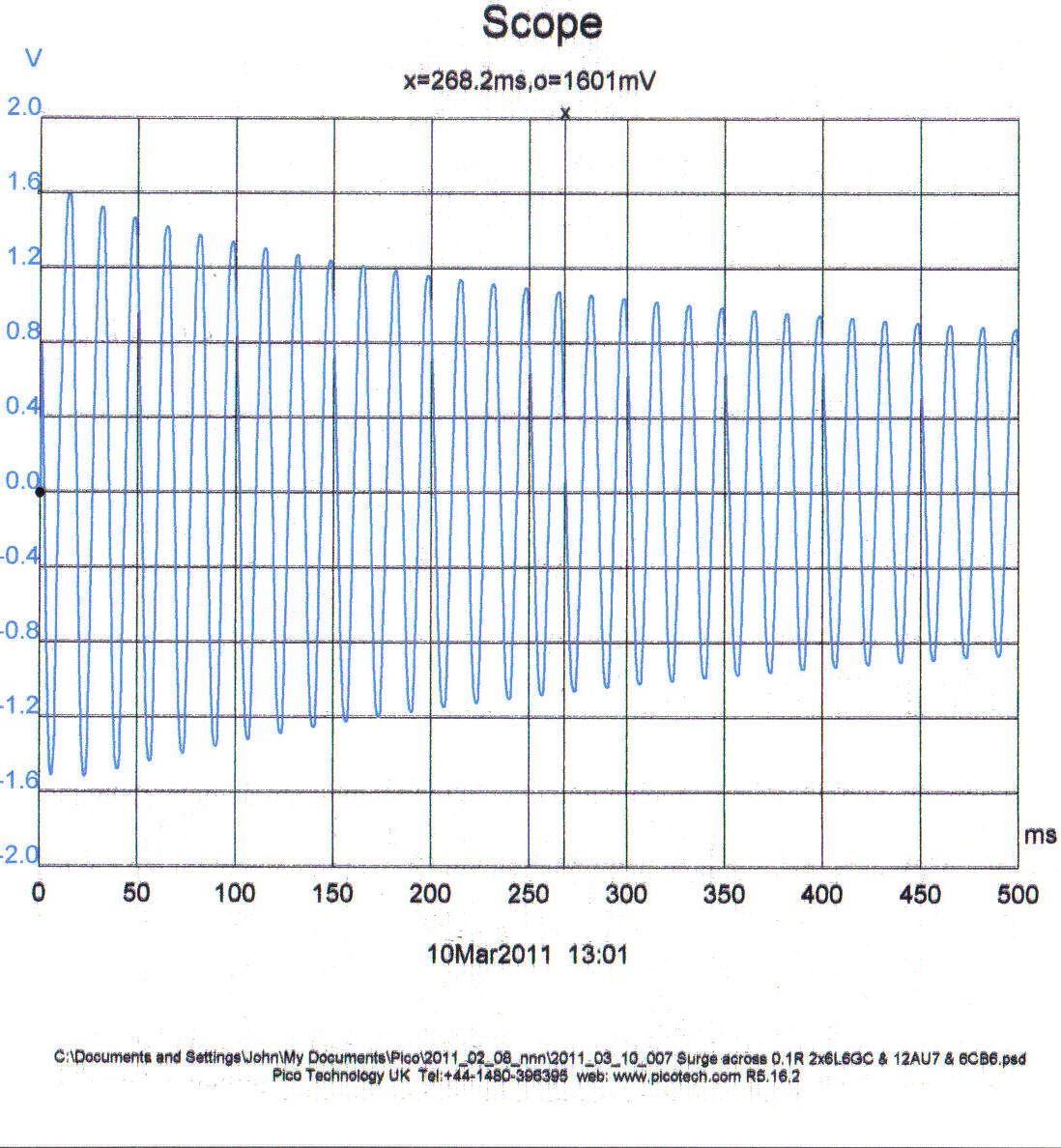

This thread reminds of the Ancient Greek Philosophers, much talk & little action to prove their thoughts are valid. So here are two data sets actually measured several years ago. The cold resistance of a 6L6GC is about one ninth the operating resistance. Other tubes about the same but the thermal time constants are different.
The other plot is the surge across 0.1R on supply of amp with 2x6L6GC, 12AU7, 6AU6 & GZ34. The heater currents are limited by the PS transformer, in the case a Hammond.
