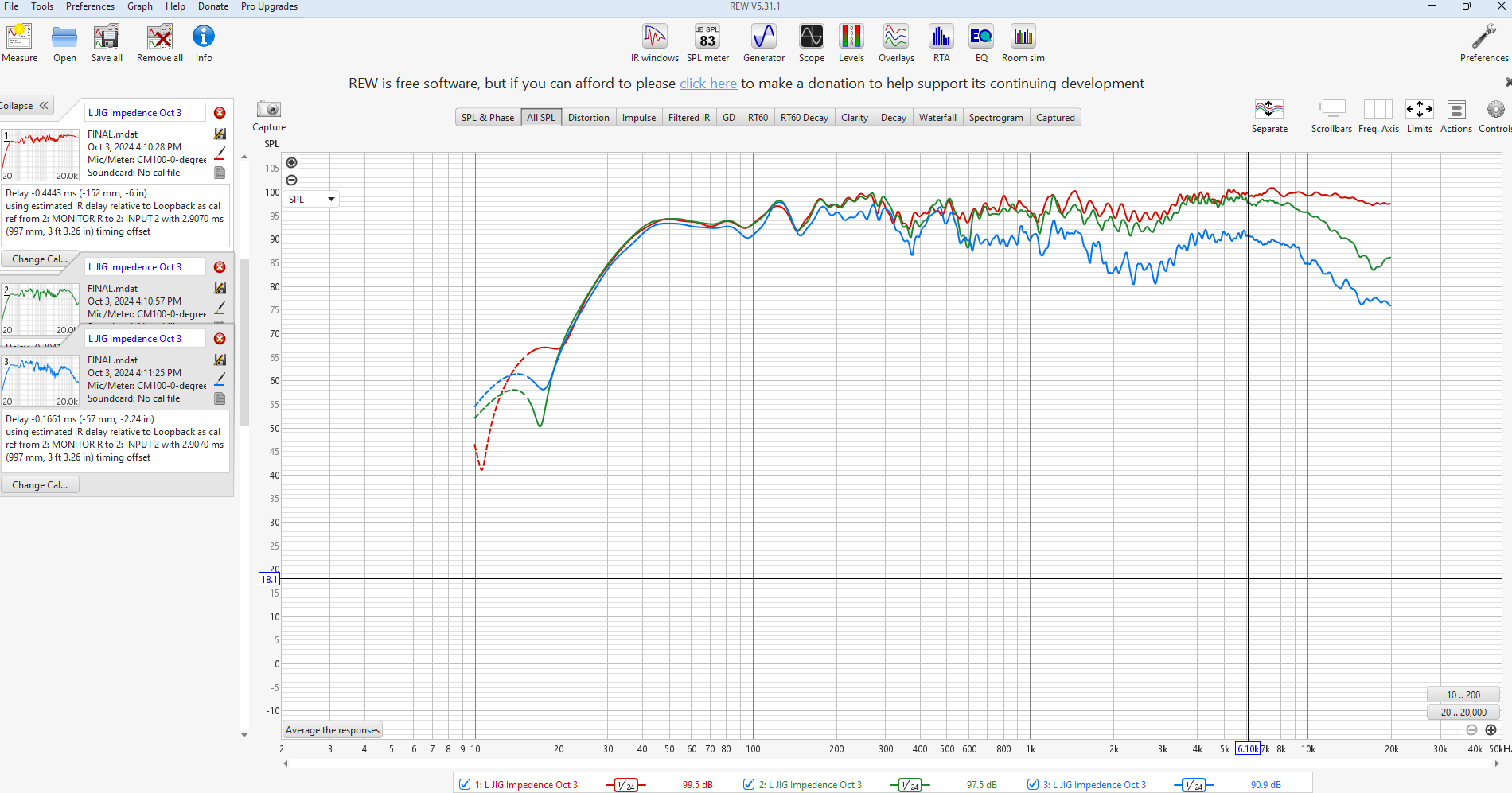

Turns out the vituixcad one was spot on. The off axis is intense. That blue is 90 degrees off axis. This is gated at 80 ms so those ripples are reflections. In an anachoic chamber it would be pretty much flat

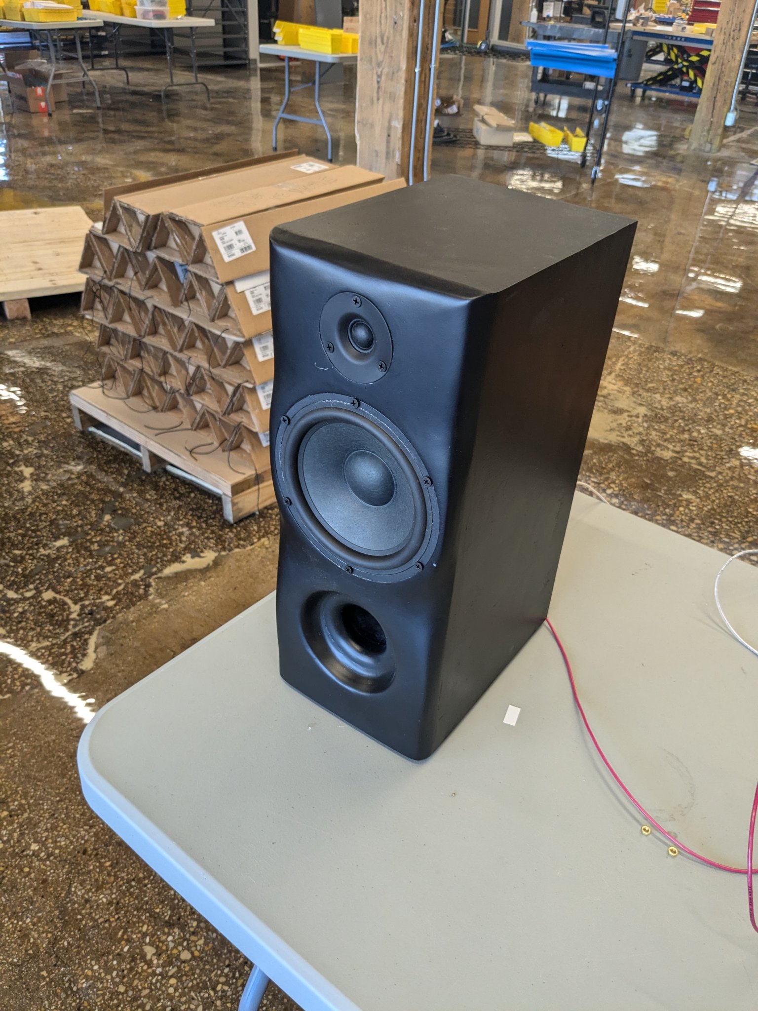

They sound very clear. Maybe more clear than my higher end 3 way. It doesn't have that musicality of the low end but that is to be expected. The bass is unexpectedly intense.
We listened to it for about an hour yesterday at the shop. One of my techs said he thinks the builds are beyond his ability to hear now because he thinks it sounds jsut as good as the big 3 way. That was music to my ears because that's what this was supposed to be. It was supposed to be something that your average person would think was as good as it gets while costing very little to make.
