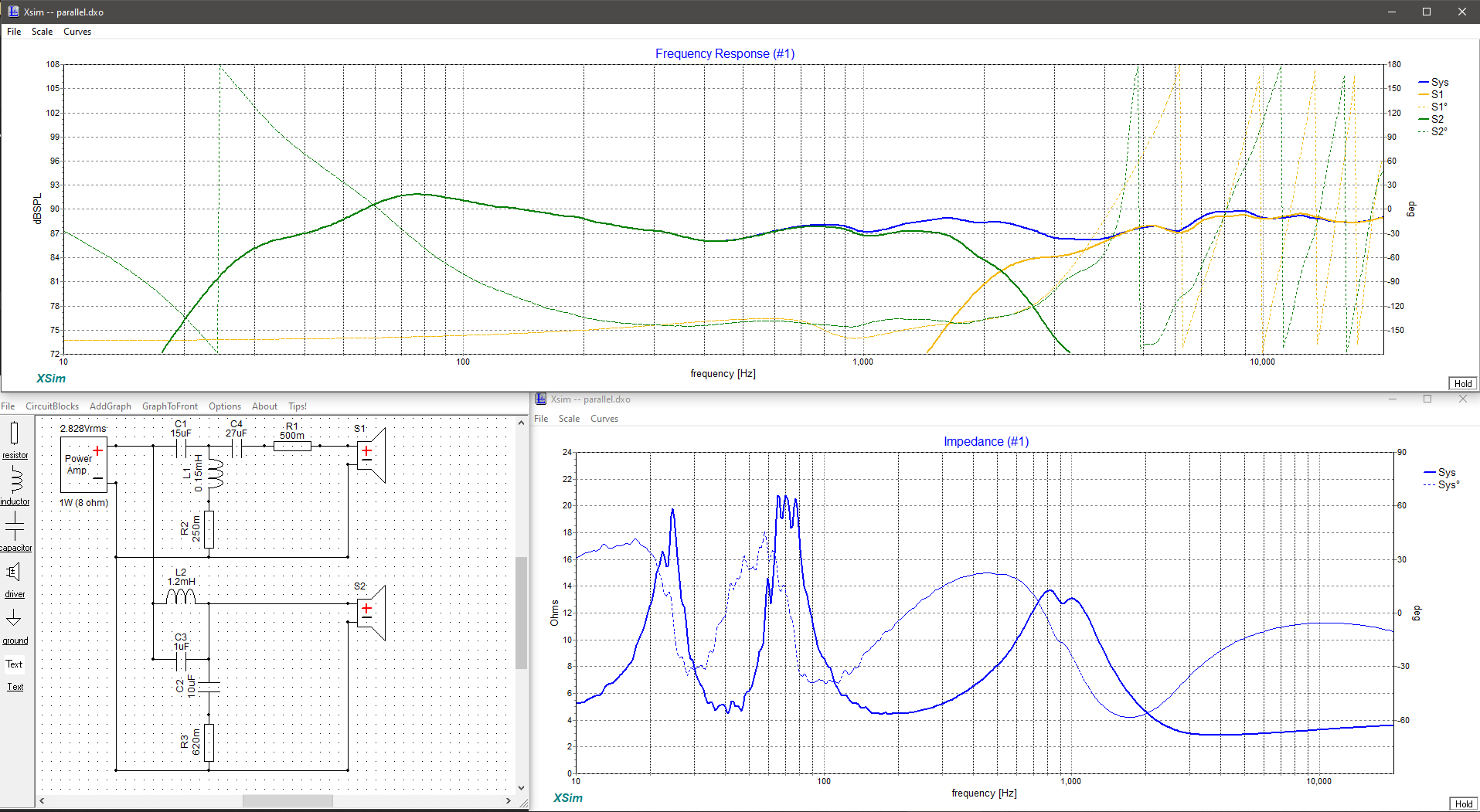

You have a few options to try now, the third order should stop the tweeter from getting distressed. At the same time it gets the woofer out of the picture quickly.

I had to wait for my breakfast this mornnig and went a bit further in messing with this, and i made a better one. If the measurments were done right this is a full phase cohesive assymetric parallel (3th order for tweeter, 2nd for woofer with eq for the resonance peak).
You can't do this with a serial. Serial crossovers shine on low ordrer with well behaving drivers, but for this you need more complex crossovers, where parallel shine.
I ordered some XO parts to try out the series.You have a few options to try now, the third order should stop the tweeter from getting distressed. At the same time it gets the woofer out of the picture quickly.

Where does anyone get the idea that a series crossover is going to have a higher impedance than a parallel crossover?

Because if you wire two speakers in series you double the impendence. In parallel you halve the impendence. Go ahead, try it
But you bypass both of those speakers with a coil and a cap so to "short" the respective driver out for a certain frequency band.Because if you wire two speakers in series you double the impendence

Series xovers do not ADD impedances, and parallel xovers do not PARALLEL impedances. They remain their respective nominal impedance in their passbands unless you've done something wrong or not watched your filters' results. Normal use raises impedance in the stop-band for parallel topologies, and shorts out the other in a series topology to where the out of band driver is no longer in play enough to have much affect.
Series xovers are not required to have lower order xovers and well behaved drivers. This is a myth. I've used 4th order electrical SXO filters to achieve 6th order acoustic rolloffs. And yes- you CAN use notches in SXOs, contrary to public myth.

I will say that after 2 weeks of screwing with various paralel and series XOs that, in my two week experience, it is MUCH easier to end up with a higher impendence with a series XO.Series xovers do not ADD impedances, and parallel xovers do not PARALLEL impedances. They remain their respective nominal impedance in their passbands unless you've done something wrong or not watched your filters' results. Normal use raises impedance in the stop-band for parallel topologies, and shorts out the other in a series topology to where the out of band driver is no longer in play enough to have much affect.
This was made especially hard for me since the 4 ohm tweeter measured a measly 2.8 Re. Running a series meant I could get it high enough to use a regular amplifier. With a parallel you can get it higher but you might sacrifice a significant amount of wattage to resistors.
Most tweeters have to be padded to match the rest of the drivers. This is normal and expected due to sensitivity differences. If you are trying not to use resistors at all on tweeters you aren't doing it right.
Unless the tweeter matches the reasonably high sensitivity woofer as in your build, this shouldn't make a difference, however, BSC should have eaten 6dB of the sensitivity of your woofers and made the sensitivity match still require resistors.
