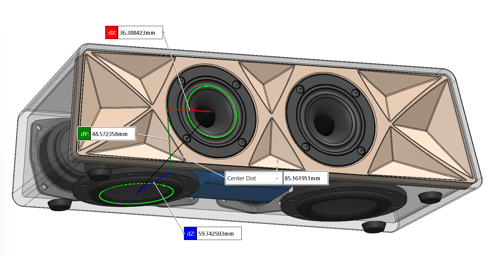

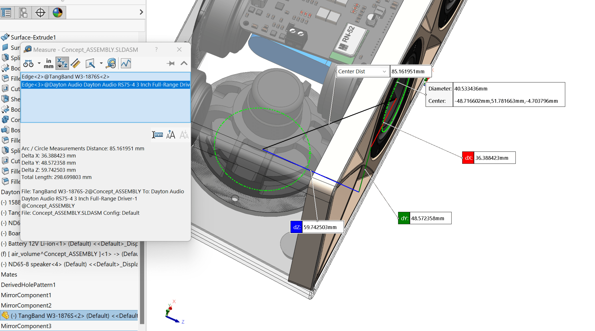

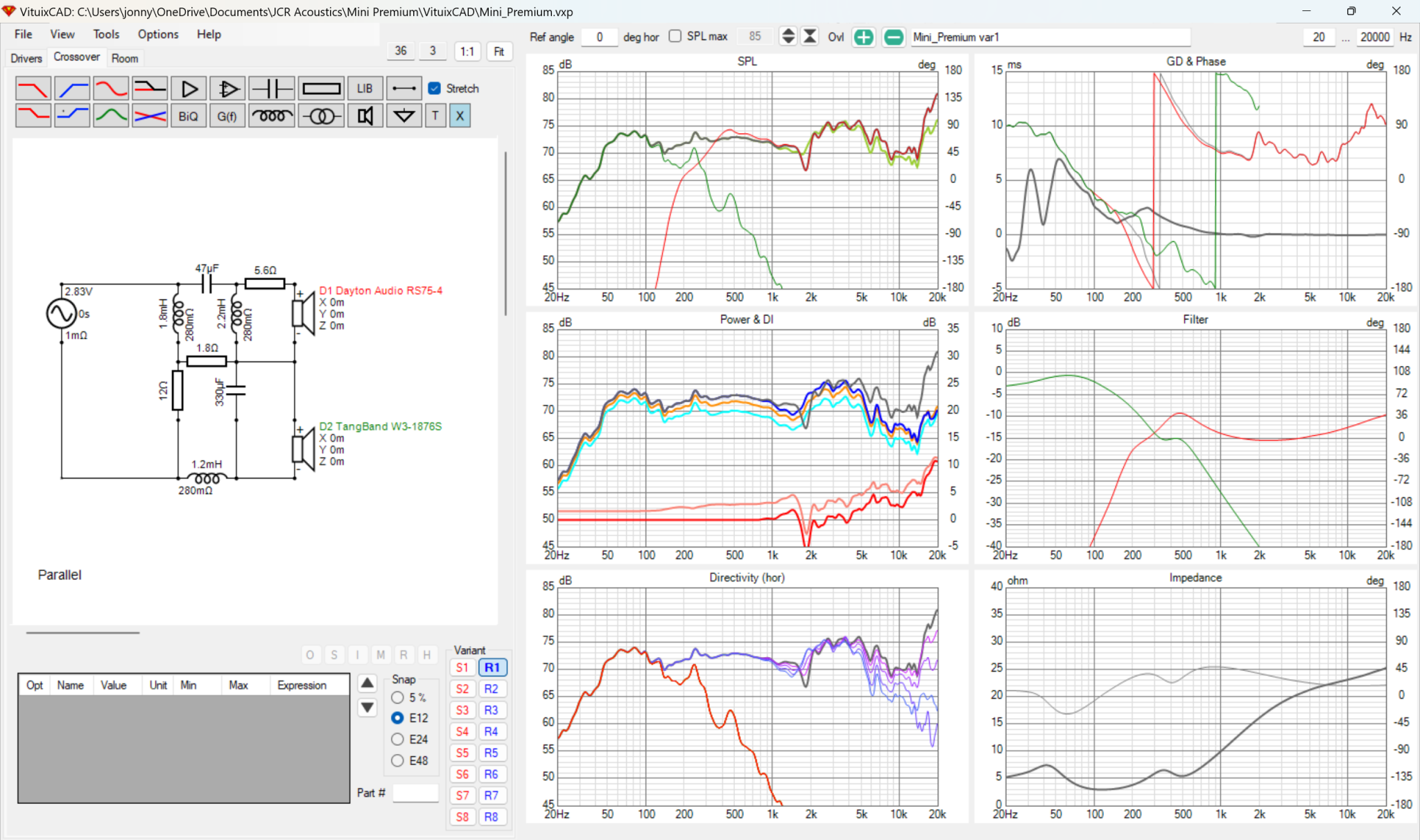

A couple of things here.The positions aren't completely finalized but also not an easy answer I'm afraid with the TBs down firing and the full range drivers facing forward. I suppose the fact that it's being crossed over so low the orientation and alignment shouldn't be such an issue? I thought this was only really a problem at higher frequencies due to the shorter wavelengths?
View attachment 1362097View attachment 1362096
1. Wolf is absolutely right that they should not occupy the same air space in the enclosure.
2. With them facing 90 degrees off axis you will run into some issues. I can simulate this though if you tell me how back one is from the other and how over. So I would need x axis offset, y axis offset, and z axis offset. To simulate it properly you would need a 90 degree off axis measurement of that W3 driver
3. With it downfiring you'll want to cross it way lower. Around 120 Hz. Any high you deal with too much reflections and the off axis will screw with your FR.
4. Wolf is also right that you will need some pretty hefty inductors if you want to cross very lower. DSP is another animal entirely and also doesn't come cheap so that's a choice you will have to make
What was your intended XO frequency?
Great, I shared the dimensions in a previous reply with the screenshots. I was going to crossover about 600Hz but may need to be lower with them down firing as you say. I wouldn't cross over any lower than 300/400 I think or the full range end up doing most the work and would end up needing a larger internal volume which would take away from the TB's space. I get there's some tradeoffs but that's to be expected for something so small trying to pack so much.With them facing 90 degrees off axis you will run into some issues. I can simulate this though if you tell me how back one is from the other and how over. So I would need x axis offset, y axis offset, and z axis offset. To simulate it properly you would need a 90 degree off axis measurement of that W3 driver

I like the response you got with your crossover. Were you able to model the effect of the offset axis? I think I'll give your crossover a try so long as I can be comfortable knowing they won't be out of phase to a noticeable degree.I managed to flatten out that nasty hump of the full ranger. You'd be better off running a small tweeter and crossing over to that. It would sound a lot better.
JCR,

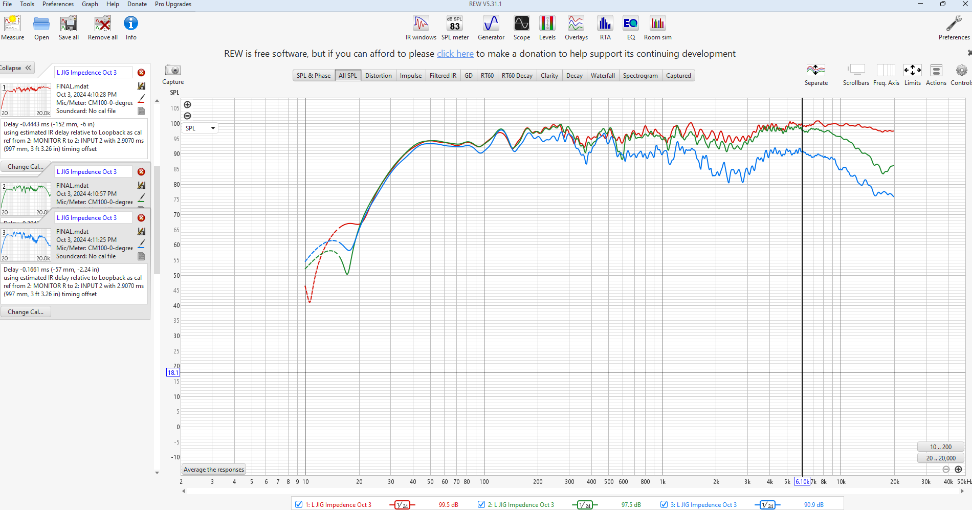

I did run it assuming a 90 degree off axis response. It didn't really change anything because the XO frequency is so low that the off axis doesn't change too much there.
With most lower range drivers the off axis doesn't change too much low down. Here is just one example. See how much it changes at the high end hut how little it changes at the low end?
You can run that series XO I showed you. That one should knock out that huge high frequency notch from the full rannge drivers. If you don't knock that down somehow they will sound very harsh.
Couldn't see an attached image here if there was one. Thanks for the info though. I figured should be okay low end but I was planning on crossing over a lil higher than 250Hz so I can keep the full range driver enclosure size as small as possible (bearing in mind the Qtc values).With most lower range drivers the off axis doesn't change too much low down. Here is just one example. See how much it changes at the high end hut how little it changes at the low end?
What equations did you use to calculate your component values as I'd be interested in having a stab at raising the crossover to around 500Hz but keeping that HF notch smoothed out?

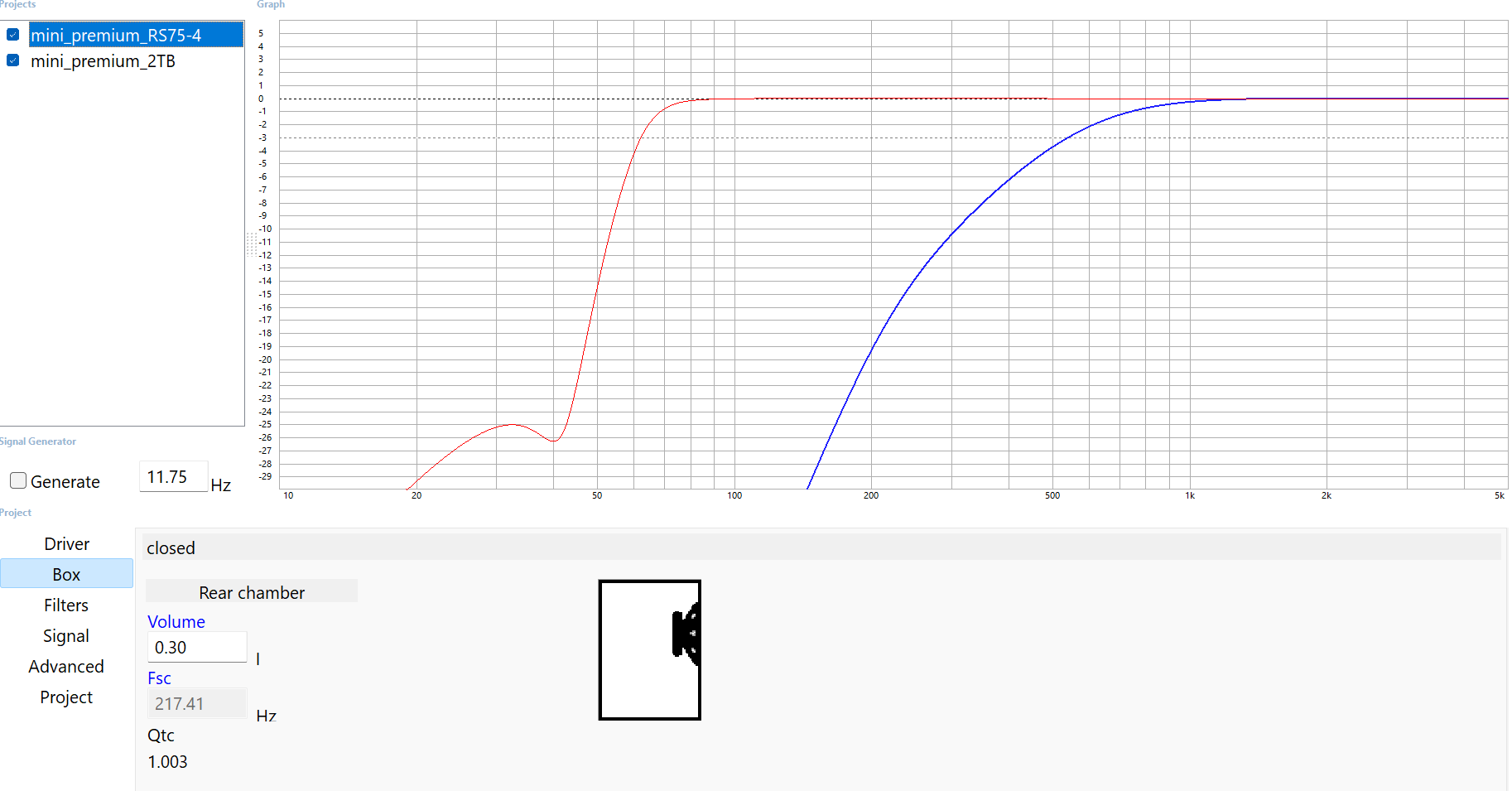

I mapped the drivers out in WinISD allowing for 0.3L for the Dayton Audio RS75-4 with the crossover at 550Hz:
Qtc is higher than ideal for RS75-4 but I'm going to have to compromise somewhere trying to keep this thing so small. This already involves making it larger as I have 1.7L for the TangBands plus the two 0.3L enclosures surrounding the full range drivers so a total of 2.5L by the time PCBs and the like are in there.

As you can see, the off axis doesn't start to take effect until around 800 Hz. If you're using a first order XO then you need to worry about it leaking over the higher end. With traces none of this matters a ton. You are just getting within the ballpark.

I was using VituixCAD but didn't know it could determine values for you? Perhaps I'm using an older version as I note your screenshots say REW V5. Looks like I need to do some more research. Do you tell it the crossover frequency you want and it determines the values? This is what my window looks like:let VituixCAD do the heavy lifting as far as choosing component values. You'd be doing yourself a favor to start using that simulator for you XOs. It's pretty much dead on. Made by someone much smarter than I. I will attach the FR from the last two way I made. The one I used a series XO on.
In the XO view on the bar by the components is a tab called LIB. Click that tab. That will get you your basic parallel components.
With a series though, you're on your own.
You get a feel for it after some practice. Always keep an eye on the filters graph. This shows you what you are bucking/boosting.
REW is a different program. REW is what we use to take the measurements of the drivers. This is our real world measurement. Using REW you can take the measurements of the drivers you have in your actual box and then use those measurements to make the XOI was using VituixCAD but didn't know it could determine values for you? Perhaps I'm using an older version as I note your screenshots say REW V5. Looks like I need to do some more research. Do you tell it the crossover frequency you want and it determines the values? This is what my window looks like:

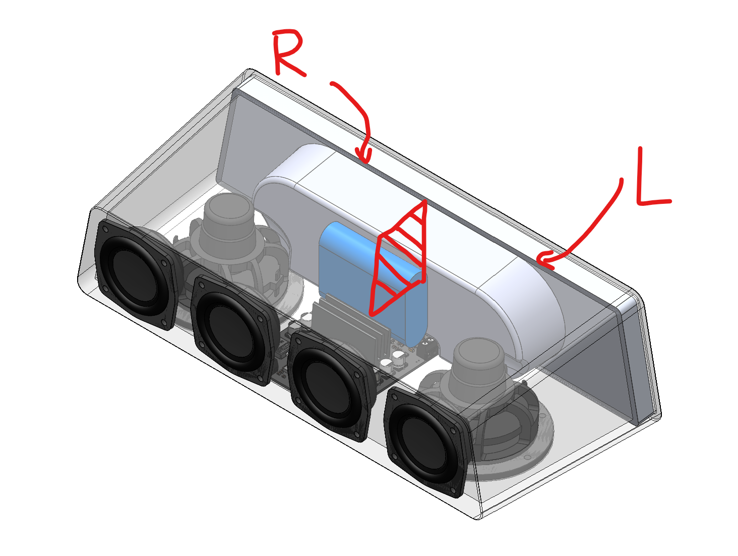

Hi, just to go back to this: If I have an enclosure for the full range drivers is it better if there is a division/divider (shown in red) so that the left and right channels aren't sharing the same volume of air? Since it's frequencies above 550Hz I wonder if it matters so much? Any divider will subtract from the overall volume of air even if only slightly. I will also add dampening material in here to artificially reduce Qtc.A PVC cab is the most economical small volume chamber, likely a 3" diameter. 3D printing might be smaller.

For the application, I'd say no. For critical listening, you can get crosstalk that way.
Separate them. It is best practice.Hi, just to go back to this: If I have an enclosure for the full range drivers is it better if there is a division/divider (shown in red) so that the left and right channels aren't sharing the same volume of air? Since it's frequencies above 550Hz I wonder if it matters so much? Any divider will subtract from the overall volume of air even if only slightly. I will also add dampening material in here to artificially reduce Qtc.
Also, don't leave just a flat plate behind them. That is the worst for reflections. You're 3d printing it right? So put all sorts of wierd shape elements on that plate on the inside that faces the driver backing to break up the sounds waves. Sort of like how they those diffraction/dispersion walls. KEF has actually started doing this. You should be able to find an article about it and copy the design
Okay call I'll put a thin 2-3mm wall in the centre of that part but I wonder if this raises the Qtc more than if they shared the enclosure even though it's a small overall volume difference when divided per driver.Also, don't leave just a flat plate behind them. That is the worst for reflections. You're 3d printing it right? So put all sorts of wierd shape elements on that plate on the inside that faces the driver backing to break up the sounds waves. Sort of like how they those diffraction/dispersion walls. KEF has actually started doing this. You should be able to find an article about it and copy the design
Would this be necessary if I intend to fill the space with wool? Wouldn't this also break up the sound waves? Don't mind texturing the inside as you propose though, would be fun and add a bit more rigidity to the part too. I'm guessing you mean something along these lines:
Yeh I figure cross talk isn't such an issue when the speaker is only 340mm wide as L/R will hardly be separated. I did move the drivers slightly further apart as you suggested though.For the application, I'd say no. For critical listening, you can get crosstalk that way.
JCR, the divider is going to remove minimal space. It won't even matter.
Sound waves pass through the stuffing. That is the point. If they didn't, it would just reflect off of the stuffing. The idea is you want the waves to NOT hit the back of the cone. So once they pass through the stuffing they bounce back at an angle, diagonally through the stuffing (therefore increasing the thickness of the stuffing as it has to pass through it at an angle), and they don't hit directly at the cone. Hopefully they hit another couple walls and go through more stuffing before finding their way to the cone. By that point they have such littler energy that it doesn't matte. This is best case scenario. It all works together
