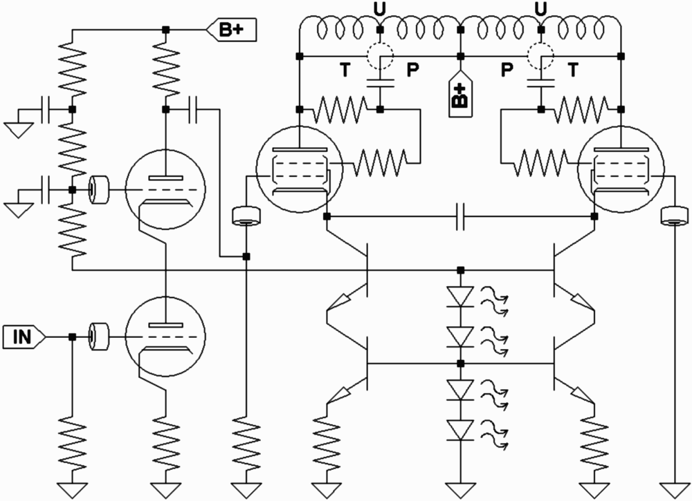

I like the idea of a cascode using a MOSFET below a triode-strapped
pentode. Or a triode, doesn't really matter but pentodes are cheap.
Something like a DN2540/EL86 would be a good match for a 2A3.
Michael
Michael
I don't see the point, except to look cool doing it?
What would be the purpose but to dissipate heat?
The MOSFET component would entirely control the
anti-sound (a pure slave to the reference triode).
Tube cascode above this does absolutely nothing
to or for the sound.
Plenty of sandy devices with high Gm needing no
cascode assistance in power or voltage depts.
Lean toward certain IGBTs as having the lowest
gate and reverse transfer capacitance to drive.
If I put any kind of tube on the Anti-side, it would
be to purposely engineer a custom blended curve.
There are good reasons to think that might be a
worthwhile experiment.
But not just to dissipate heat and voltage...
Waste of a good tube.

Reasons to use a tube vs. MOSFET
Lower capacitance. 7pF vs 50-150pF. Makes a difference in the
slew rate and slewing current. 250 uA for the tube, 2mA for the
50pF MOSFET at 20KHz and 565V Pk-Pk.
Tubes cool themselves through convection.
Easier to dissipate 15 watts at 100C vs trying to keep a
MOSFET case temperature below 50-60C for SOA and
reliability. No big heatsink required, just a little air flow.
Surge voltage tolerance. MOSFETs have very little tolerance for
anything and no sense of humor.
Reliability. MOSFETS have no sense of humor. Especially at high
voltage.

Lower capacitance to what? Its a cascode fer cripesake!
Grid totally bypassed to one rail or the other... You seem
happy to abuse a MOSFET underneath, where that gate
could potentially choose to be driven by a music signal.
(One of the easiest ways to wag the Triode into A2...)
If you find no humor in the odor of 600V MOSFRIED, you
may need to upgrade your technology. IGBTs withstand
1200V + before the magic blue smoke leaks out.
Again, gratuitous waste of good tubage, throwing one
at a power waster circuit where it exhibits no influence.
Even a rectifier tube does more to justify its existance.

I am by no means able to speak about the merits of mosfets X tubes as the anti-triode element, but I see some use for the GU50's (russian pentode, 40W dissipation that I bought at about 2 euros the piece) instead of the EL/PL519 in the septor.
Erik
Erik
I thought about adding a few more LEDs and biasing such that A2
was possible (mostly for the triode), but I'd have had to add one
more transistor to assure any grid currents returned to the plate.
And then I thought about cathode volt cost. Perhaps not worth A2
in a wag the dog topology. Not unless output tubes were already
pushed to the maximum plate or screen voltage they could safely
withstand, and you couldn't live another day without that one or
two extra watts.... The amp that cranks to 13.

kenpeter said:Lower capacitance to what? Its a cascode fer cripesake!
The Coss of the top MOSFET in AT cascode is in parallel with the
OPT primary (AT side only). It can be balanced by adding a cap
to the triode side, it can be neutralized, or it can be reduced by
using a vacuum tube instead of the MOSFET. By my estimates,
the Coss of a MOSFET is significant in this circuit.
Some low voltage MOSFETs have low Coss but by the time
you get to the 800-900V devices that tend to be more
reliable, the Coss is up > 50 pF. What's the capacitance of
an IGBT?
How do you mean it exhibits no influence? It doesn't color the sound
but maybe that's a good thing if the MOSFET Coss is an issue. How
is the anti-triode a power waster circuit?
The heater power for an EL86 is less than 5 watts, less than
another 2A3.
GU50? would be good with a super 300B like the JJ, that also
handles 40 watts. With this combo you could push over 25 watts
in class A1.
Michael

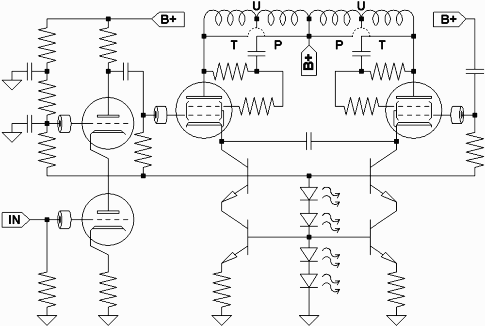

IXGH 6N170A
http://ixdev.ixys.com/DataSheet/98989.pdf
23pF @ 1MHz Coes for the 1700V 75W part.
TO 247, fully insulated, with no screw hole.
Mind you, any error that tries to leak on account
of Coes will be fought tooth and nail by the Gm,
which is only a measly 3.5 Siemens! Comparable
to 3,500,000 uMhos in hollow terms.
Only the collector end will see the capacitive effect,
as-if to ground (or whatever other gate reference
the emitter end might be rigidly following).
2 buck 36 cent at Digikey 5 minutes ago...
But you'd have to order a minimum of 150, as
they haven't yet stocked up on this new part.
The quantity thing seems to be the deal killer.
Yet 600 Volters already cheap and plentiful.
And 1200V IGBTs are gettin there fast too.
If you ever look at the "Triode Region" of an
IGBT, it looks very-very triodish. More so than
any FET. But the Mu is near zero, so its kinda
useless except as a variable "plate resistor"
in SE Diode style of emulator.

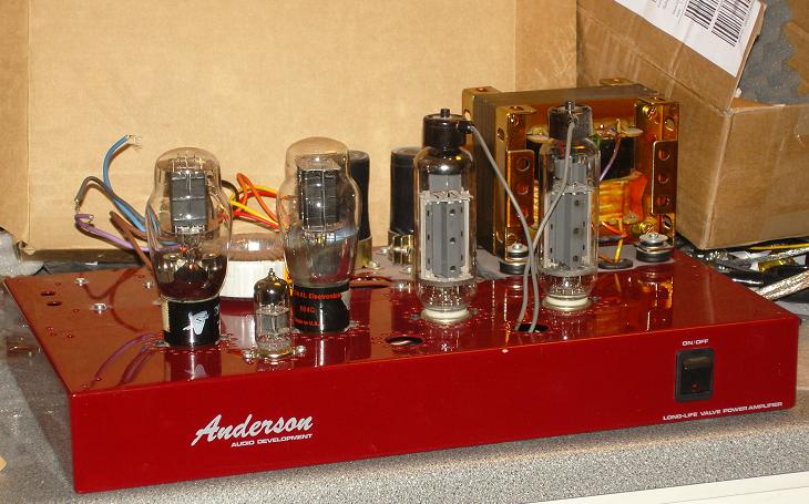

The sand discussion seems to be time-consuming, build and try IRL instead! Tubes are easiser to deal with. Can not afford heatsinks anyway😉.
I will try with cascoded EL519s anyway. Compared 1*EL519 pentode vs. 2*EL519 cascode in a few sims. Figures are very much alike except that second harmonic is diminished in the cascode case.
Have also tried a few double current-sources and they do not seem to be to critical but I go for a double C4S-style. Will absolutely not go for 317s or MOSFET.
A small heatsink to carry the CCSs will be placed over the novalsocket hole in the middle. The "OPT" will be placed inside the chassi.
