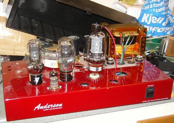

The sand discussion seems to be time-consuming, build and try IRL instead! Tubes are easiser to deal with. Can not afford heatsinks anyway😉.
I will try with cascoded EL519s anyway. Compared 1*EL519 pentode vs. 2*EL519 cascode in a few sims. Figures are very much alike except that second harmonic is diminished in the cascode case.
Have also tried a few double current-sources and they do not seem to be to critical but I go for a double C4S-style. Will absolutely not go for 317s or MOSFET.
A small heatsink to carry the CCSs will be placed over the novalsocket hole in the middle. The "OPT" will be placed inside the chassi.
