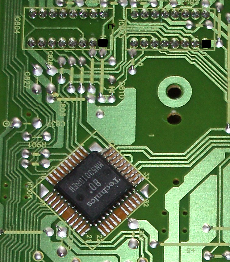

The PCM61-L are doublecrowns ?
Only individual data lines.
Decoder also MN&something.
Don't want to remove the board again...
I suppose the 40-pin chip could do correct 2's comp inversion but there is another possibility. If you can, look at the position of the data relative to LRCLK for each of the two dacs on a 'scope. And what is the frequency of LRCLK?
Wadia ?
Pin 5 clock 2,8MHz
Pin 6 LE 176 kHz
Should I trigger from clock and put data on 2nd channel ?
Why does it say 18bit on the player's front if chips are 16 bit only ?
Bernhard said:
Pin 5 clock 2,8MHz
Pin 6 LE 176 kHz
Some simple maths: 176kHz is 4 times 44.1kHz: player has 4 times oversampling. 16*176000=2.8Mhz: 16 bits in one frame to the DAC: 16 bit dacs at 4 times oversampling.
It's 18 bit resolution created with 16 bit 4 times oversampling.
Like philips using the 14 bit TDA1540 in CD players stating 16 bit resolution.
If you really wanna know what it is, you need to read the number and look for other chips downstream (filter,decoder). If it is not a custom chip, somebody might know what it is.
